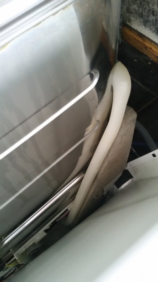

Really need a photo of the side with panel removed to see the arrangenent.

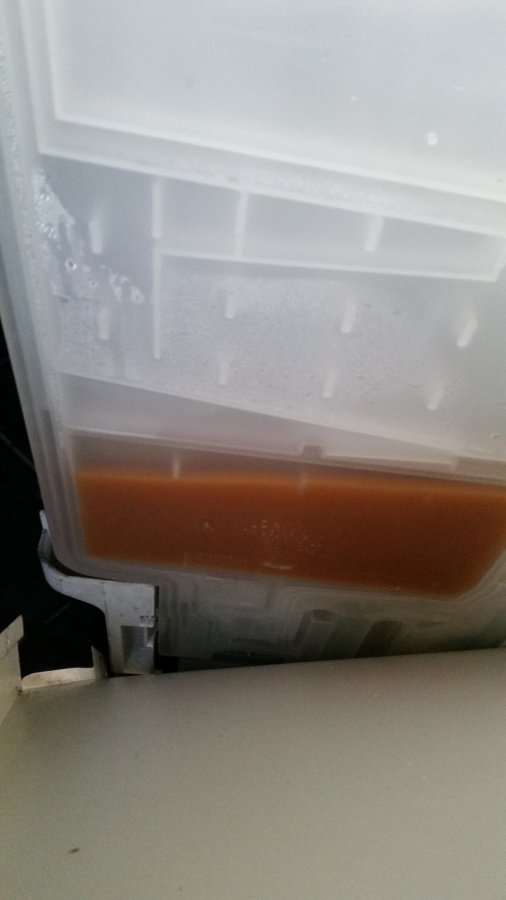

Hi fender, poured water in and it's pumped out fine, took side panel off, well mostly off, it's moulded to the base in one corner, all I see is the water pipe that feeds into the washer, switched it on and can't see water travelling up the pipe, all other workings are accessible from underneath only it seems?
ok, but that side looks like a blank canvass to my untrained eye lol
il take a couple more, as i say, the sides seem moulded to the front "plinth" of machine,
