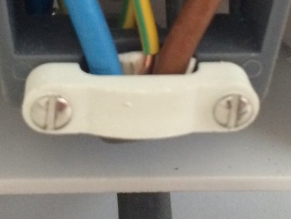

Zanussi hob very hot after testing!
...have I wired this correctly?
It does appear to be correctly wired.
Only comment i would make is
The black sheath of the cable should be clamped by the cable clamp
