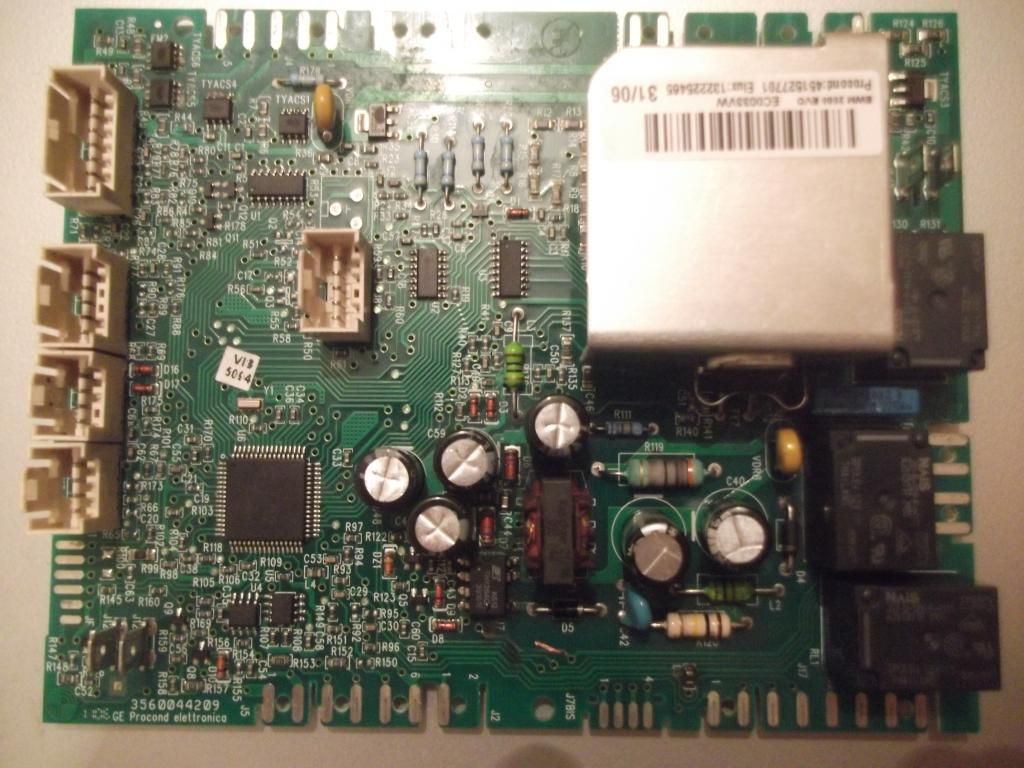

Not really sure what else is on that part of the cct from photo but yes, replace caps, test smd resistors too and diodes but depending on how they are connected in the cct can give spurious results.
Well, I have an update, if I was a doctor it would be a case of the operation was a success, but the patient died.
I replaced the resistor, caps and had already tested the nearby diodes
I have some more photos

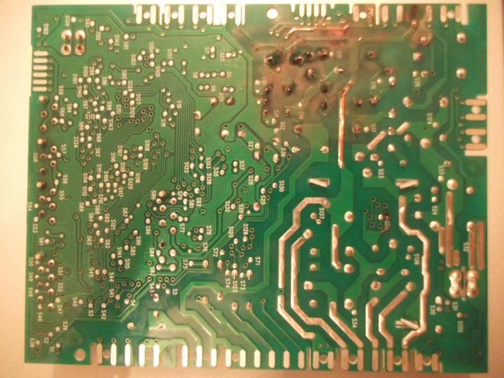

First, the board with the resistor and caps removed, so you can see the carbon deposits
Then, the board after cleaning, showing some erosion of the board
I put the new components in, having made sure that each of the connection points had continuity to the right part of the board.
The machine was reassembled, powered on, and the machine was alive, with all the buttons and the display working correctly.
I then decided to run a final test by running through a wash program. the door locked, there was the sound of the discharge pump making sure the drum was empty and then after about 2 seconds a bright blue flash and bang. :cry:
The underside of the PCB is now fried but there's no real sign of damage to the top of the board.

Is the board a simple single layer board? Tracks on bottom, components on top.
Or a multi-layer board? 2 or more track layers
Have to ask but do you think you could have re-connected the cable connectors wrong? Wrong way around or misaligned.
I can see the new caps were fitted correctly, polarity.
The resistor you replaced looks somewhat burnt out, odd. Test and see what reading you get, in cct should be ok. Also test one of the new resistors to see what reading you get, definately 33ohm?
So would you say at the point of motor kicking in or possibly heater it went BANG?
Whats the white stuff between L2 and R120? Wasn't there before!

The white stuff between L2 and R120 wasn't there before and is like a crusty cement. I can't see where it has come from as there doesn't seem to be any damage to either component. R119 reads 98 ohms and L2 0.7ohms in circuit. I don't know if the picture shows it well enough, but one of the main copper tracks has lifted off the board substrate.

See if you can trace where the 33ohm resistor goes, solenoid, heater,motor
Also solder side of a relay coil joint looks blown.
I am quite sure looking at the board it is just a 2 layer, component side and solder side so should be simple to trace tracks and repair tracks (solder wires to relevant parts on the board).

Photos of the whole board, both sides would be good in high quality and in focus so I can zoom in and pan around.
Or each side in 2 halves slightly overlapping so I can easily match up.
I am trying to trace the wires from the connector that has scorched. It gous to the left rear of the machine, near the drum motor and discharge pump but because of the design of the casing with limited access I haven't been able to finish tracing them physically. I haven't been able to locate a service manual online to trace on paper either.
In the meantime I have uploaded a couple of hi-res photos - I think they will show large on the forum and you should get the full resolution.
I flipped the board along the long edge, and the scorched area relates to the area between the transformer on the left to the relays on the right and below the power transistor

Above R35 is what looks like a voltage regulator but could well be an A.C line swither (3 legs on one side and 1 leg on the other), is that dirt on top or a chip out of it, possibly blown. Could just be a heat mark and nothing to worry about.
I think what you saw was a digital artifact, an exaggerated view of reality. The component ref is TYACS2, there was a mark on it but a quick wet oif the finger removed it so suspect it was a watermark.
You were correct about R120, it's 94k ohm resistance. When i was 8 I knew all the colour codes by heart, but the years and a new colour code system mean I have to look it up these days and I forgot what setting the meter was moved to.
Having looked at the board I can see the following issues:
Topside first
The track from just below D5 has been exposed / evaporated towards U7
Possible heat marks on the two tracks below
R119 blown
L5 looks like it has heat residues around it
Light green material deposit to left of L3
Bottom layer
Connector strip 4 (from right) evaporated
Track from connector 4 raised from substrate but still has continuity
Heat scorching on underside of RL1 (top left)
Heat scorching over that whole area of the board
Greater blackening of the solder joins under C41 - I'm still using lead/tin solder
Damage to pin 7 - looks like solder addition ???
Evaporation of the trac from pin 13 to point where it meets track 4, just below R120
Removal of shellac/varnish from pin 10 to connector to top layer, where damage continues
