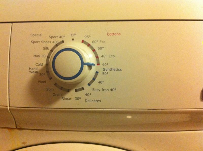

In all likelihood the machine has not been reset in that sense of the word. Most probably the alarms have just been erased from the Eeprom via the service program. Which may (or may not) get your machine to function in the short term (at least until the alarm reoccurs, then you're back to square one again). If the washer doesn't have a display then the alarm codes are manifested via the control led's. Post the machine PNC number (on the door sticker) & we'll see if we can get to the bottom of things. Also state how old the washer is & if possible post a picture of the control panel.

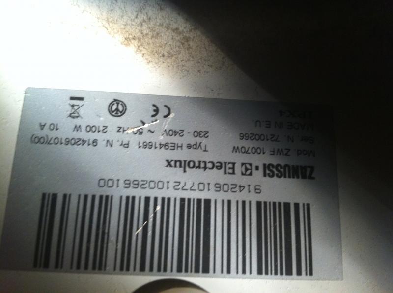

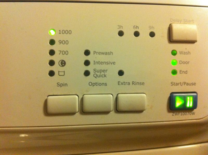

Ok that's great...PNC number is visible on the first photo (914206107/00). To enter service mode turn the machine off at the program selector. Then press & hold in the start button and first button immediately to it's left. While holding these in turn the program selector 1 position to the right (95C). Wait 3-4 seconds then release the buttons. Turn the program selector clockwise to position 10. At this point the start button led should begin to flash...observe the led sequence/colour & report back.
E52. The culprit is one of the following: motor fault , break or bad contact in the motor wiring , or pcb trouble. At 2-3 years old the motor brushes shouldn't be too badly worn unless the machine is used a lot....but you must remove & physically check the brushes to make sure. Then check the motor connection plug is tight & the wiring to it isn't chaffed/damaged. If the brushes/motor windings/ & wiring all are good then the fault is likely to be on the pcb itself...remove it & check for damaged components/tracks (note; faults are not always evident to the naked eye).
After locating & rectifying the fault cancel all the alarms in the Eeprom. To do this go into the diagnostics mode again & turn the program selector to the tenth position. This time press & hold the start/pause button & the nearest one to it's left. Hold down for min 5 seconds until the led's stop flashing. Doing this erases all error codes stored in the Eeprom. Good luck :D
