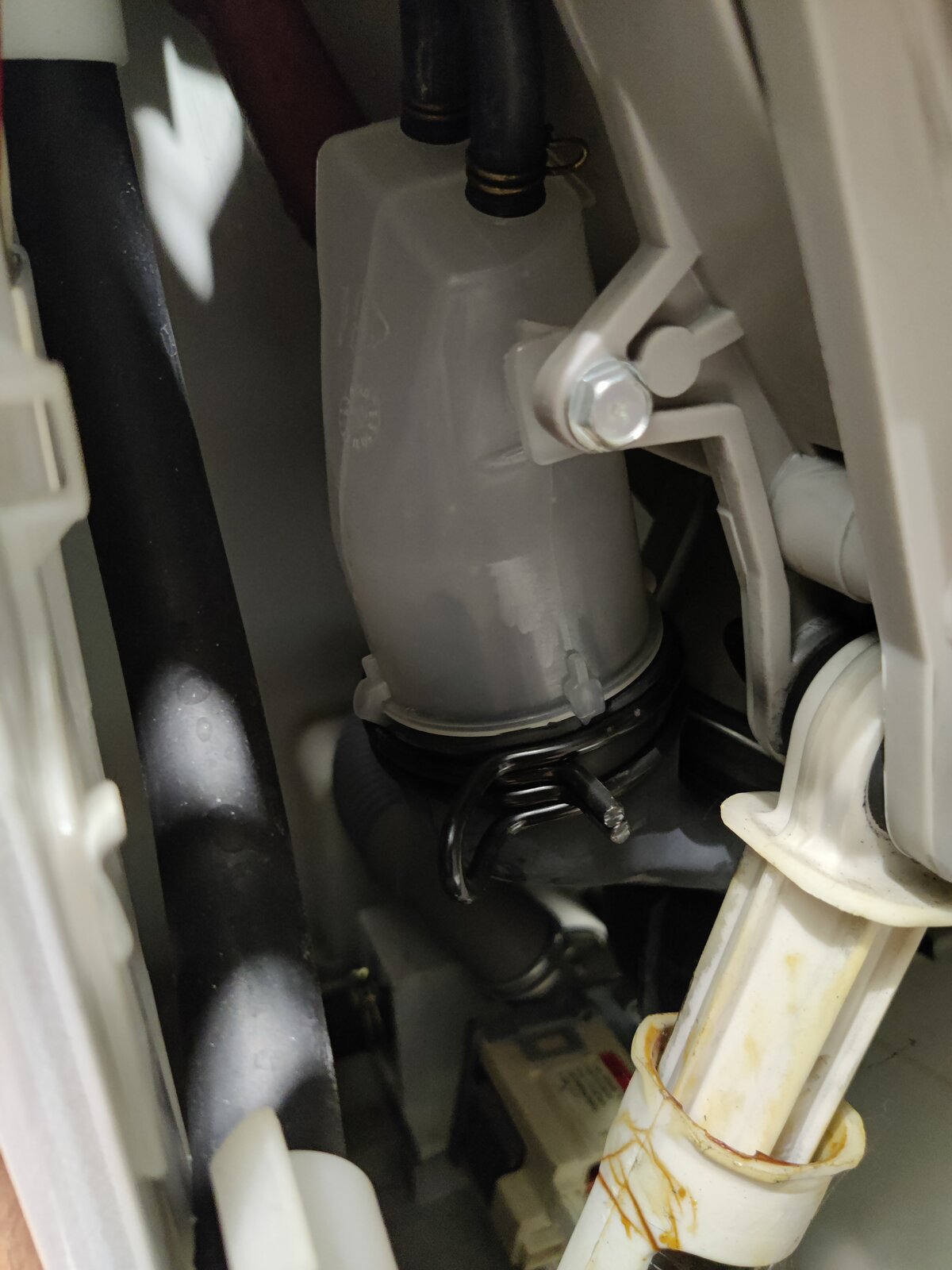

This time, I have managed to figure out how to get the back case off and can now see the full pipes and the vessel they connect to.
so the questions I have are:
1) should the vessel have any water in it already? if so, how much? and what's the best way to fill it?
2) now that its open I can check resistance of the heating element 28.7 ohms - can someone tell me what the resistance should be?
So I had the top and back off again yesterday.
Took the drain off the bottom of the drum (which also links to the water chamber that the pressure switches connect to). Gave it all a good clean, and re fitted. It kind of ran the wash cycle, so I stopped it and put a load of cloths in. it wouldn't run.
More fiddling and it seems that I need to put some water in the drum - needs a fair amount, then it will run. If its dry/not run for a while, then it doesn't want to run.
I took the board off and visually it looks like its fine - no scorch marks etc.
Both pressure switches were changed and blowing through the pipes shows they are clear (and visually I checked in the chamber at the bottom when I removed it to clean...
Any other ideas?
Has the tube to the pressure switch been cut or crushed anywhere along it's path ( perhaps by the clips & side of the machine ) between the pump & the switch. The switch needs the water in the drum & pump to operate the switch & start the wash cycle.
I had it apart yesterday, and as far as I can see, the tubes are intact - I will remove them both and do a bubble test in water the next time I take it apart.
So when I start a wash, the first thing the program does is pump OUT any water in the drum. At this point after approx. 10-15 seconds the program fails and timer goes to 0, and door unlocks. The program never starts to fill the drum to activate the pressure switches. At the end of a successful wash, I would assume water is pumped out to below the drum level thus there is no water in the chamber for the next cycle.
