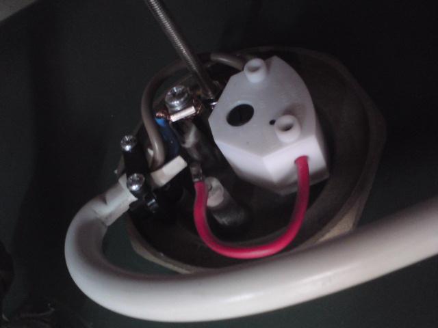

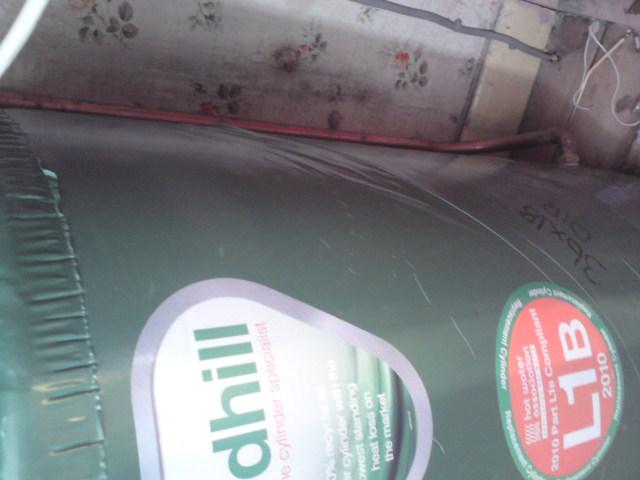

Here are some photos that might be of help in identifying something obvious that I cannot see?
[/img]
With the power safely isolated (preferrably at the consumer unit), disconnect the red and brown wires from the thermostat (white plastic bit in inmmersion heater). the thermostat should then just lift out so you can check the length of the one fitted. It should be about the same length as the pocket it sits in. No need to turn any water off - the thermostat just sits in a dry pocket.
If a short one is fitted, it will only respond to the water temperature at the top of the cylinder, not the temperature lower down.
Just found the end of the box with the label on that the plumber brought with the latest immersion (including thermostat) - it's a 27" immersion element with an 18" thermostat - model number is HS27 and supplied by Banico Controls. The copper cylinder that the plumber put in is a 36 x 18 direct cylinder with envirofoam by Gledhill.
That wire from the immersion looks like it doesnt go direct to the switch, do you have a timer on the immsersion circuit?

Hi
Yes- the wall switch cable goes to a timer on the wall, then another cable goes from the timer to the top of the tank. The electrician I had in checked all of the voltage etc from the switch on the wall to the timer and then from the timer to the tank - so all should be ok. Plus I got him to check that the plumber had wired it correctly and he confirmed he had.
