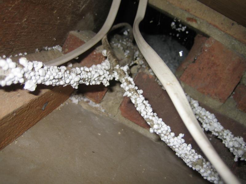

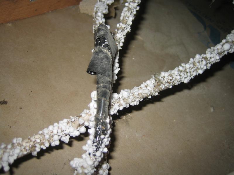

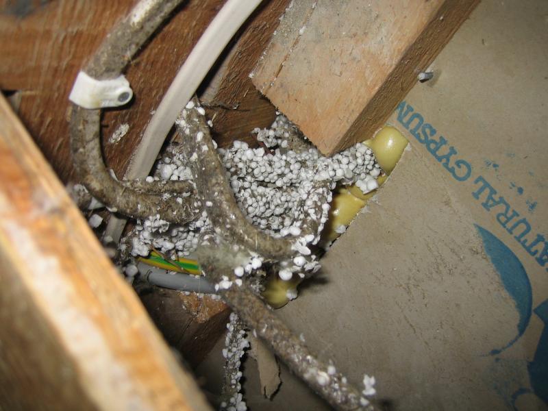

Last year I had a new consumer unit fitted in the downstairs hall by my electrician. He also installed some other lighting, checked all the sockets, and checked some work I did before certifying all of the work. This year I'm about to fit new wood laminate floor to the upstairs hall. I had a look under the boards and some birds had built a nest above the place the consumer unit was! Well, I cleared that out, but the polystyrene beads from the cavity wall insulation had poured in due to the birds making a hole into the cavity. Now I've got some ugly looking cables and a few bits of polystyrene left. Will the polystyrene attack it further? Should I get my electrician back to replace all the cables? I added some photos.
Thank you in advance for your responses.
The cables need to be replaced. The polystyrene causes the plasticiser in the PVC insulation to migrate out of the cable, which is what the sticky mess is, and this results in the cable insulation becoming brittle and cracked.

Need to replace them, and the ones that look OK but disappear into the netherworld need to be traced and checked along their lengths....

The polystyrene hasn't really gone - it's just occupying a lot less volume than it did before, and it won't have just made the PVC cable sheath a bit grubby and sticky - it will have leached out the plasticiser and rendered it unfit for purpose.
Needs to be replaced.

Thanks for all of your comments. I have my electrician coming on the 23rd to replace all those ugly looking cables. On the ones that come out, I'll try the solvent on them before binning them and post back to this forum.
Where the cable has landed on a sheet of polystyrene (above posting) I think that presents a bigger risk of fire, since there's more styrene about to react with the PVC. I believe what happens is the plasticiser is pulled out of the PVC, leaving it quite brittle. So, in a few years, with a some movement in the loft, you could be looking at a break in the cable.
