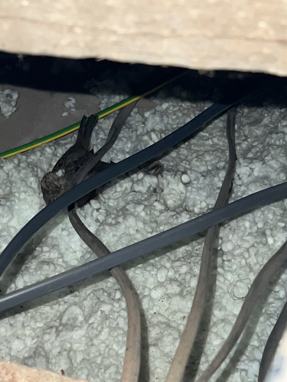

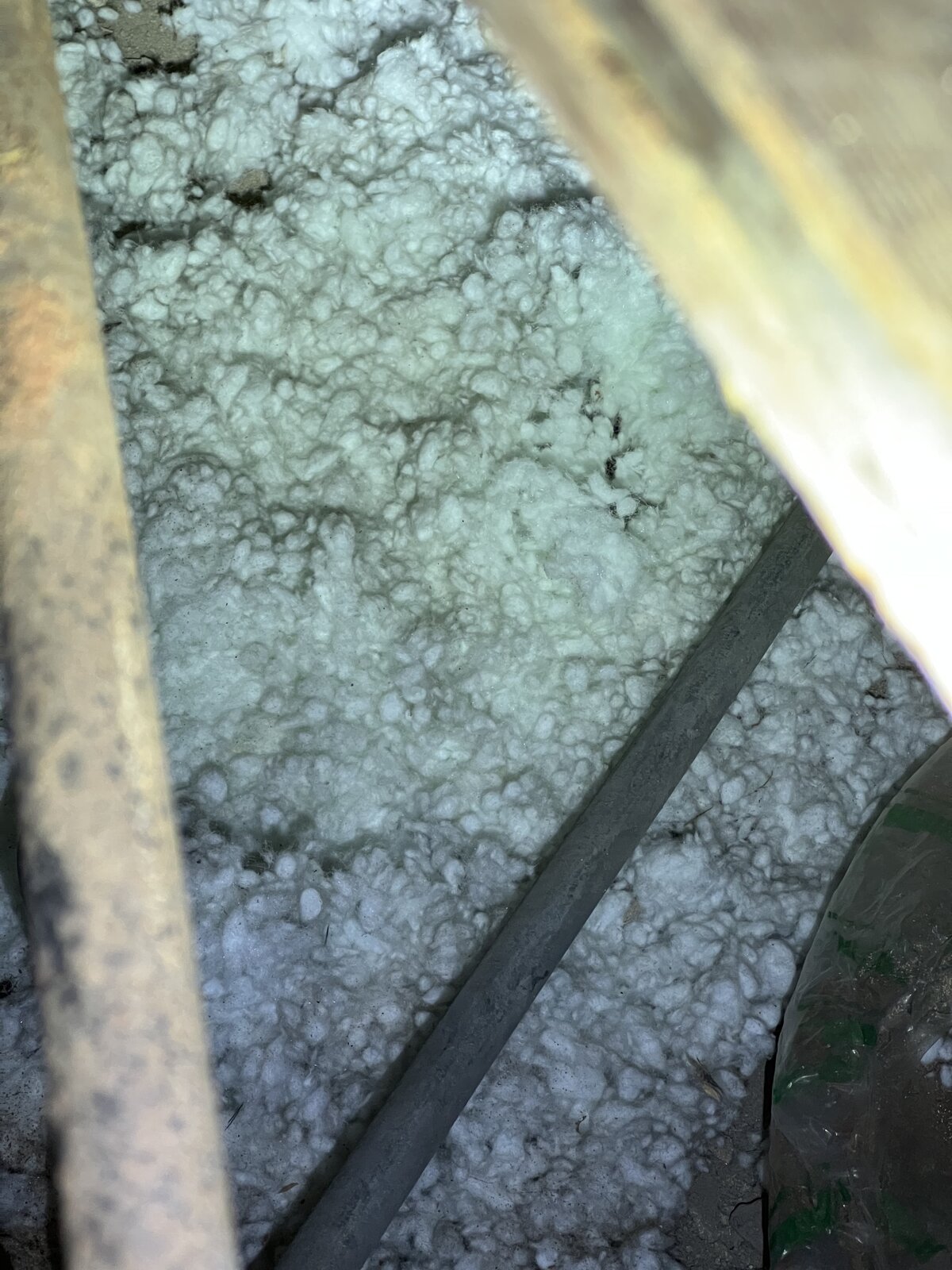

UPDATE
I got home and managed to take a picture of it. It looks more like wool than polystyrene?
whatever it is, it killed this bird and appears to have came in a packet?

While the bird may have died, that does not prove that any of that substance caused its death.
(Most birds do not live very long, as compared to human beings.)
While you may be becoming paranoid about this, just do that which I recommended and
"take a small sample of the product which you think may be either polystyrene or asbestos (or wool) outside to a suitable "site", dampen with methylated spirit and ignite."
If it burns away to (virtually) nothing, it is not asbestos.
I'm starting to think, after intense googling that it may be loose fill fibreglass - which in this case woudln't burn either?
But the ends of fibreglass fibres will be seen to melt, using the "test" which I suggested, whereas asbestos fibres will not !
However, since you are worried, get a sample tested by an accredited organisation.
https://www.hse.gov.uk/asbestos/managing/sampling.htm
