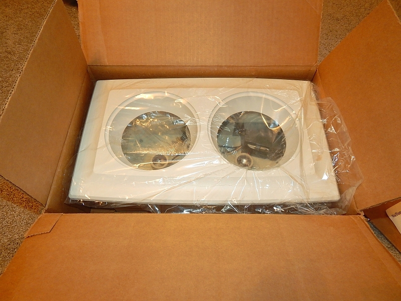

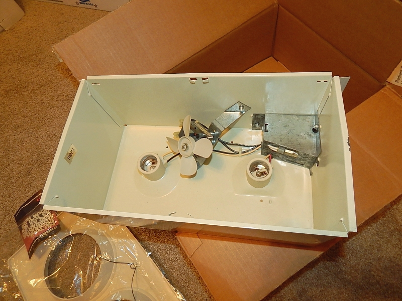

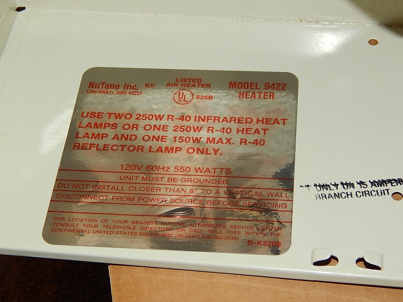

This is a new unit I have waiting to go in our bathroom when we get to that part of the house, which is probably very similar to what the OP has, short of possibly different trim:

Perfect! Exactly what I wanted! :D Thank you very much!

Yea, that is what I meant regarding US V, I wasn't certain.
That unit you have there (NuTone) is the only one I could find before, but as far as I could tell they don't make them for the British market. The 'MiniSunheat' unit looks like it will do the job perfectly though :)
