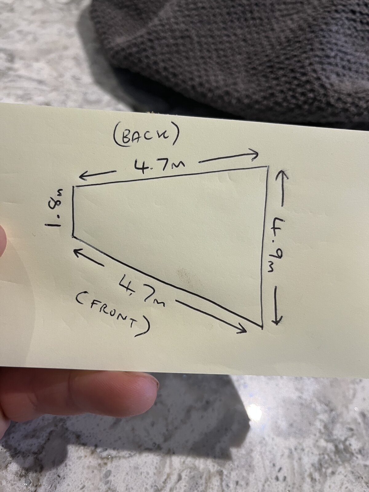

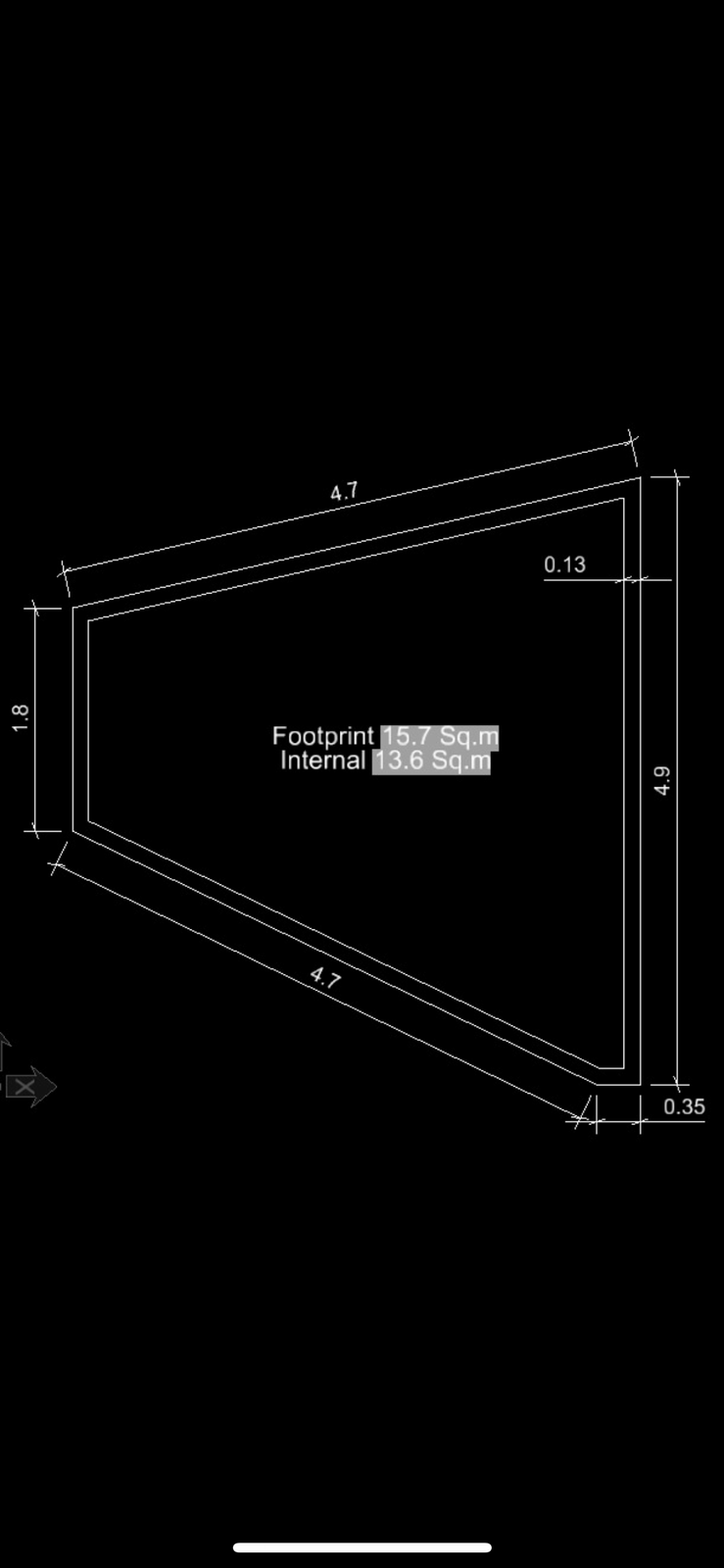

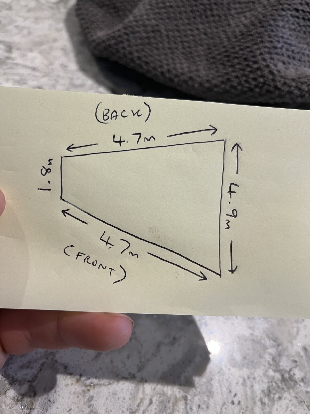

Garden room height came out at 2540mm!! 40mm over the what it should be :(
Hard to judge from photos, but it doesn't look like more than 15m2 to me. Mine's 16m2 internally, and it looks like half a house.

My point is that the official government guidance doesn't state anything about area - floor, building or otherwise. Lots of unofficial sites give all kinds of numbers, e.g. 15m2 or 30m2 if non-combustible. But as far as I can tell this is all rumour.
What's yours made of? If it's "substantially non-combustible" then according to that labc guide it can be 30m2. It looks like metal to me, in which case you may be covered under that.
Mine's brick, and is around 16m2. It seems I could have built much bigger if I'd wanted to.

The floor area is a Building Control issue not Planning.
Whether you need planning permission or not is definitely a planning issue.
