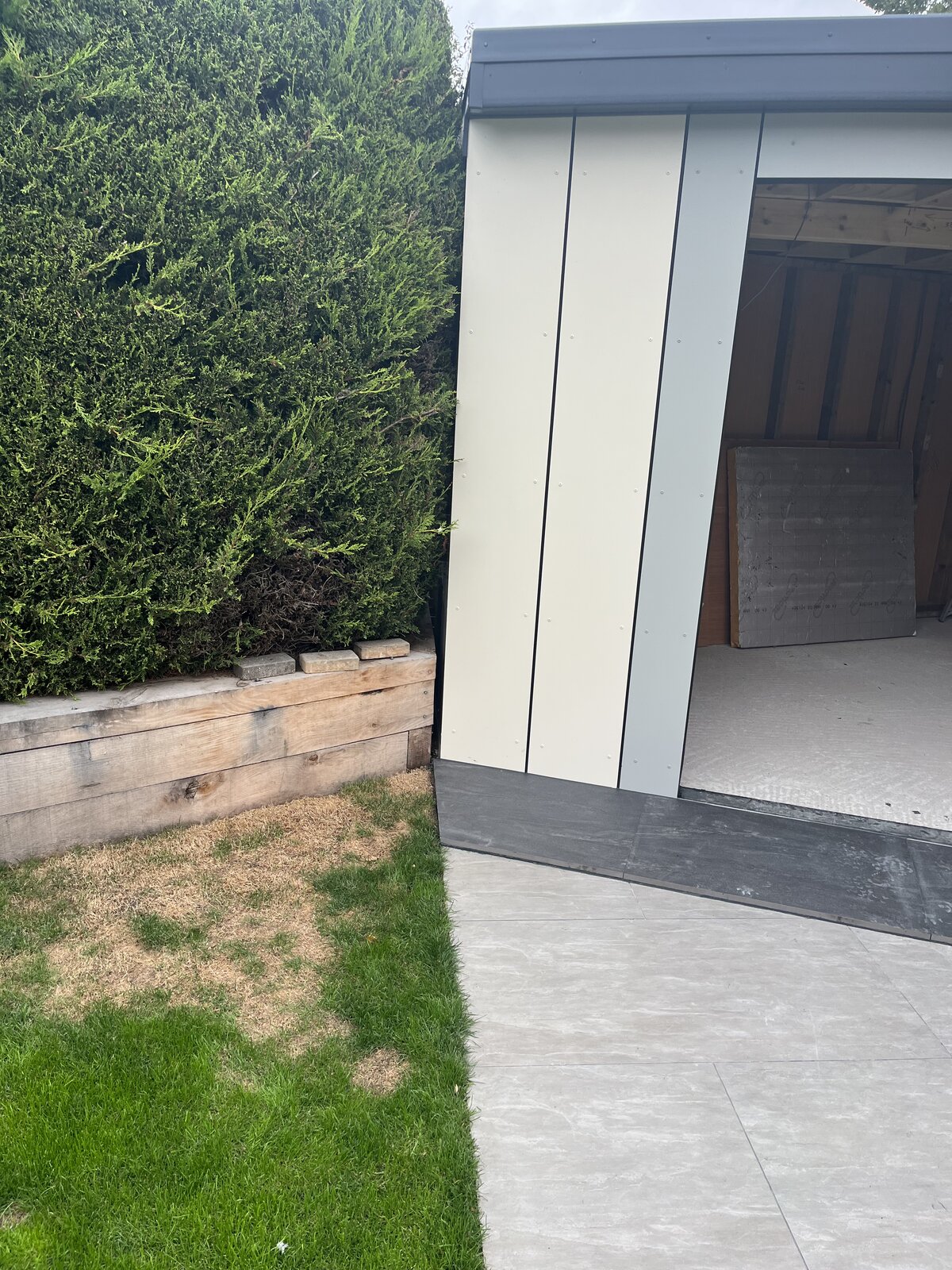

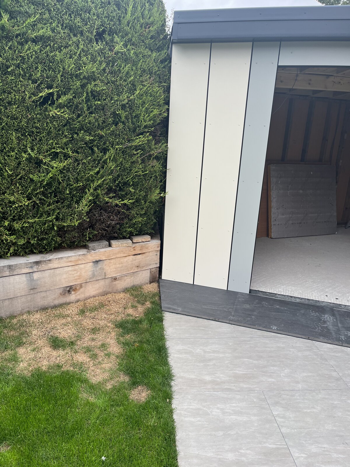

Garden room height came out at 2540mm!! 40mm over the what it should be :(
It wouldn't be expedient to take enforcement action over 40mm. They shouldn't even invite you to apply for planning permission if they know in advance that planning permission is likely to be granted, which it probably would if you're only a very small amount over the permitted development allowance and no significant harm has been caused, which your photos suggest is the case. You could do nothing at all and be fine from a planning perspective.
If you want to sell in future then you might need to regularise the situation with a planning application to satisfy a fussy buyer. Ideal would be for it to be within PD regs as you can then apply for a certificate of lawfulness which is a little more straight forward. But either way is fine in this situation.
If you want to build the ground up a bit to make it PD, that could work providing they don't have any unambiguous evidence that you've done so. Has somebody taken photos and reported your building to the council? The council officers aren't going to try and figure out if or how the land levels have changed. Without any survey evidence it would be a guess unless really significant changes have occured that would be obvious even on an angled photo. You will simply state that some landscaping works have taken place and the ground levels are no higher now than they were before, with the part near the outbuilding always being a little higher to begin with. It's more or less the same. Then your new flags can probably be accepted as ground level. In the absence of clear evidence to the contrary they'll likely accept your version of events especially being so close to the margins.
As discussed above though, you won't get into any trouble for 40mm. Even if they were silly enough to serve a notice you'd win the appeal. The flags idea is nice because if you can achieve PD criteria then it makes things slightly more straight forward if you ever cared to regularise matters. Not that you ever need to.

The criteria for the measurement is ground level, and it specifically does not include anything laid upon the ground such as paving or decking or suchlike.
Don't bother, it wont give you piece of mind.
That May be the case, but since groundwork has taken place, there is no way of them knowing what the existing ground level was. Laying the extra slab will sufficiently ‘blur the lines’ and I can make the case that the existing ground level was in line with the top slab prior to the ground works taking place.

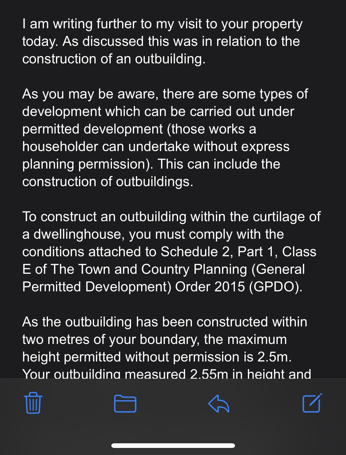

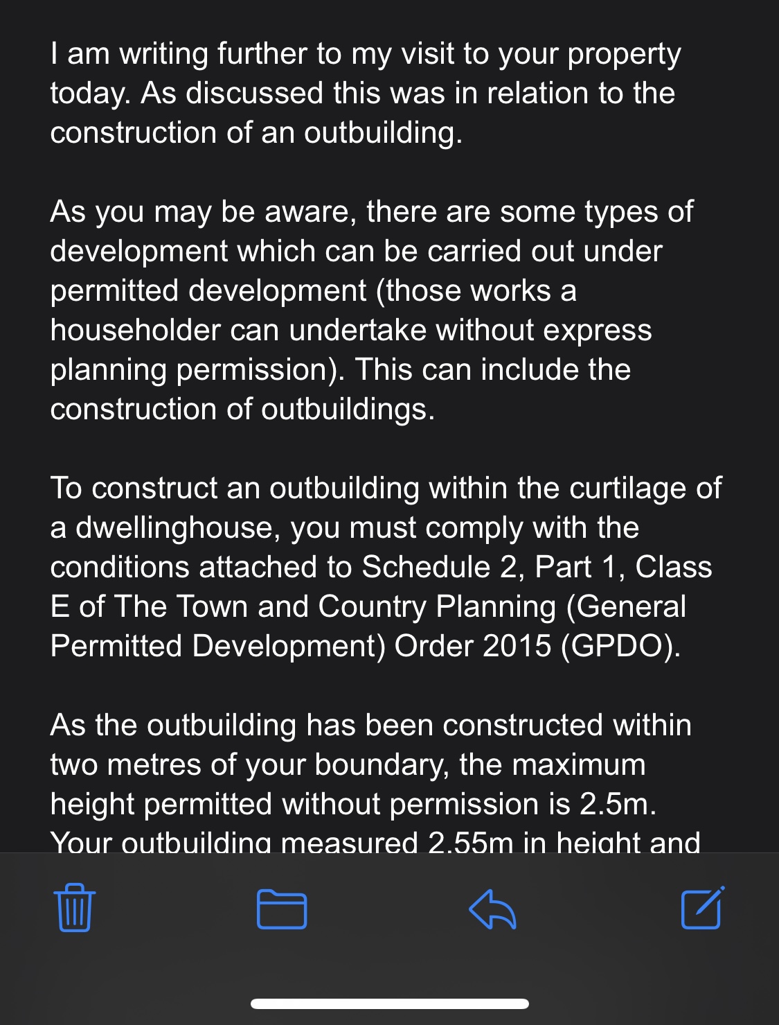

Ok guys so I have had the planning inspector here today. She was literally here for 5 mins and then left. She was only interested in the height and that was it (she measured off the grass and not the patio). She said it can be as big as you like (within reason) but it must be 2.5m height (if within 2m of the boundary).

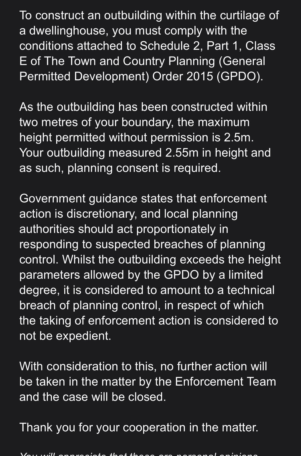

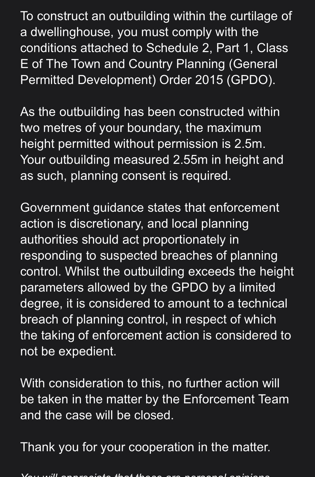

This evening I have received the attached e mail and it seems I got lucky! It was 50mm too high (when measured off the grass) but they are willing to overlook it on this occasion.
Thanks for all the help and comments.
