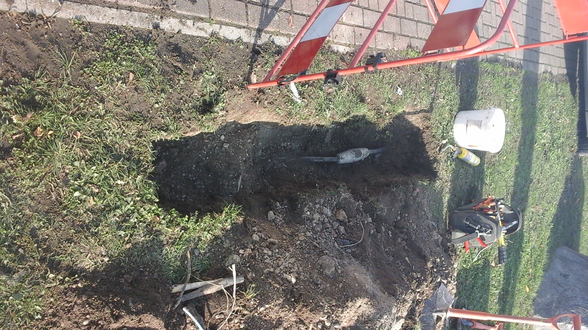

Firstly they did the equivalent of "meggering" the 11KV cable and found a short between phases. Then they got a "thumping box" which sent pulses of 11KV down the cables and monitored the cable route for vibrations. They also had a "pulsing" machine which sent an echo pulse and measured any reflections. The intensity and time of the reflection indicated the type and distance of fault. Both of these processes, and they excavated right onto the faulty section of cable.
I was pretty impressed.
Well thats what they came and done, it was a failed joint, .
Trench was 2 metres as they encountered a lot of "noise" due to nearby machinery.
used a Megger Thump 12 cost about £13000
