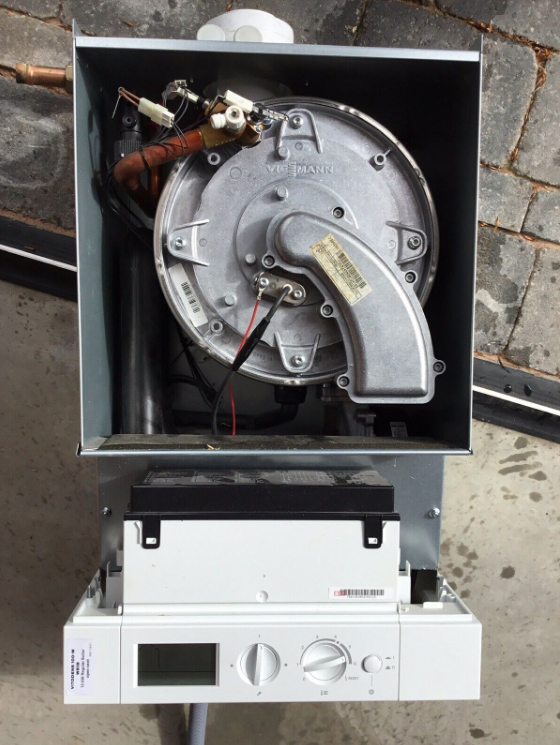

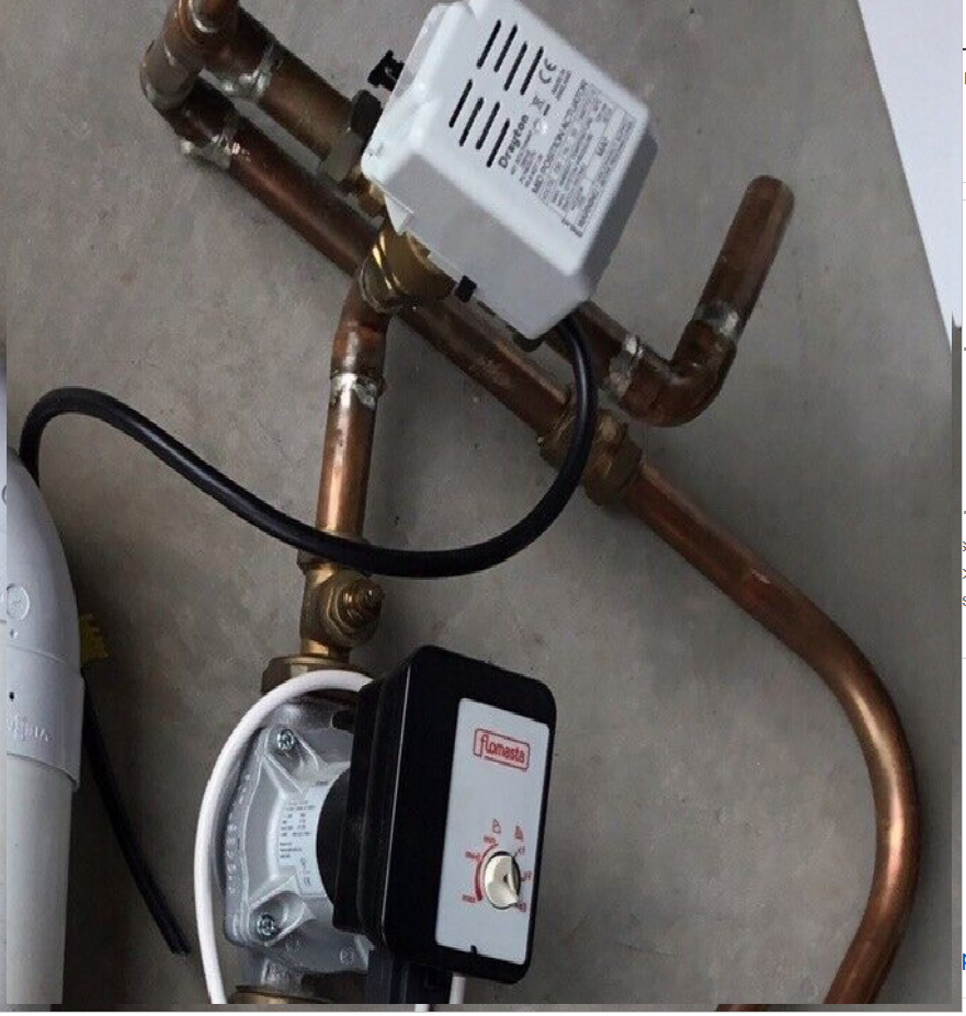

Hi,
Attached please find pictures of a boiler that I intend to buy for my home; a 13kw (used) viessmann regular boiler with pump and diverter valve (in the picture). What else do I require for installation and spares that I can get from London before it is shipped to me. I am not in UK and this will be installed in my home town in Pakistan so it will be sent to me from London. The smallest boiler available here is 24kw!
I intend to use it for Central heating only, my current boiler is non condensing type so this would be a huge improvement for me.

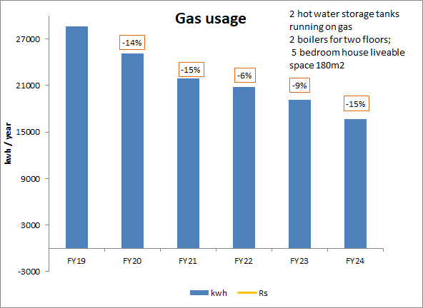

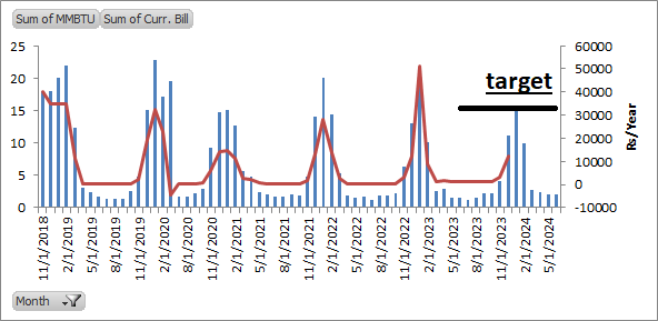

My inclination for this purchase is 10-20% saving from non condensing to condensing world. My target is to bring gas consumption down from 19000 kwh/annum to 15000kwh in FY24. With DHW being diverted to electric (since I have 10.8kw solar) and efficiency gains in boiler upgrade I should be able to bring my usage below my target. This winter will be moment of truth for this project, if it didn't work the way it should then I can always put the old boiler back in winters.

I inherited the system and I have brought the usage down over the 3 year period.
2nd HW storage tank made redundant in 2021, last year decommissioned the other boiler and extend the pipework to 1 boiler operation for the whole house. I have already fixed gas leaks in internal pipework (two kitchens in two floors) this week and it is going to bring gas usage down to 5%. The rest I am counting on boiler upgrade.
