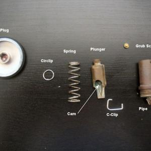

    I emptied the trap and found a piece of bent brass wire approx 1cm long which might have something to do with it. :?

    The push-button (push to close - push to release) sprung waste plug in our basin became increasingly stiff and difficult to release until it stopped doing it completely. I have removed the brass mechanism and cleaned the plug plunger and pipe into which it slides to compress the spring and it...
