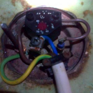

    immersion heater termostat cut out problem
    My reset button holds, pops at whatever temp I set it at but continues heating. I'll get a new one then disassemble the old one and post a pic if there's anything to see.
  2. S
    Hopefully that worked! If not check in my albums. Live (brown) on right is between the element connection and the thermostat, live (brown) on left between electricity supply and thermostat. Neutral (blue) dirct from mains to element post. Earth on earth post. Any ideas or just a faulty...
  3. S
    Hi, I have an immersion heater with an 18in thermostat with an adjustable temp cutout and reset button. The problem I have is that although the reset button 'pops' out when the water reaches the temerature set (65 deg) the water continues to heat up - basically the reset bit is not cutting...
