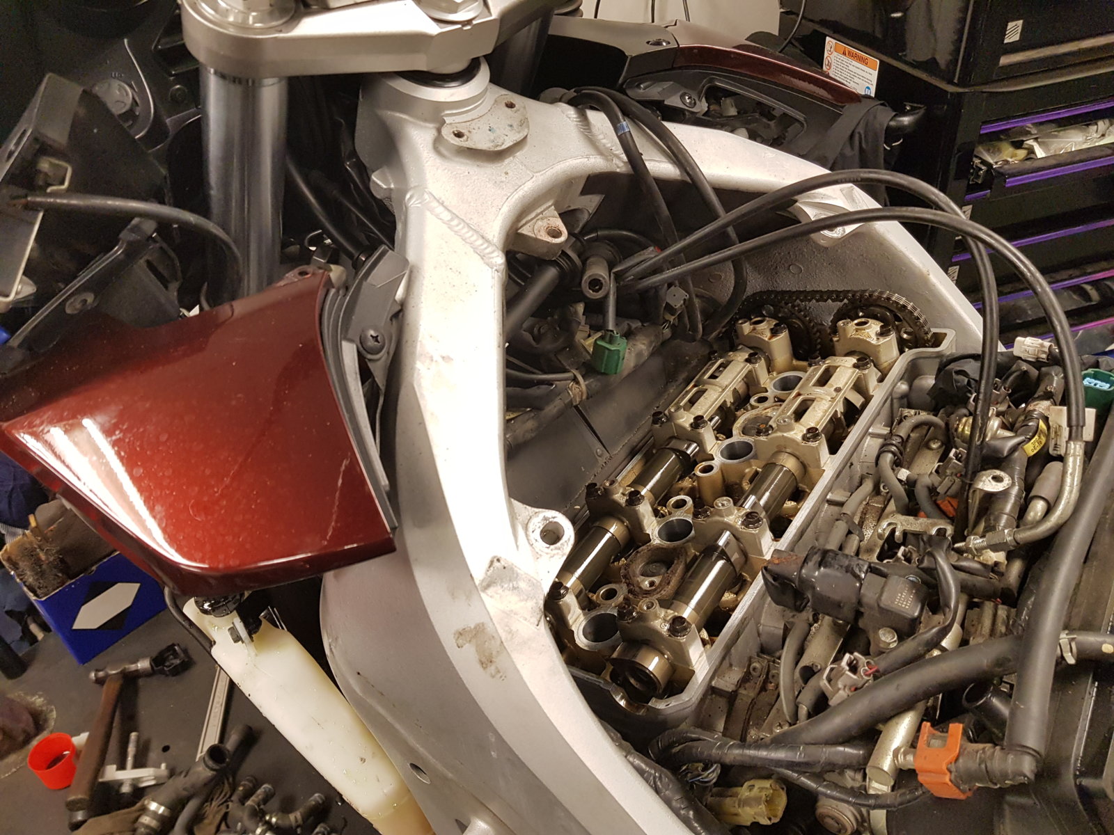

With the VTEC VFR 800's you have to take cams out and fit VTEC stoppers before you can even measure a valve clearance, makes job 4 times as difficult..
I get on well with workshop manager of a Honda dealer and he said he used to take the day off if one of those came in for valve service!.

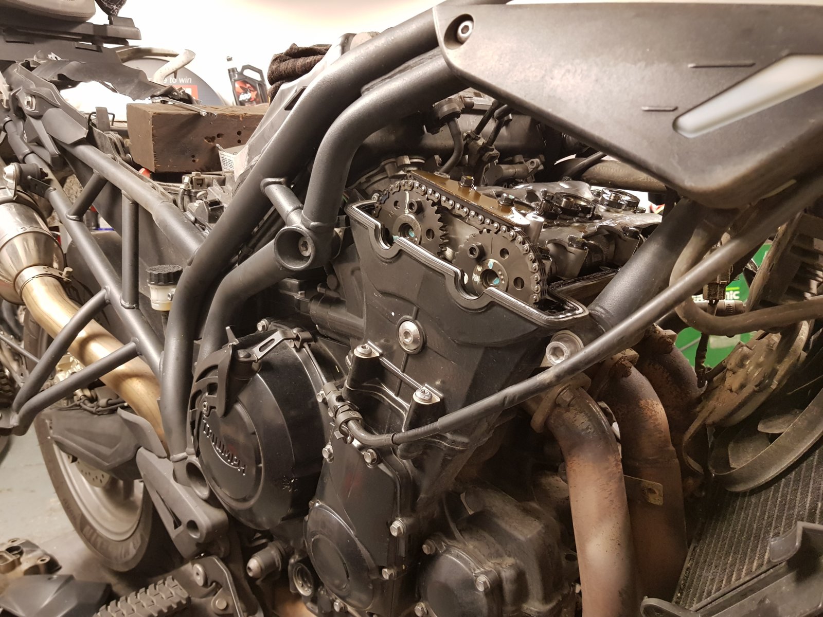

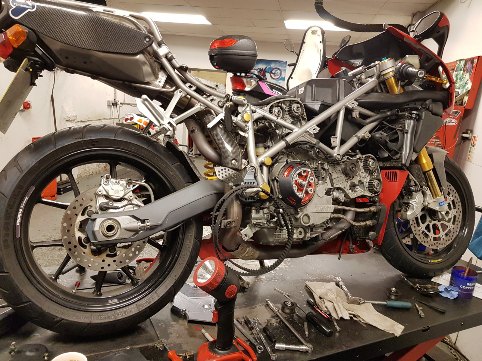

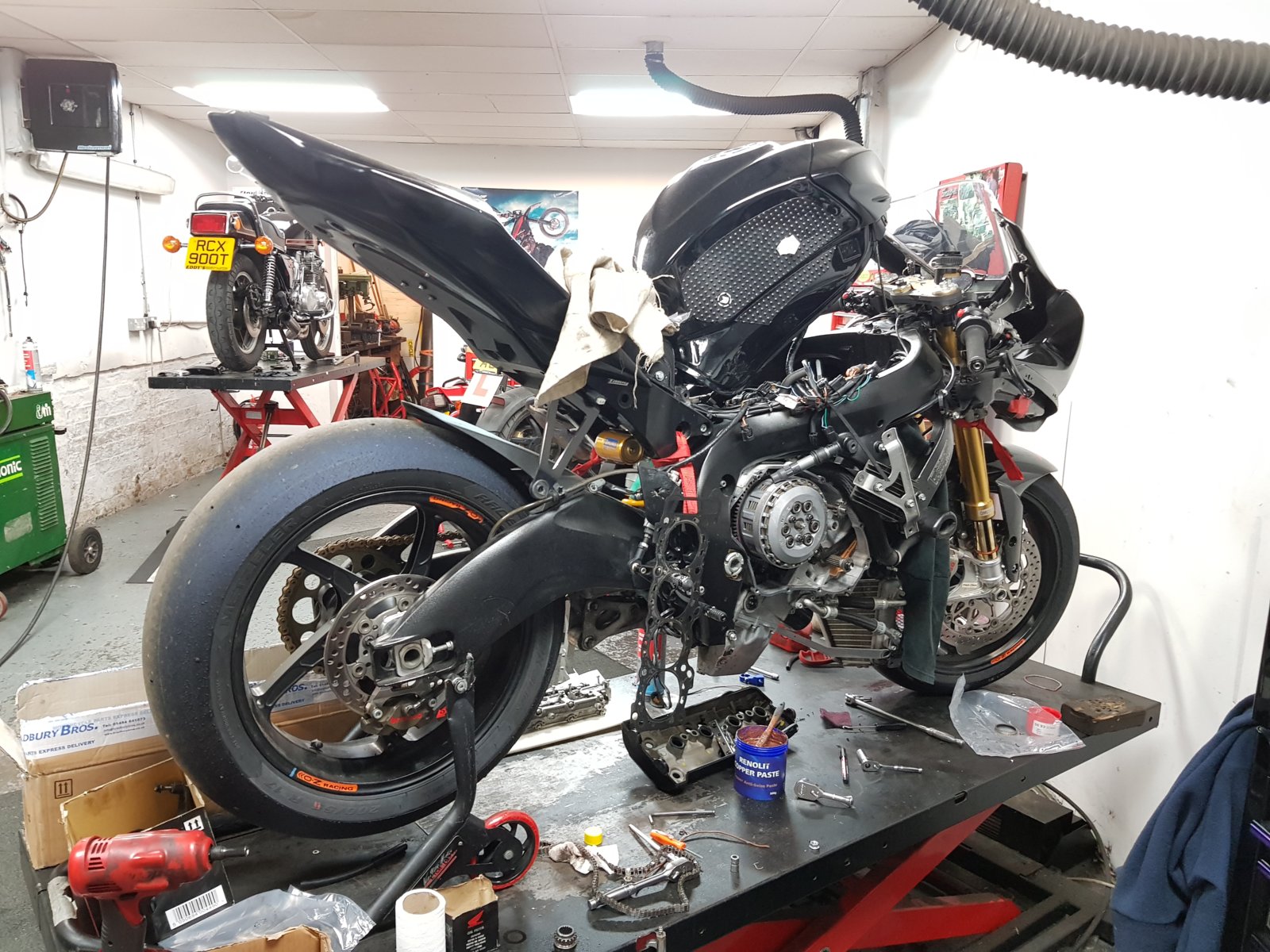

This is a usual job on my bench, started taking pictures for customers of major service work and they all appreciate it (got plenty of jobs from there friends as well!).
