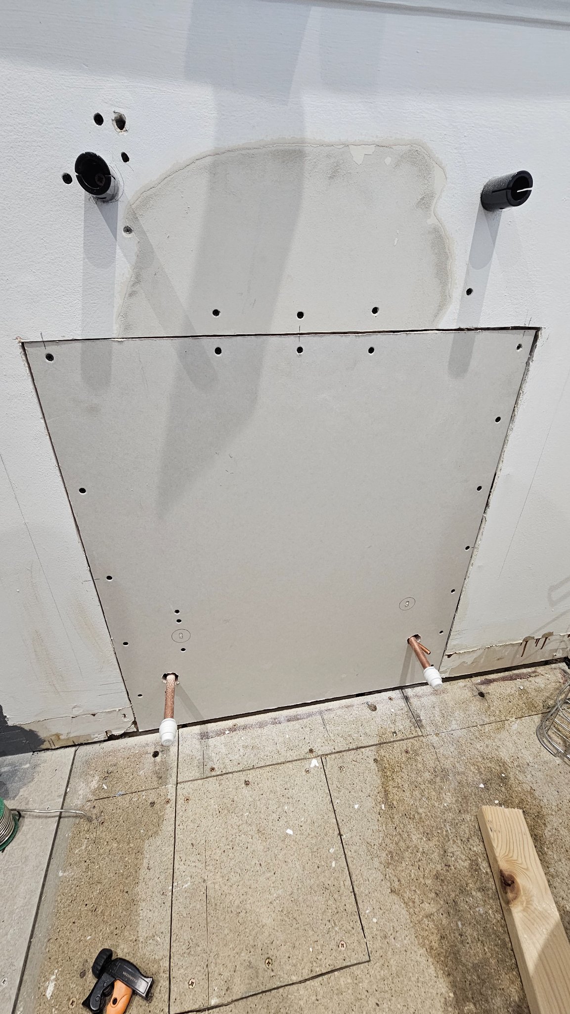

I had some pipework to run from the floor up into the wall for a towel rail during a recent barhroom renovation.
Iv got the pictured patch to fill in.
There is a gap on the right hand side. Am I better to remove and pack the back of the board or just use filler over a larger area?
Any recommendations on what to use? I have looked at easyfill and toupret interior filler and try almost a small area skim.
Or would this need something more like toupret joint, fill and skim?
Thanks all

Toupret powder filler.
A 2kg box might do that but for the cost it wouldn't be a problem if you had to buy two boxes.
PVA in joints and let dry. Use wood glue and a splash of water to thin as that's PVA if you have some.
Fill joints. Push filler in a bit.
When setting after 30 mins ( approx ) mesh tape and filler over joints.
After 30mins when setting fill over again.
Keep repeating until you are happy.
Let it dry.
120 grade sandpaper on something flat like wood and sand smooth.
Paint.
Filler is easier and better to skim over when setting and damp Vs dry. Just build up the layers.
You can spot fill when dry if needed though.
Also the flatter and more level you get board in the easier it is and better than job.
Packing plasterboard at the back so it sits flush. If you have to remove a bigger area so be it.

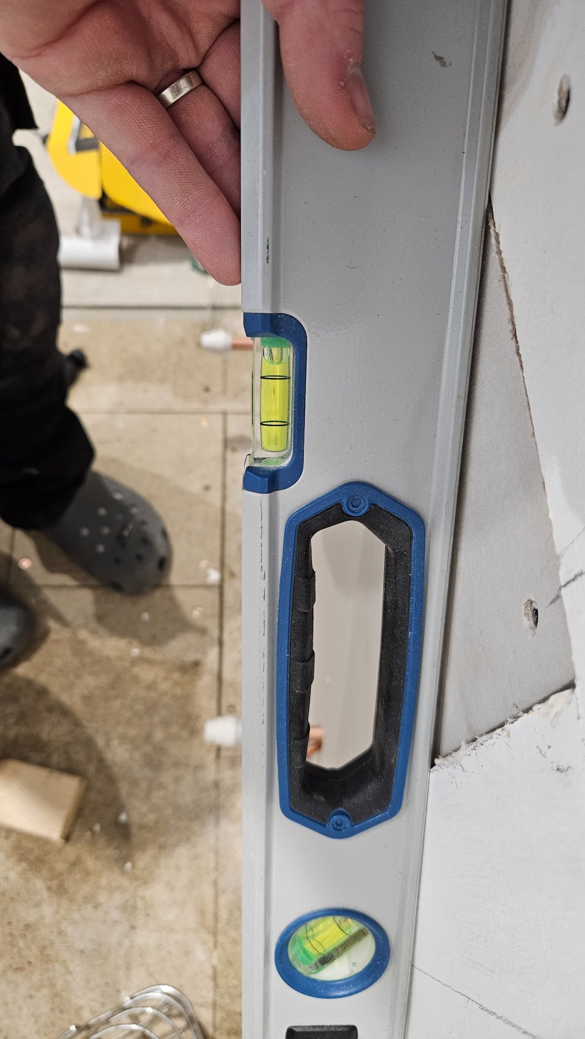

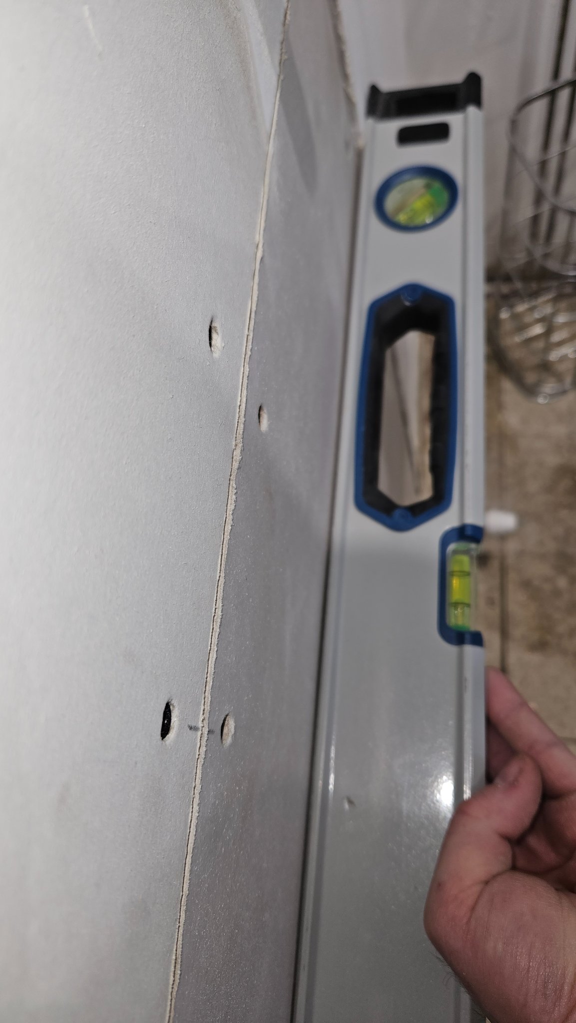

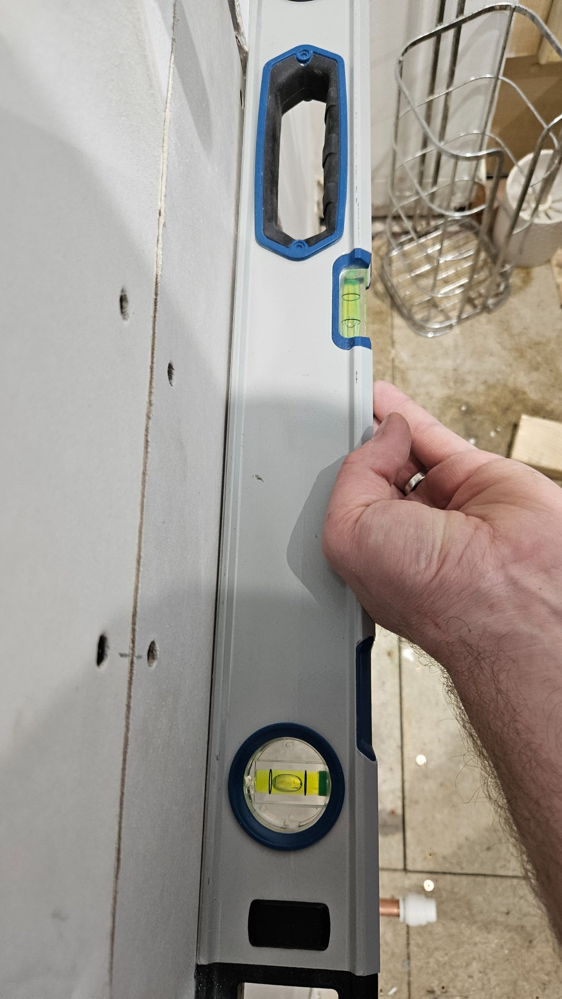

On the right hand edge where the boards are at a different level, should I chase 1mm out down the high side board to set the mesh scrim in to help avoid a bump and having to feather out further?
Thanks for your help!
You could but I bet if you set your level at any other point on the wall, unrepaired place, you’ll find a 1mm deviation that you don’t notice in normal use anyway

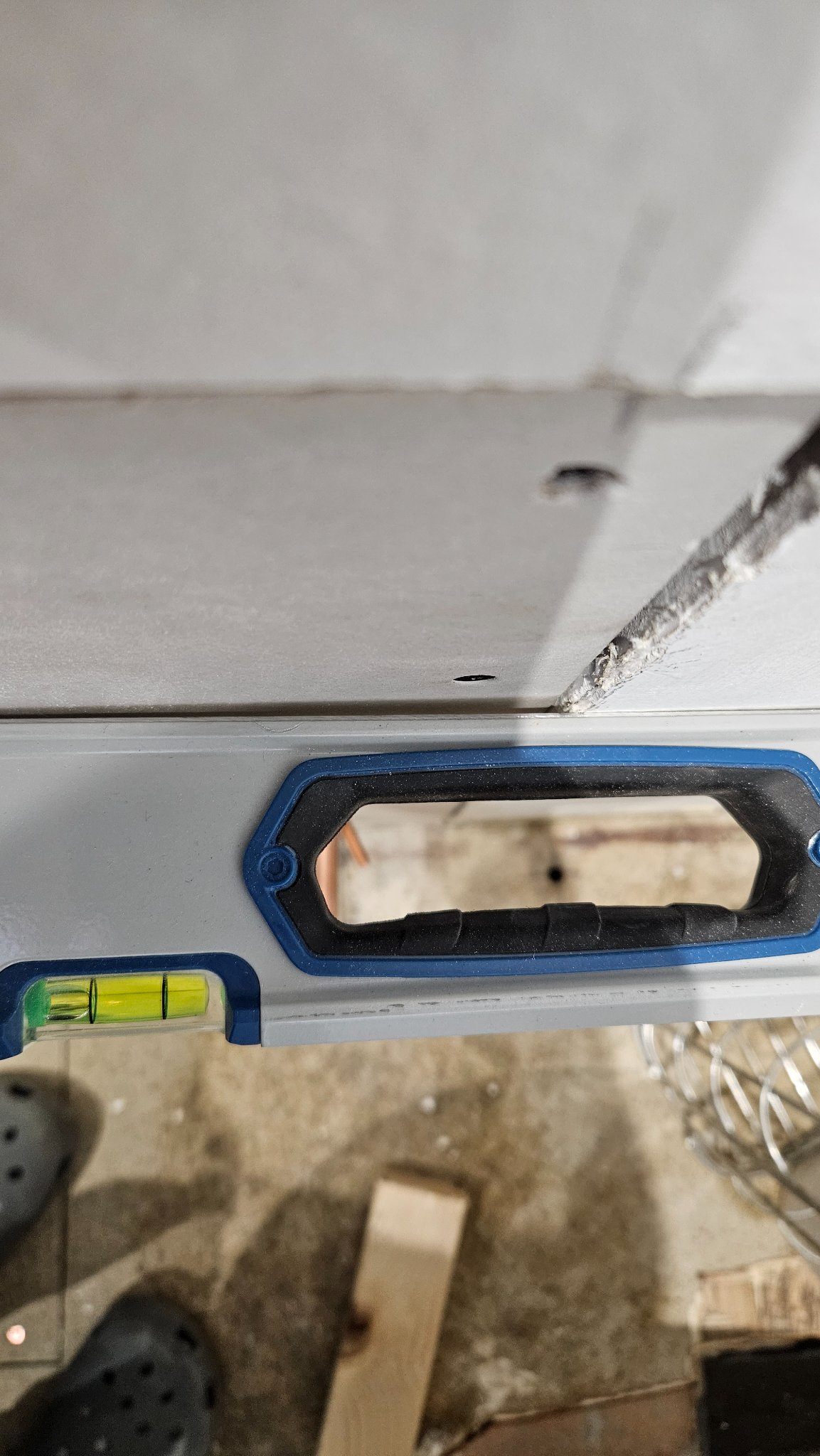

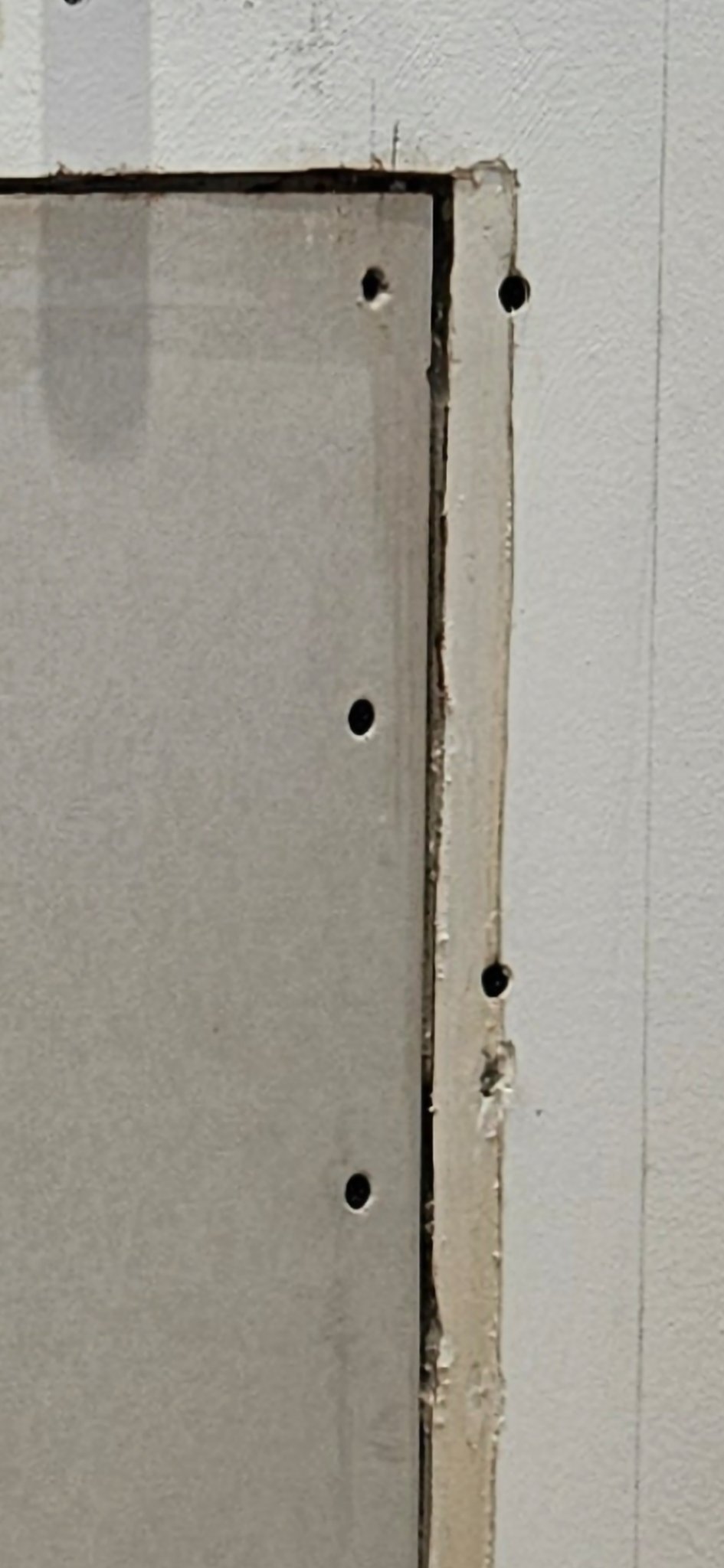

I stuck the pva in to the joints on neat as I wanted to get on with something today haha. Hopefully thats fine.
Scratched back some of the right hand edge. It looks like it was filled previously for the same issue to be honest. When I cut the board out in the first place there did seem to be a very thick layer of jointing filler. I had cut out to the board edge. Attached a photo to show.

Standard set is fine.
I use the quick dry mostly but it's better on shallow fills so I can crack on.
Drying time is only 30% faster maybe.
Not going to make much difference for what you are doing.
30mins set time is approx. Could be longer depending on suction and depth so don't t take that as fact. Sometimes it takes way longer. Just depends on air temperature and humidity and water temp when mixed.
Neat PVA is fine. Just don't flow so well.
Tungsten scraper or chisel back then to allow for tape bedding in.
Have a damp sponge when filling. You can use around edges of filler to blend in and dampen set filler to polish with blade of you want.

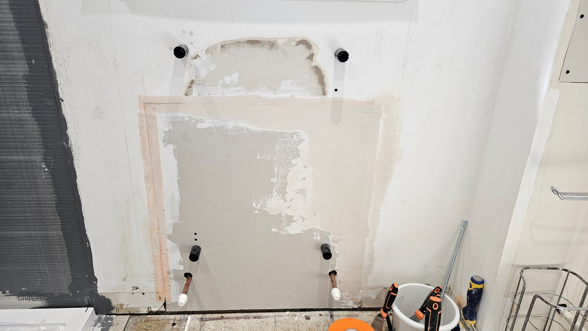

Made a bit of a hash of this first attempt !
I filled up the cracks and got the tape on, clearly mixed to much filler up than I could really get on somdid waste quite a bit (1kg bag)
Also got distracted yapping to a mate who had come around to pick up a reel of cable.
Anyways, how long before I can give this a sand and then try again with the filler?
I mixed up the filler exactly to the 500ml water to 1kg powder, but I'm also wondering if it's worth making the mix a little more wet for applying more of a skimming coat?

I just use a small rubber mixing pot and a silicone cooking spatula to mix powder.
Takes seconds and keep mixing in small batches and I hate throwing any filler away.
You can sand when dry so probably tomorrow although shallow fills takes a couple of hours to dry

Just the consistency I'm unfamiliar with. Will it still go off and set fine if you don't use enough water?
The stated 500ml to 1kg was quite thick but maybe thats how it has to be.
Just thinking a slightly wetter mix might be easier to apply as a skim coat?
I've never measured as I mix to how I want it.
Sometimes really think so it holds in place with no slump, and sometimes thin so I can fine fill large surfaces quickly.
Having a wetter mix will slow setting and adding water as it starts to set will extend setting time.
I mix to ice-cream thickness sometimes for deep fills.
Custard thickness for skims.
Never had a problem
