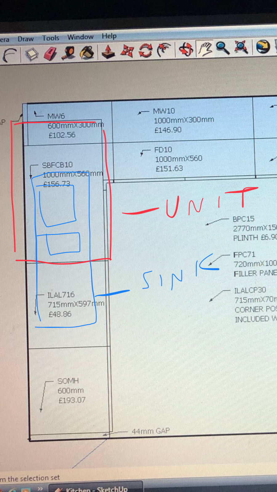

I need a 1000mm straight corner sink kitchen unit to fit my kitchen plan. The door on this unit is 500mm and the worktops will be 600mm and joining at the centre corner of the unit.
Is it possible to fit a standard sink to this corner with 600mm bowl to bowl measurements or will I need a smaller sink. If so, does anyone know of a smaller 1.5 bowl sink?
I’ve attached a pic to help explain.
Plumbing is not a problem, units can be cut/modified to allow space for pipes etc.

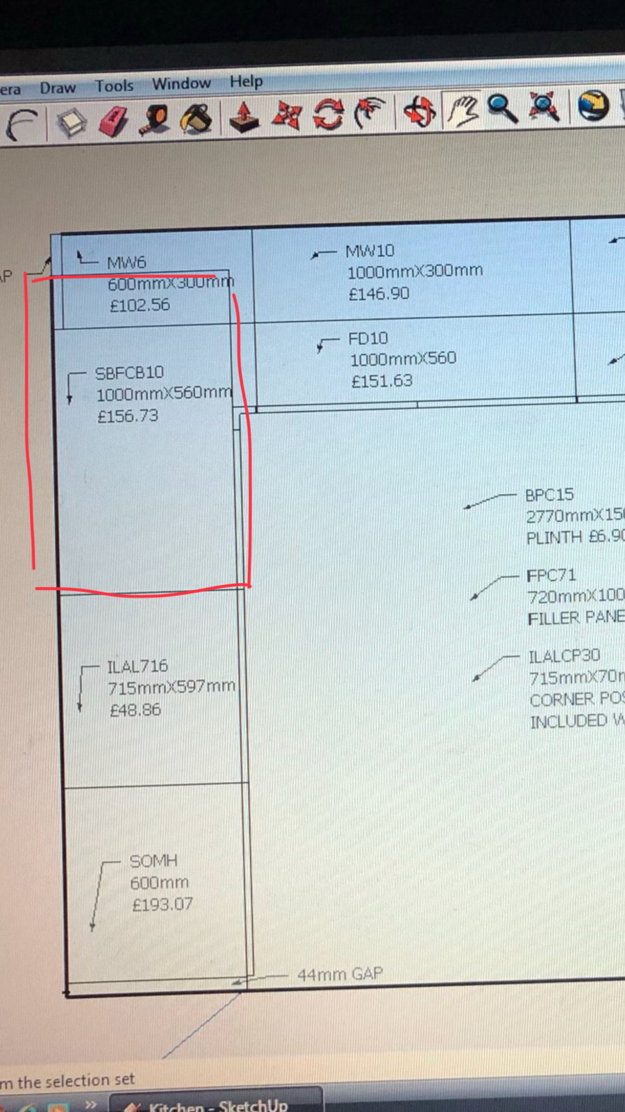

Sorry. I don’t think I explained clearly.
The red highlighted area is the unit. I’ve added another pic to show the sink.
I mean can the sink bowl overlap 100mm or so beyond the inner corner of the unit?
Won't it still interfere with the worktop joint?
The sink won’t overlap the joint as the length of worktop the sink is going on will be wall to wall.
I just wondered if the 100mm (max) of cutout for the bowl would be too close to the edge of the worktop and prevent it from joining the other one with bolts.
It will be in the way of at least one bolt.
If the sink edge extends beyond the corner post, the section of worktop between the sink cutout and the joint will be very thin, unsupported and it's almost inevitable that it will break.
It's also a poor design to place a sink right next a joint, as the water will get in and cause it to fail.

I see your point with the sink and I’m condsidering a smaller sink to fit.
But what’s the issue with the oven against the wall?
I’m not worried about that. Access will be fine.
If that's the design as you want it then you can make it work. Worktops and units can be fabricated as you wish, as long as the fascias are unblemished and you're aware there may be a weak spot below.
Use biscuits with plenty of waterproof pva adhesive on the joint, as well as bolts, then, when you come to recess the sink just grind off minimum amounts of bolt that may be in the way. Support the worktop underneath with various battens where the carcasses have been cut away... As long as its all supported sufficiently and the joint is well made with colourfill, you'll be fine.

Thanks. Yeah it will masons mitred. I’m considering just going for a smaller sink to save any potential issues. It’s just the sink the wife really wanted is 495x995 so will definitely overlap slightly.
