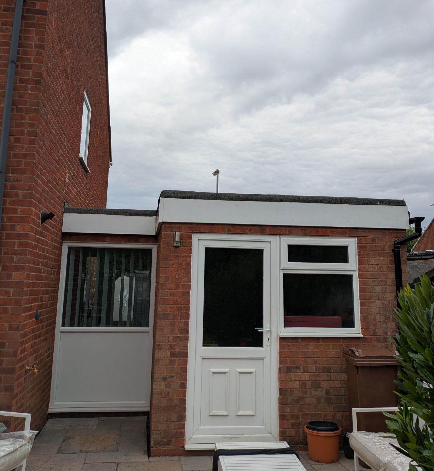

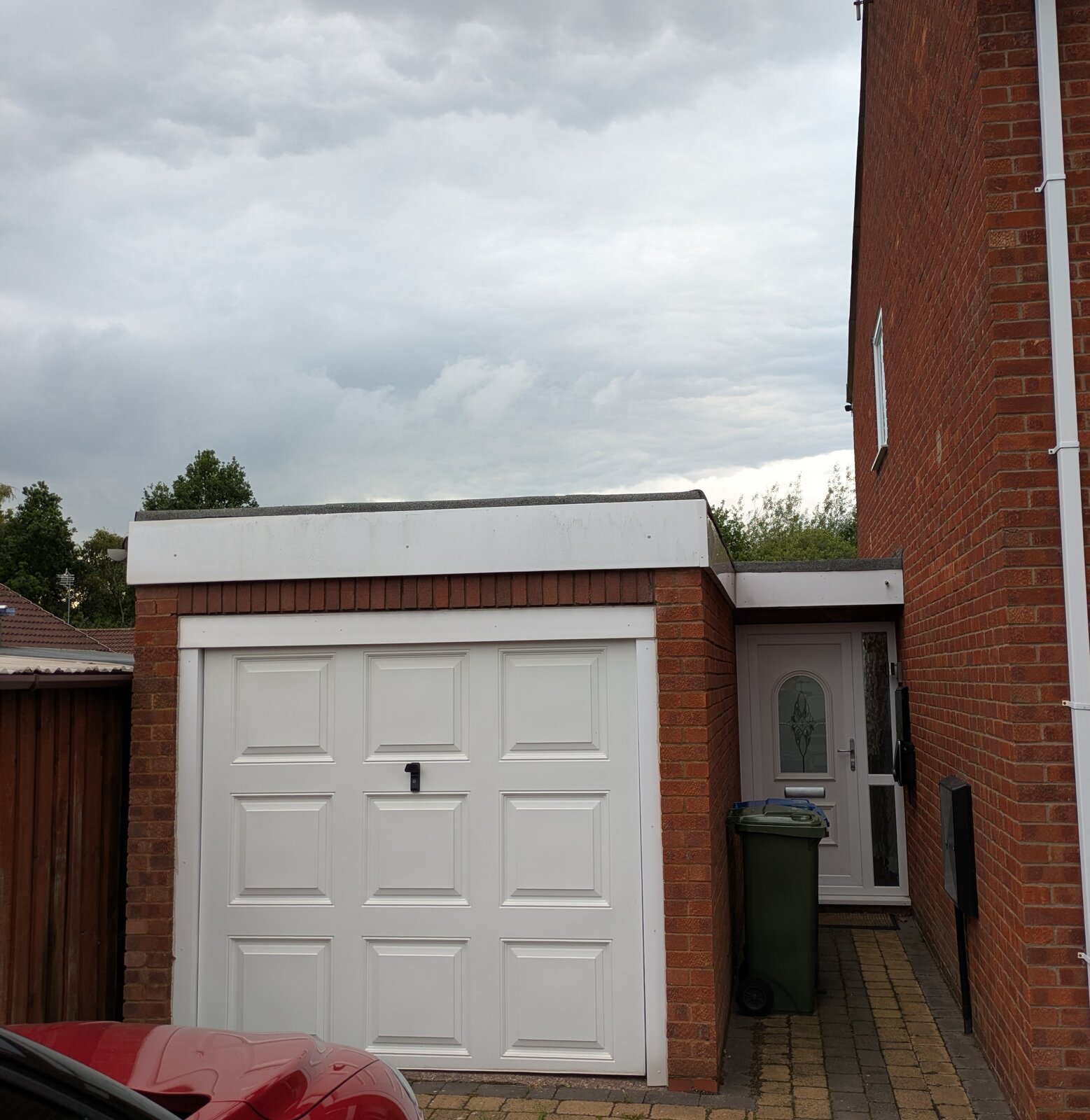

My single skin garage looks like this from the front (columns at corners are 1x1 bricks)::
From the back it looks like this (columns at corners are 1.5x1.5 bricks):

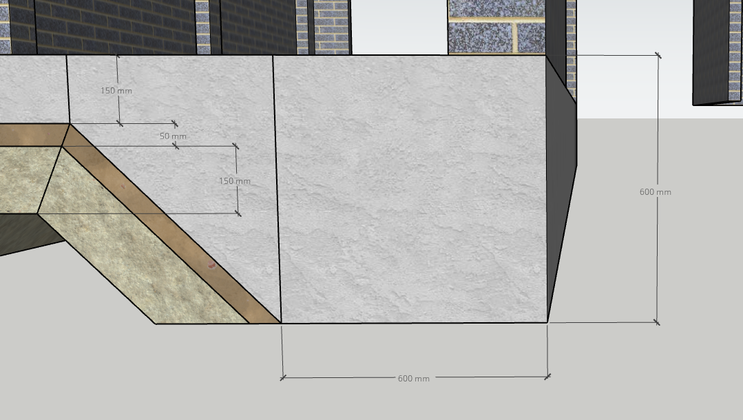

The existing raft foundation spec is this (main width and depth of the foundation is 600x600mm with 150mm slab, 50mm sand, 150mm compacted hardcore)

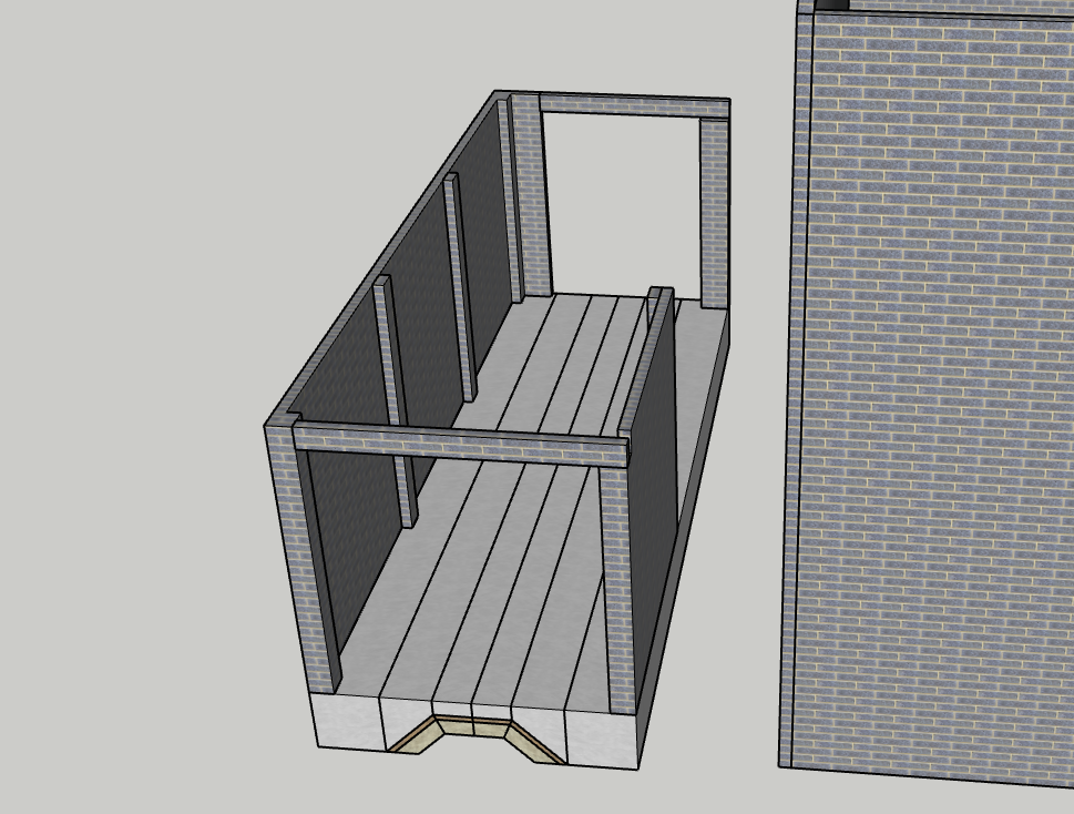

I'd like to look at options of building on the existing foundations and leaving the following existing brick structure:
The reasons for this are:
- There appears to be sound external brick with 4 good pillars, one at each corner.
- The existing garage door can remain/be reused
- The existing front door can be reused and brought forwards (for a longer hallway)
- Cleaner and less disruptive building works

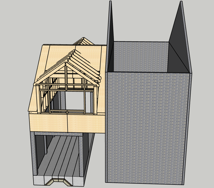

I'm interested in feasible loading bearing methods to have a timber frame dormer roof (with around 1m high timber wall needed) on top of this and which methods would be best. This is my rough proposed design. I'm assuming a lightweight cladding and I'm hoping for the main frame to level to the edge of the remaining brick below.

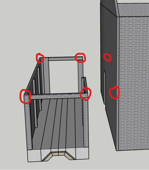

I'm assuming the following are sound areas for load bearing points (2 pillars at front, 2 pillars at back and appropriate connection to the side of the existing house):
Your plan sounds ok, but you will need structural engineer calculations to build, so they will be the best to advise.
Anything is possible and there are several solutions, a couple of threads that spring to mind though:
I'm sure there are plenty of others if you have a search. You may not need any steel columns, only your SE will be able to determine that.
It's probably inefficient to let let one wall of brickwork dictate the rest of the structure.
