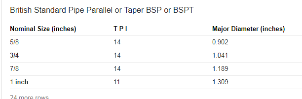

Just had my calipers measuring... 1 inch outside diameter, including threads, 3/4in inside diameter. Is that a 1 inch?

precise outside thread size is 1.025 inches. Judging by this article https://www.bestmaterials.com/PDF_Files/Pipe-sizes-threads.pdf it may be that a 3/4 inch connector will fit. Is that right?

Thread sizes in BSP bear no close relationship to their real sizes.

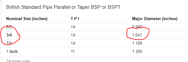

Quite likely the nuts you need will be called 3/4" BSP and were intended, long ago, to be used with steel pipes of 3/4" Internal Diameter. Their diameter, in that case, would be 1.041 inch (26.441mm)
https://www.valvesonline.com.au/references/threads/

What you have is standard bath taps, 3/4" BSP which measures 26.4mm O.D.
The 3/4 refers to the original inside diameter of a pipe with threads on the outside.
