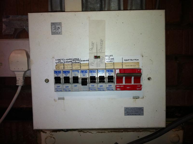

10.8kw showers and cables!
To be honest I hadn't considered it.
The last shower, fitted over 12 years ago, didn't have one.
I don't really know much about RCDs. Can you get combined RCD/MCBs?
I'll certainly put in now.
Yes.
These are known as RCBOs.
What is the make and age of your consumer unit?
If it is a split load board you will have an RCD (RCCB) protecting some of the circuits.
Unfortunately those circuit breakers are now obsolete, and there was never an RCBO made for that CU.
You could how ever fit an RCD for the shower in a seperate enclosure next to your CU.
You really really sohuld RCD protect this circuit.
Unfortunately those circuit breakers are now obsolete...
Oh hell. So I'm not actually going to be able to get a new one?
I'm jjst looking now and not having much luck!
No, you won't get an RCBO or an MCB.
Don't know of any current makes that will fit.
You could change the whole consumer unit that meets 17th edition, ie RCDs on all appropriate circuits.
Or you could fit a separate fuse board alongside. The usual way to do this is use an RCCB (rated at 63 amp or above) as the main switch, with a 45 amp MCB. Or a 63 amp main switch, with a 45 amp RCBO.
Normally an Isco block can be fitted between your meter tails, and new tails go to this enclosure.
Either way, not really a DIY job, but all in a day's work for an experienced electrician.
I think that most of your questions have been answered Dunce and it is all good information. Especially pay attention to "The usual way to do this is use an RCCB (rated at 63 amp or above) as the main switch, with a 45 amp MCB. Or a 63 amp main switch, with a 45 amp RCBO" and "tight connections".
The bit that hasn't been answered is about a 40 Amp Circuit Breaker which may occaisionaly pass 47 Amps. When the current passing through a circuit breaker, or fuse for that matter, exceeds the rating, it does not trip straight away. i.e. a 40 amp circuit breaker would not trip if 41 amps was passing through it. In fact the circuit breaker will take quite a large overload before it trips. The time taken for it to trip depends on how much higher the current is than the rating. So occaisional surges to 47amps should not cause a problem but if you had the shower on for an hour at 47 amps it will trip.
As an example a 40Amp,Type B Circuit breaker, needs 200Amps to pass through it, to trip between 0.1 and 5 secs. It should take 47Amps for about 30 secs before tripping.
