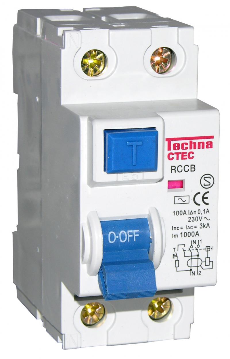

What device trips?
MCB
RCBO
RCCB
You will find RCBOs and RCCBs have a test button on them.
