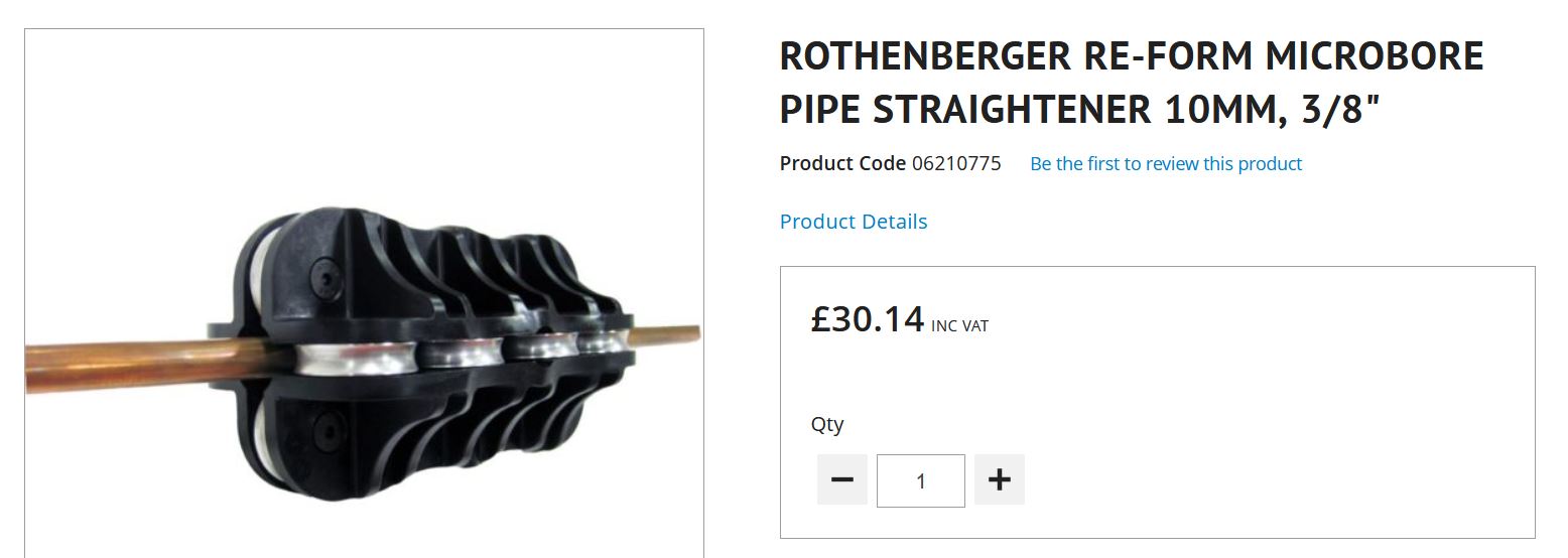

3) Find a way of straightening the horizontal 10mm and leave it all as-is. This is the cheapest option, but probably won't work anyway as the new radiator isn't quite the same size, so I'll need to cut/join/extend the pipes anyway so I may as well redo it properly anyway.
