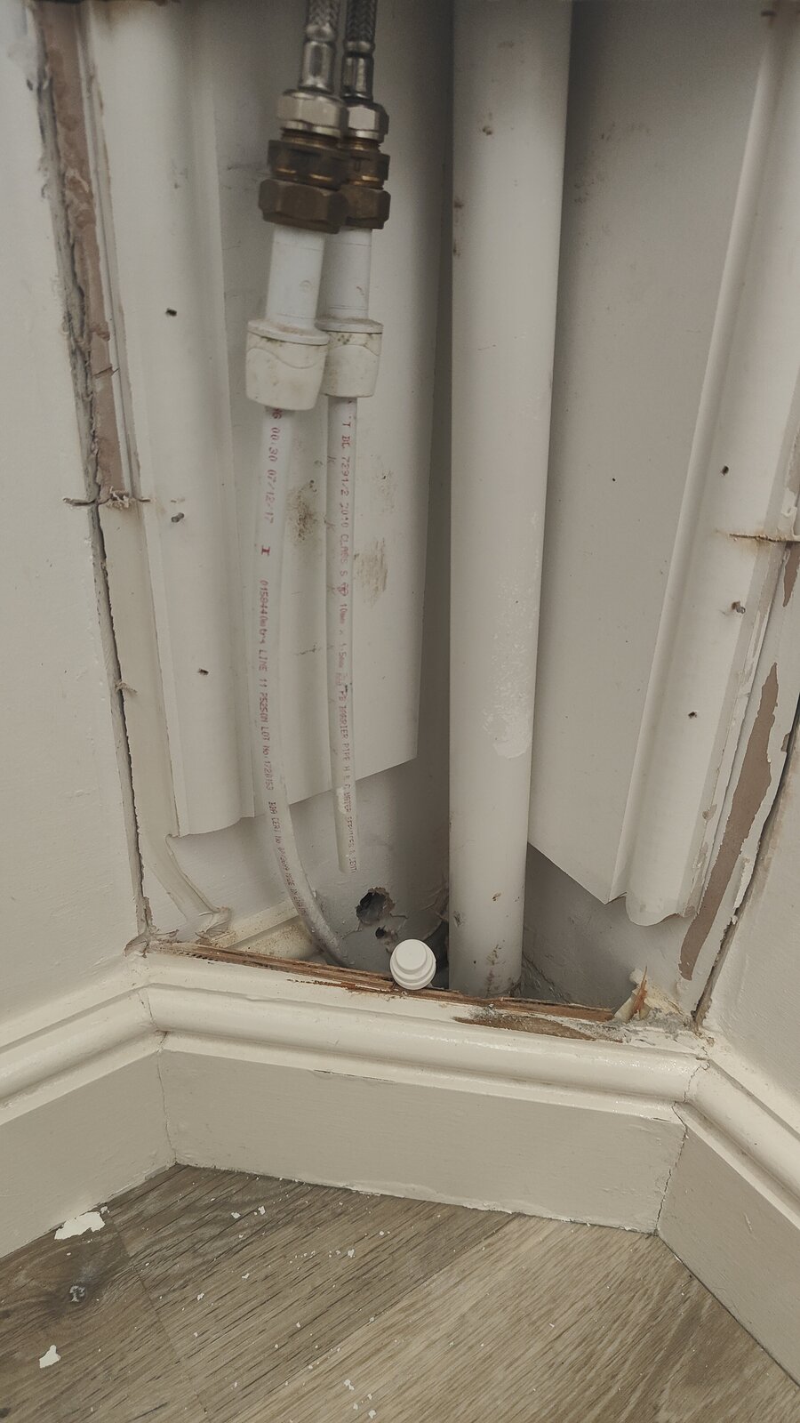

Divy here thought his cold water feed was 15mm.. so bought a 15mm - 1/4" reducing tee to plumb a fridge.
It's 10mm!! I've already cut it so stuck a stop end on.
What options do I have as I can't find a 10mm - 1/4" reducing tee...
Do I get some 15mm pipe and use 15mm - 10mm reducers ?

Unlucky but the clue is written on the side of the pipe in red ;)
Are you sure it's 1/4" and not 6mm? If it's 6mm you'll find some alternatives
If you can't find the right 10mm to 1/4" fitting then yes take the 10mm upto a small amount of 15mm and use the fitting you have, it's a bit of a cumbersome way of doing it but you can only work with what's available
