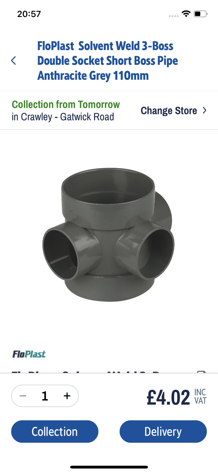

110mm boss socket cap
8 Jun 2010
320
9
Sussex
Does anyone know if I can source a cap for a 110mm boss? They supply the boss with 2 sealed and 1 open end and I needed to use one of the sealed branches and need to cap the other outlet. Cant seem to find one anywhere?
Thanks.
Thanks but can only find a rubber bung, where can I find a solvent adapter and cap?
Found the answer to this. They don’t make a cap so you need an adapter (sp21) and bit of pipe and cap (ws31). Or else cut it out and fit a new one!
Sorry Hugh, yep you were right but it was sourcing the right type of adapters that proved hard, phoned flopast in the end and got the codes even then Had to order online as all my local places didn’t have them, go figure?
