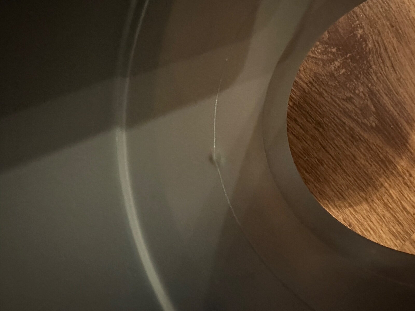

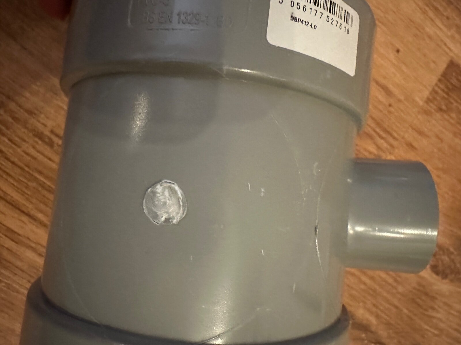

Sorry this might be a silly question. I’ve purchased a 110mm solvent Tee with a 36mm(32mm) Tee section. I noticed that on the body there is this little mark in the body almost like it’s part of the mold making process like the area it’s mounted and cut off or something. But directly inside of that mark on the inside of the pipe there is a dimple. Just wanted to make sure this isn’t defect that can potentially compromise the fitting. I’ve attached two photos (one of the outside and the other of the inside showing the little dimple indentation)
Thank you
