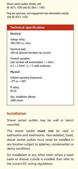

I can but presume that it actually is isolated (particularly given that the spec indicates a 200 mA max load)? I ask, because the technical data sheet for it says (my emboldening):
Non-isolated, fused, shaver socket outlets must never be installed in any location subject to splashes, condensation or damp conditions.
... which seems a bit odd!
On the web page it says "INCORPORATES A SELF-RESETTING OVERLOAD DEVICE, LIMITING CURRENT TO 20VA". Never knew that that was the dimension of current.
What seems odd to me is that they should feel the need to limit the current drawn to 200mA when there's no transformer to overload.
And if the instructions are to connect it to a lighting circuit, what's the fuse for?
I never knew that, either, but I was quoting from:
If there's no transformer, then I agree. Maybe they're just trying to deter people from plugging their fan heater into this 2-pin socket 'on a lighting circuit'
Unlike the page to which eric linked, the spec sheet I'm looking at (as above) doesn't mention lighting circuits - but, in relation to the page which does say that, you tell me!
If you recall, the man at MK did tell me (when I was asking about double socket 'ratings') that the marketing department wrote many of their 'Technical Data Sheets'!!
Kind Regards, John
I wonder if BS 4573 / IEC 60884-1 only requires the plugs to be capable of handling 200mA?
