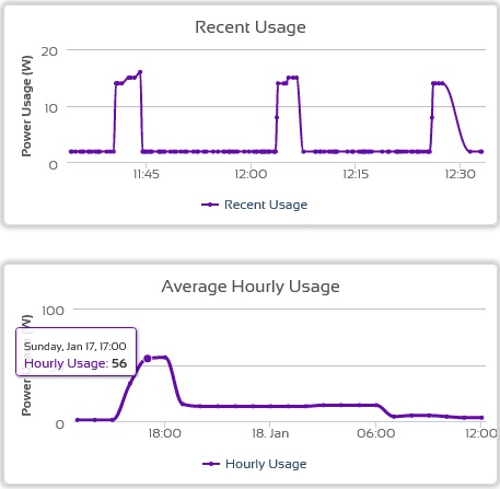

I put my car on charge around once every 4 months to ensure the battery is fully charged, I use a Lidi smart charger so can walk away and leave it on charge, but using an energy monitor I get Honda battery third pic switch on..jpgand over time the high charge rate reduces and the low charge rate increases, and because I have done it many times, I can look on my PC and say to myself that battery is as charged as it's going to get.
This one was my kia battery, 18th Jan 21, it failed early this year, likely some 20 year old, the bottom you can see how most the charge went in quickly, but 6 the following day before it dropped to a low rate, and top one shows the pulses it was getting to maintain it so 12 hours latter, does not matter how big the charger, the battery can't absorb charge quickly it takes time.

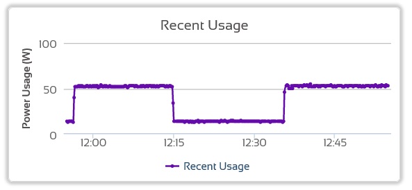

With the smart charger powered from a energy monitor one should see on the PC what power is required to maintain the battery.

But simple maths, 48 amp hour battery at 0.1 amp will last 20 days. Although not enough left to restart a car. But my charger at lowest rate is 0.8 amp, and it shows charging around 50% of the so can expect it to be half charged after 20 days.
The problem is the time it takes to recharge, with the hydrometer one can see state of charge, but using voltage not so easy. If it takes a battery 10 days before it accepts a charge after being left abandoned, we can assume it can also take that long to revive a battery that has been repeatedly only half charged.
The charger will not show half charged, neither will a volt meter, the volts will go to 14.4, drop to 12.8 then back to 14.4 many times, each time a little more charge accepted, if one knows the vehicle and battery the mark/space ratio may tell you something, but only real way to be sure fully charged is to leave on charge with a smart charger for 14 days.
