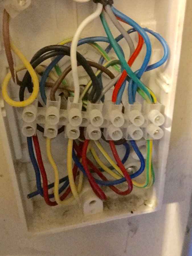

Post a pic of the airing cupboard showing the pipe layout and motorized valves.
Also post a pic of the 10-way junction box with the lid off, so we can see the wiring.

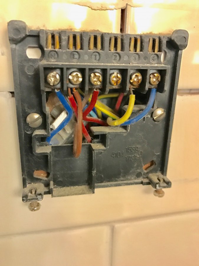

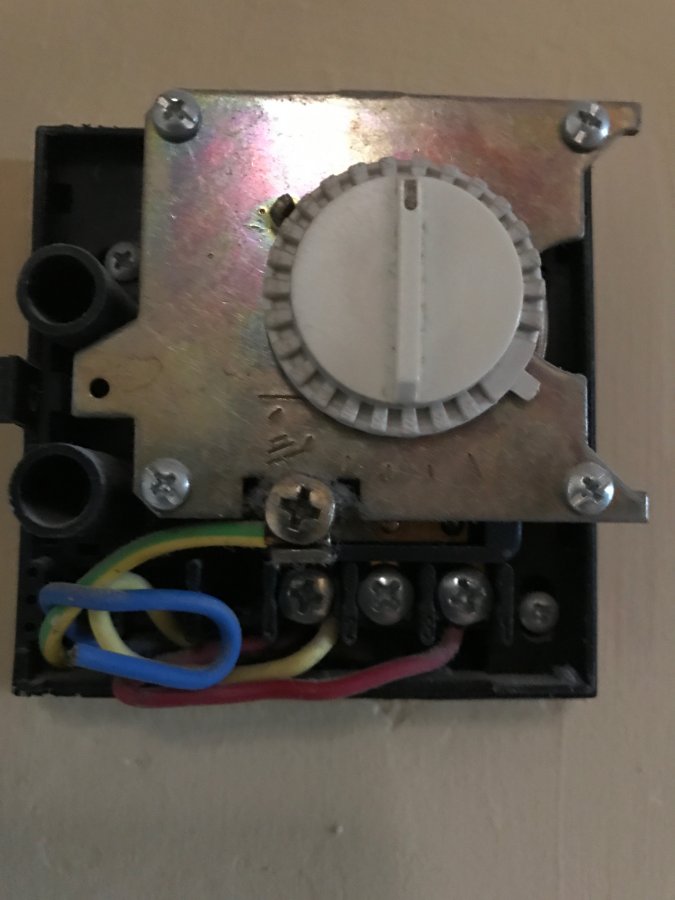

Some Photos enclosed & I can't count!!! It's an 8-Way TB. The Valve is a BGMVSP-23 Mid Position Actuating Valve

The OP needs to trace all the wiring before deciding what to do. Programmer near boiler, thermostat in hall, wiring centre (seven! terminals) etc upstairs all say that there are a lot of wires running backwards and forwards. So it's more than just fitting the Heat Link in the place of the programmer.
Cheers...There's an 8th one all by it's lonesome, in the Top LHS of the JPEG.....Original Installer must've Cut it Off to fit into the JB....
I did wonder if that was another terminal block, but concluded it wasn't as there was plenty of room for an 8-way or even 10 way strip if installed vertically (or the box could be turned to landscape orientation).
