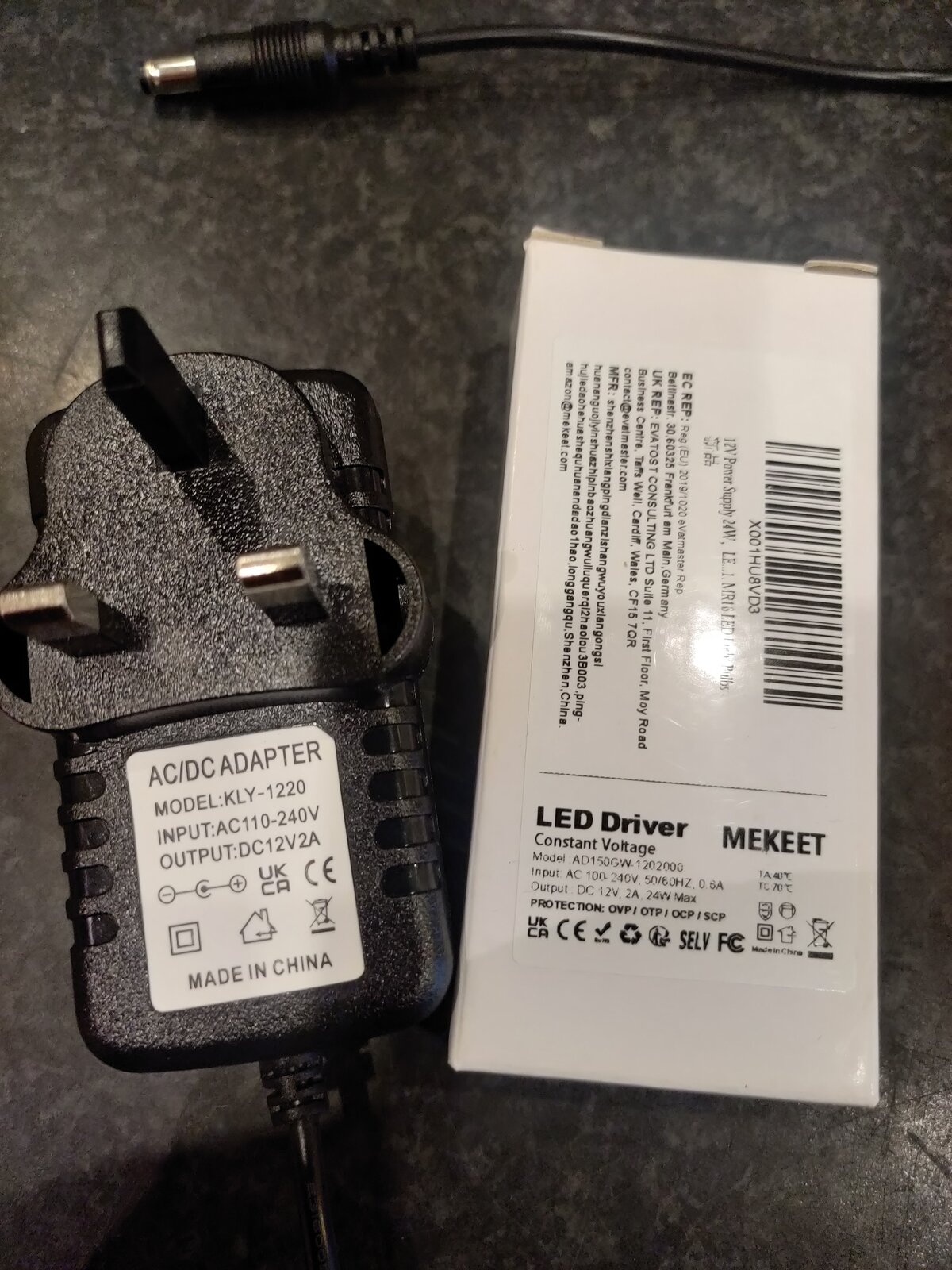

I've a set of 12VDC LED lights which are powered by the plug in PS on the left. I don't want a plug in, i want a permanent PS so i got the PS in the box on the right.
The lights won't work with the new PS. Nothing. No lights, flicker, etc. I tested the output of the new PS and its 12VDC.
Is this constant voltage vs constant current thing?
Should i have got a 12VDC halogen light driver? (Constant current?)
What am i screwing up?
Comments appreciated.

The wall wart isn't a transformer (although it will contain one inside). It is a 12V DC power supply. So is the white box.
Wrong polarity is the most likely issue as ETAF suggests.

Officially a driver is current controlled, however it seems anything DC today is called a driver, and the correct replacement has been got, both 12 volt both DC and both 2 amp so it should have worked OK. But polarity does matter so that seems most likely error.

The terminology in this area is totally confused and confusing (and includes a good degree of ignorance on the part of some manufacturers), but the "LED driver" pictured says that it is a "Constant Voltage supply with an output of 12V 2A DC, which is the same as the original PSU.
Other things called LED Drivers" are constant current ones - and supply different voltages according the applied load.

If you have a "A set of 12VDC LED lights ", all that you need is a "Supply" which will provide 12 V at up to the current required by the Lamps concerned.
(UP TO 2 A, in this case.)

Turns out, i had done exactly that. Wrong polarity on the connection to the new PS output.
Having corrected this, it now works.
