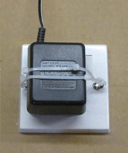

Indeed - I always label such sockets appropriately. As I have illustrated before, in the case of things permanently connected via wall warts (which is the most common reason for needing 13A sockets in a loft/roofspace), I sometimes do something like this - which ought to stop all but the most determined plugging in their vacuum cleaner! ..

If you are in a strange building how is one to know if the 13 amp socket you want to use is wired to the lighting circuit?
The regulations required such sockets to be labeled. If you ignore the label you deserve what you get.
Require or required. Either way John's socket above is not labelled, as I suspect most are not.
"Require"" (it was a typo). What you say is not relevant. A socket on a lighting circuit is permitted, if it makes design sense to do that, provided it is labeled.
It is ('labelled'). The labelling is underneath the wall-wart, so anyone daft enough to cut the cable ties (or remove the faceplate screws) and remove the wall-wart will then see the label/'warning' right where they might be tempted to plug something else in!
