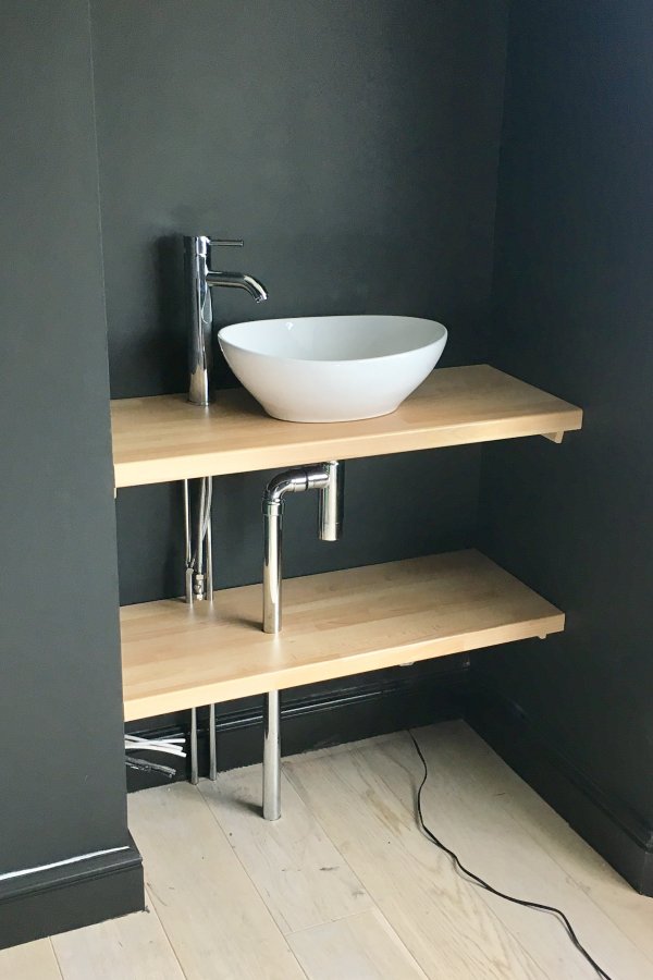

I have built a shelf for a countertop sink and tap to sit on. All the pipework is exposed. It's all chrome and very neat so looks pretty cool (IMO)....however the taps connectors are 300mm long and (IMO) look a bit crap.
150mm flexible tap connector would be sweet...they'd tuck in nicely under the shelf. However, they don't seem to readily exist. Found a single one on eBay for £15 and £20 delivery!
Can anyone source them? Or think of an alternative?
Loads of 150mm tap connectors on Amazon. Just not the type I need.
Forgot to mention it's an M10 connection into the taps. So I need M10 to 15mm flexi connector.
Might be worth considering replacing the flexis with copper M10 x 15mm tap connectors (e.g. https://www.bes.co.uk/copper-monoblock-tap-tails-m10-x-15mm-19800). You could shorten as necessary and get them chrome plated (very expensive, last time I had it done cost was £75), or use chrome pipe trims on the full width 15mm part.
An alternative might be to use chrome plated 22mm tube over the pipework before and after the isolation valves.
