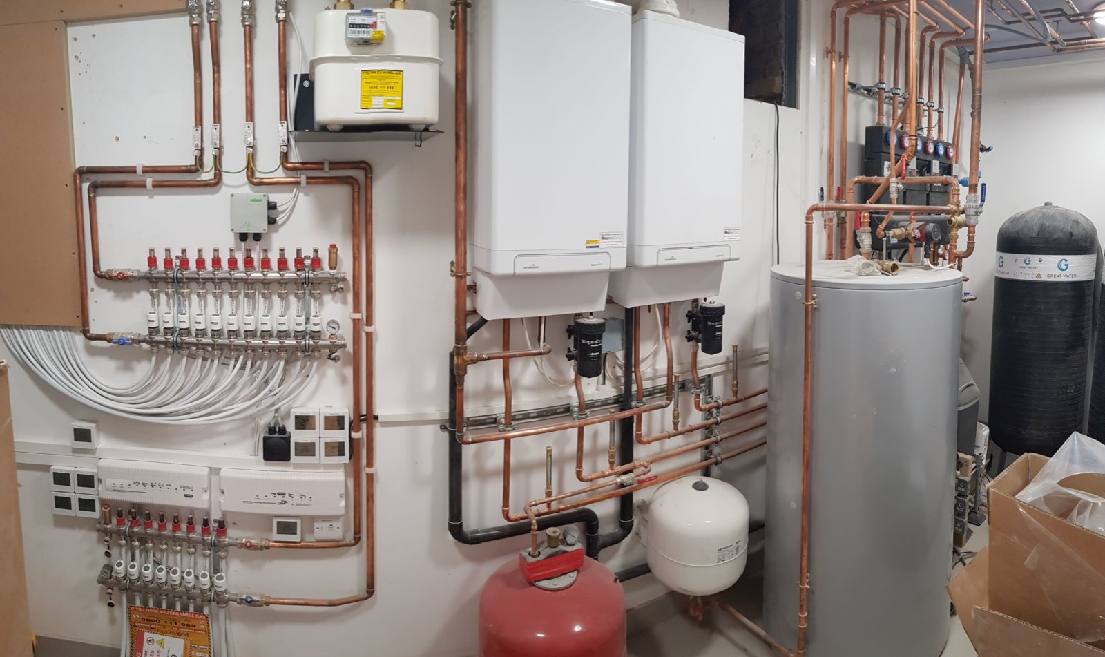

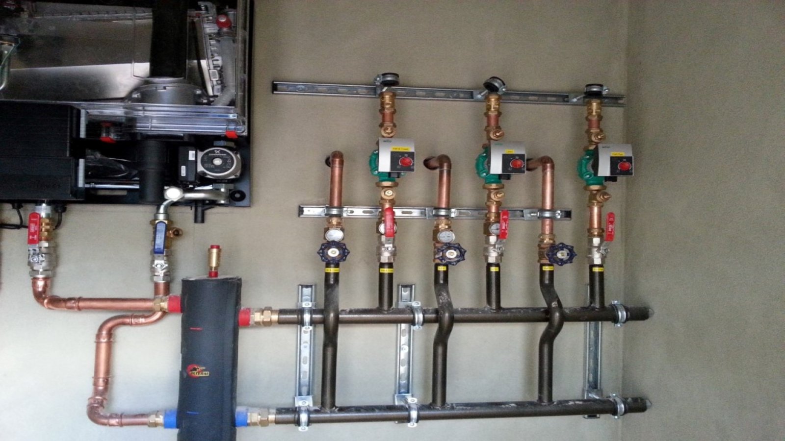

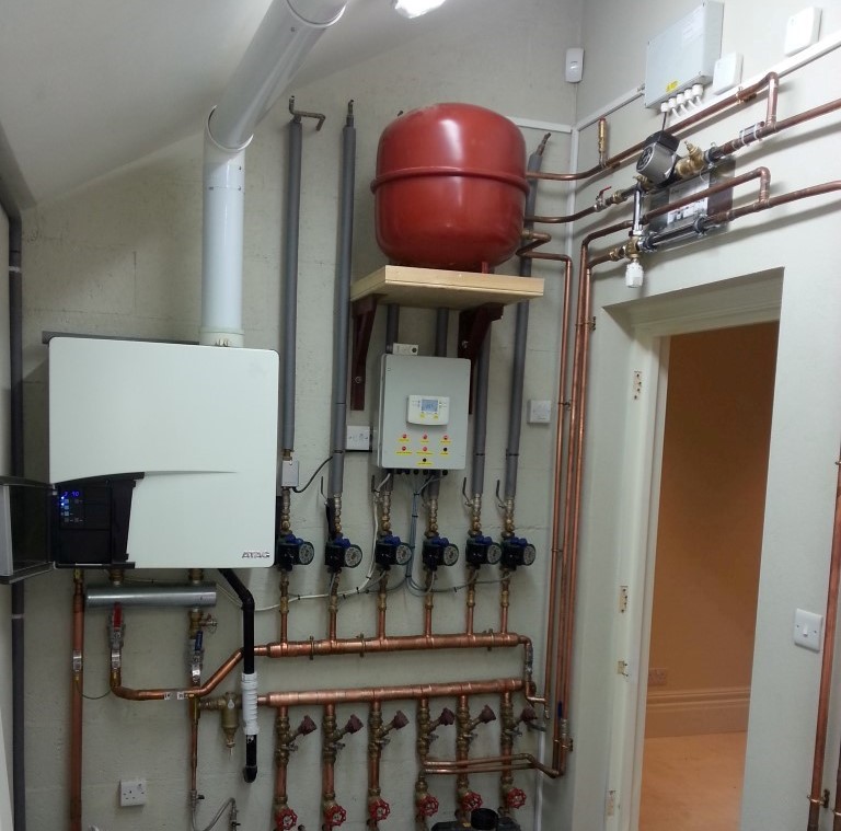

Here's 2 we did a couple of years ago:
Prefer to do multiple boilers now though where there's space:
