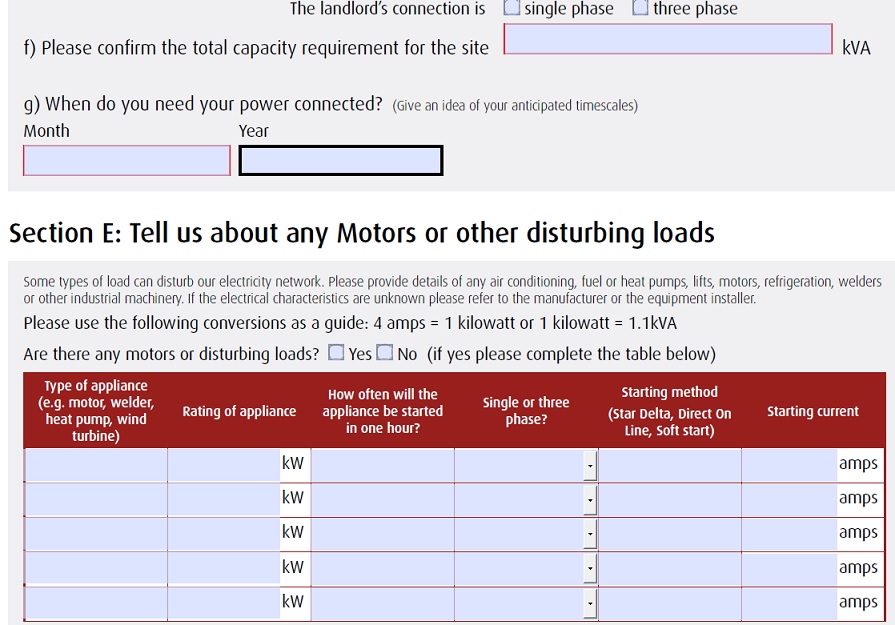

Be aware that using a welder on a domestic supply is likely to be in breach of the contract with the DNO
They can ( and often do ) cause voltage dips in the local supply network and neighbour's complaints to the DNO can lead to an instruction to cease using the welder or risk having the supply disconnected.

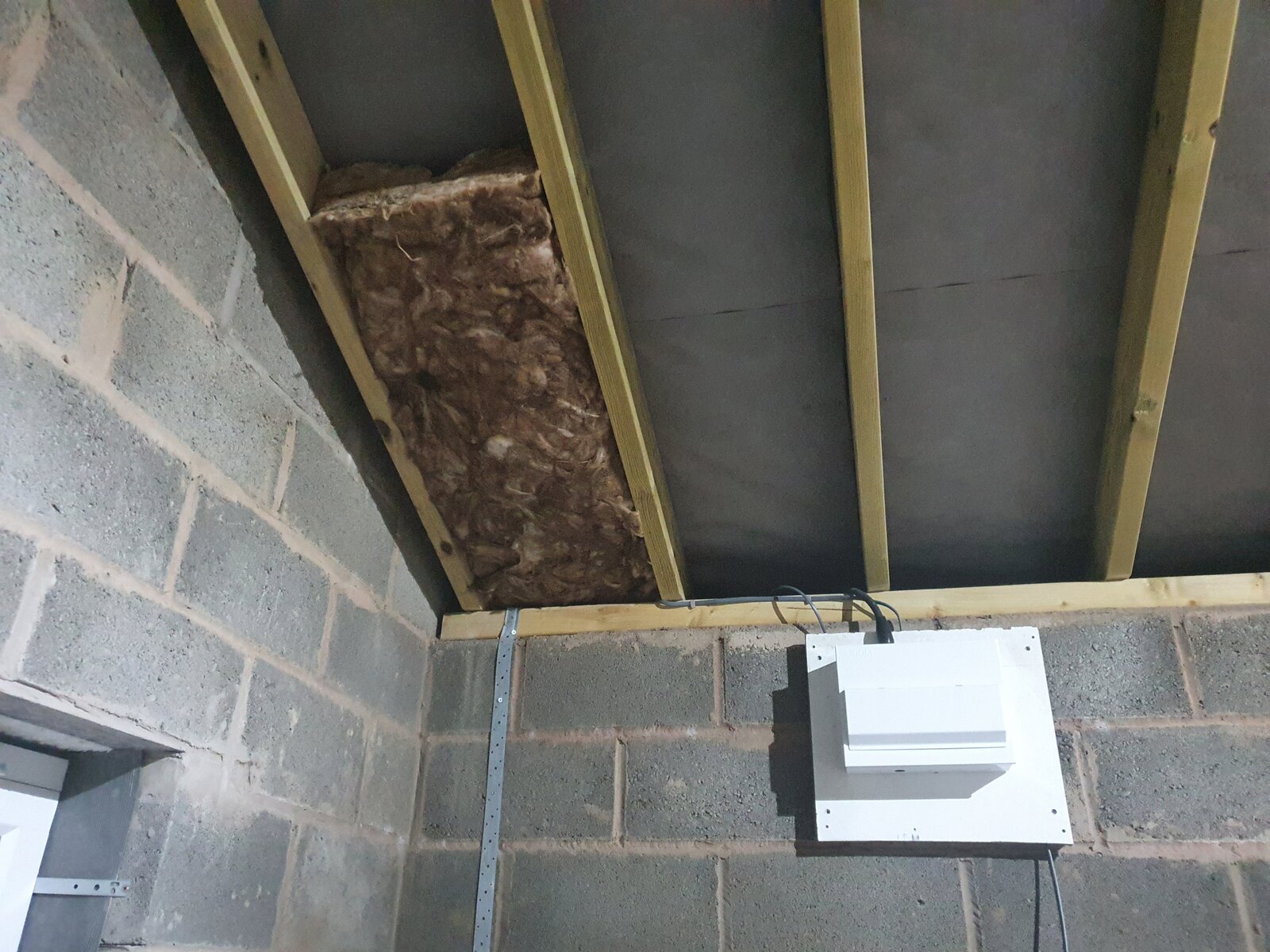

Need a little more information. How is the garage supplied with power. Is there a separate MCB in the house consumer unit? What value is the MCB?
Or is it supplied from another circuit in the house, perhaps through a FCU?
It is supplied by 3 core 6mm SWA. It is connected in the house to a 40amp MCB.
The garage has a metal clad split load RCD CU

So then it is not a spur then is it, It is not on a ring 'main' Is it.
Attached to the CU fused down to 16A in the garage will be fine.
The reason for my first question was I was hoping to save on cabling by spuring it. But as you said that is not good practice I will now run it as a separate circuit
