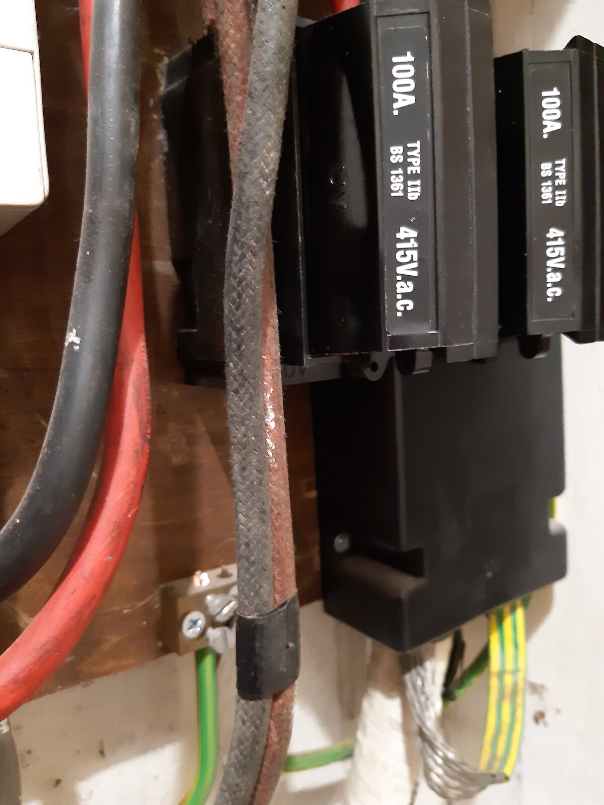

16mm Tails feeding next door?

The woven cotton over the top was waxed, to protect the more delicate rubber underneath. The rubber had a tendency to dry out and become very brittle, but only where the cotton had been cut back. A few inches back, where the rubber was protected by the waxed cotton, it would often be absolutely fine.
Apart from the VRI/VIR, which was normally protected by conduit, or wooden trunking in very old installations, there was a cable around the same time period called tough rubber and one called lead sheathed (rubber insulated). These were the predecessor of the modern twin and earth PVC, used for similar purposes.

DNO guy arrived & looked at cables. Said they are OK for now, but need replacing, he also removed the 2 100a fuses, & fitted a 60 in mine & an 80 for next door. Said the cables are fine for the moment but have a tendency to crack when moved, so he is putting a request through (Not urgent) for next door to have a new feed of their own. Said the work is free, but when electric vehicles become popular they may (No doubt about it) make a charge for the work.
... Said the work is free, but when electric vehicles become popular they may (No doubt about it) make a charge for the work.
Interesting - that rather sounds like the opposite or what one would expect!
