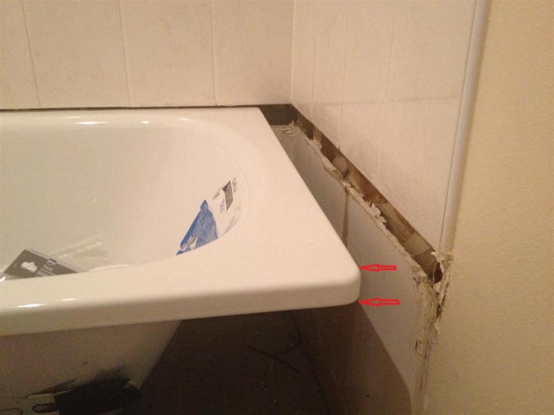

(2) With the new bath I have 75mm gap and was wondering what is the best way close it off?

For the gap, i'd construct a little shelf out of wood framing, pop a bit of hardiebacker (cement based sheet) on top of it, then tile it up, sloping back towards the bath. Make sure the gap is at the non-taps end to minimise chance of leaks.

regarding the gap, does the frame I need to build be as high as the top or bottom edge of the bath as shown in the picture?.

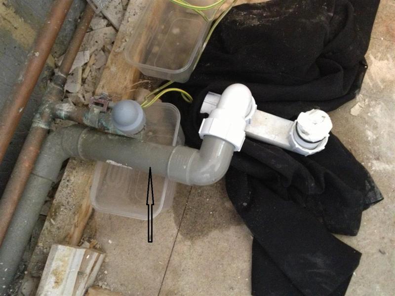

I have another problem with the waste pipe, The waste does not seem to come far enough to fit properly to the new bath It looks like the the section arrowed in the picture needs to be about 40mm longer . I tried yanking but it wont come loose .... do i need to cut some of it and use some sort of push fit tubing?
thanks
