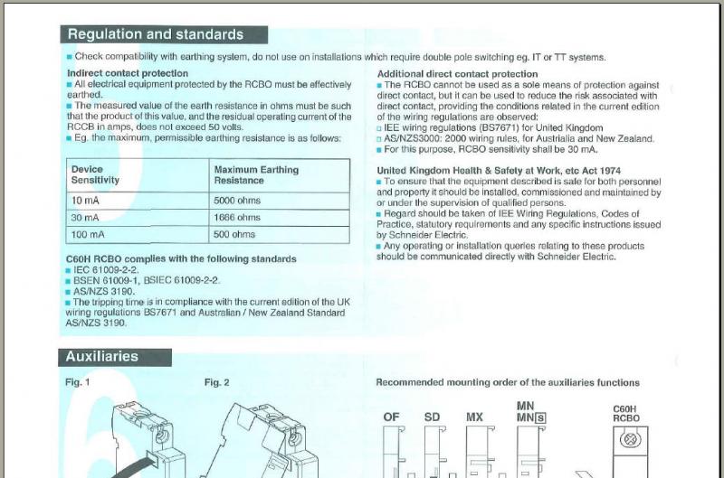

• Meets all parts of 314 for TN installations.
• May meet all parts of 314 for TT installations as long as a 100mA TD RCD is not used as an incomer. However, Merlin Gerin don't agree and their RCBO's can't be used on TT installations.
