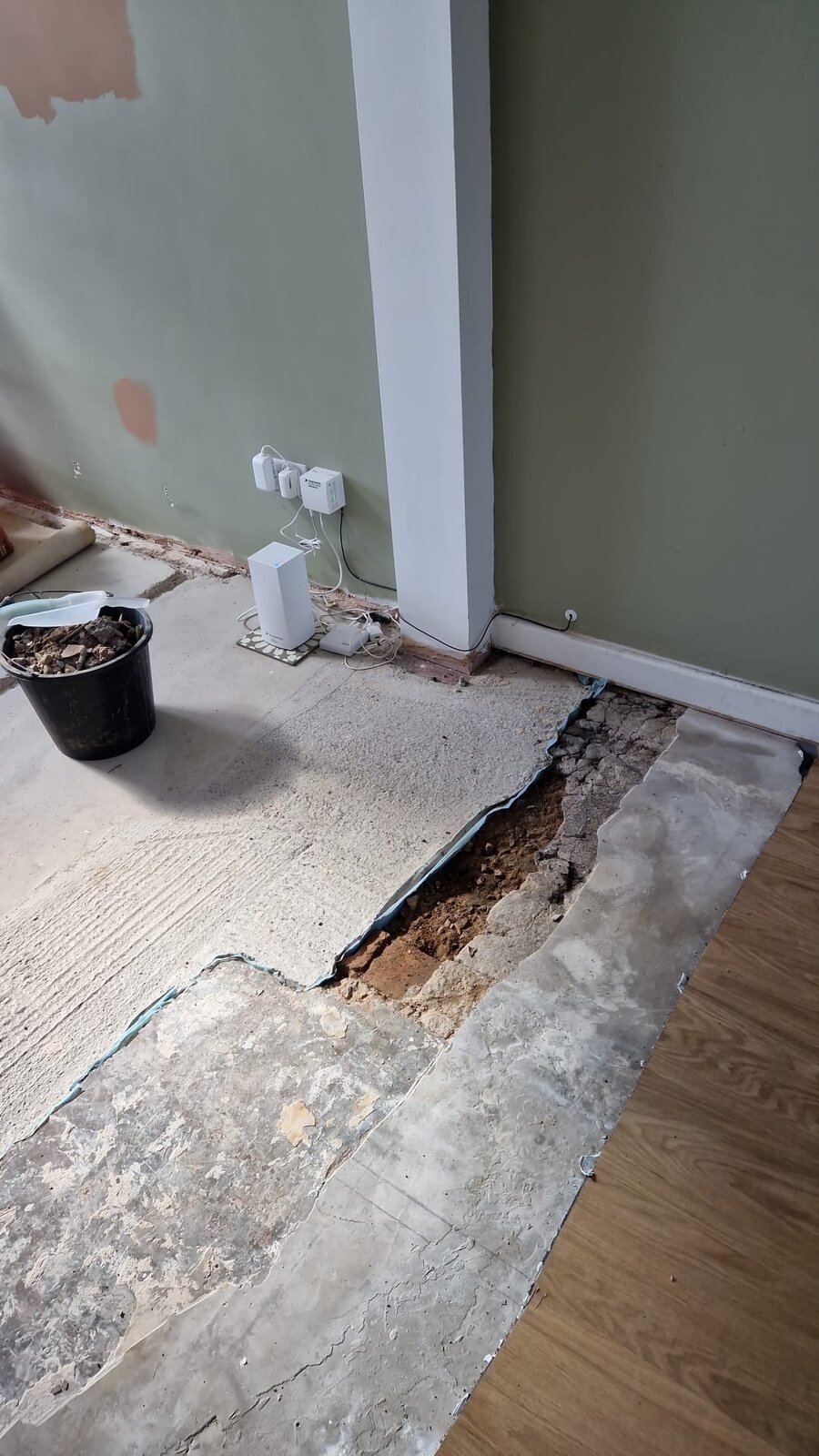

One of my kids has bought an ex Local Authority house. The previous owners built an extension which was 99% finished when they sold it. Just a bit of floor levelling, paint and flooring to be done.
The original house floor and the extension floor are not at the same height, only a few mm here and there, hence the floor levelling needing doing. I decided to chip away some of the old flooring to level it out a bit more and soon found myself unearthing damp rubble and dirt along and close to the old original wall area.
When they built house 80 years ago, did they spread a relatively thin concrete layer, an inch maybe, as the floor?
Might what you are finding, be rubble between the original cavity walls? What is the construction of the rest of the house floors, built on a concrete slab, or does it have timber floors?

If there's no DPM you'll have to dig it out and put one in. Whilst the property might be in a location where a inch of concrete over rubble might be enough to stay dry, it's not good practice and you might as well insulate the floors as you're messing about with them.
It might be that someone infilled the original suspended floors at some point in the past, or more likely it was built that way. Shortage of building materials in the 1940's for obvious reasons, also houses being thrown up quickly to meet demand.

Almost certainly, it will have been built with one, but what is the wall construction, of the outer walls - brick?
Show some photos, of the base of walls, outside.
Im not there at the moment ,but from what I recall, there is a series of holes just below the render line, so a dpm was injected I guess. I thought Deluks was suggesting putting a DPM over the whole floor after digging up the top layer.
The outer walls are rendered.

I've got a picture of the problem area. It's inset from the original walls, which would have been where the encased steel is on the wall. There is a thin screed on top of a crumbly, black 'concrete'. You can see it by the wall. I'm now wondering if this is just painted on bitumen, if thats how they did it back then.
Not clear on what your mention of 'encased steel' was about, but....
My guess as to what you have, is a large concrete slab, upon which the house has been built. On top of the concrete, has been poured hot bitumen, which produces a flat floor. The other possibility, is that a strip foundation has been laid, walls built, then an infill of concrete between the walls, finished with bitumen.
Have you an sds drill? You could pick an area of floor, and drill it, to check how thick the slab is? You will need to reseal the holes.

I do have an SDS drill but my plan was to chop back a bit more of the surface, which appears to be a smooth layer added more recently, to see what's underneath. Your idea might be better.
Will probably pull off some more of the laminate to see it the flooring surface changes further into the room. I'm guessing the 'builder' who did the extension patched up areas.
