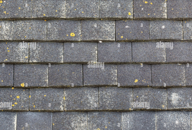

Hi there could someone tell me the correct name of these external tiles I need to replace some which have dropped. There on the front of my 1960s property
Redland concrete plain tile , original colour was dark slate.
Colour no longer available , 02 brown will be the closest you could get, or a Marley antique brown might be of use
