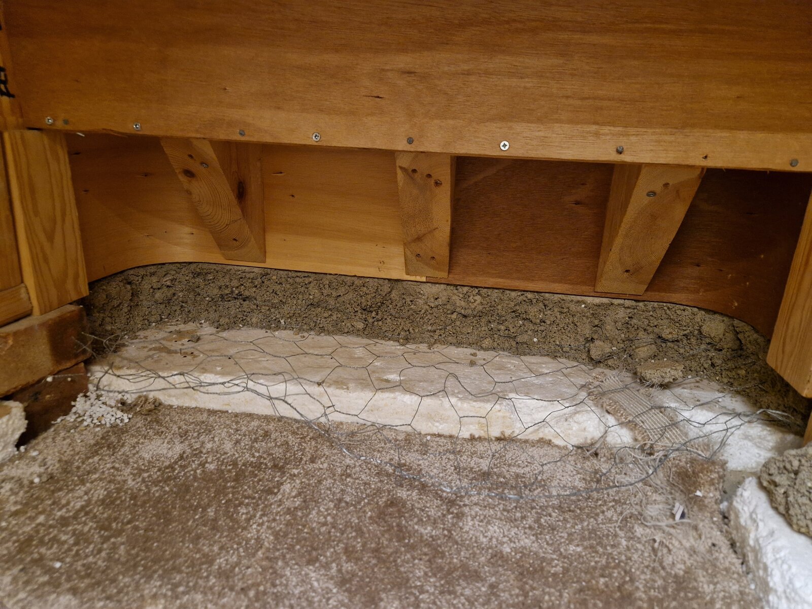

1st landing step squeaky, no support under
18 Aug 2008
42
Kent
My 1st landing step is very squeaky
It turns out it has limited support under
As concrete got milled through out the years
What is the fix?
See video an picture
On the inside under stairs.
Screw and quality wood glue some vertical wood strips (legs) on inside of first step.
Make blocks and glue and screw under stairs to make solid.
I've had to remove steps to get under to fix stairs like that. If you can get under it's much easier and just use common sense.
Probably made on site Vs buying as a kit?
Who knows..
Just strengthen
