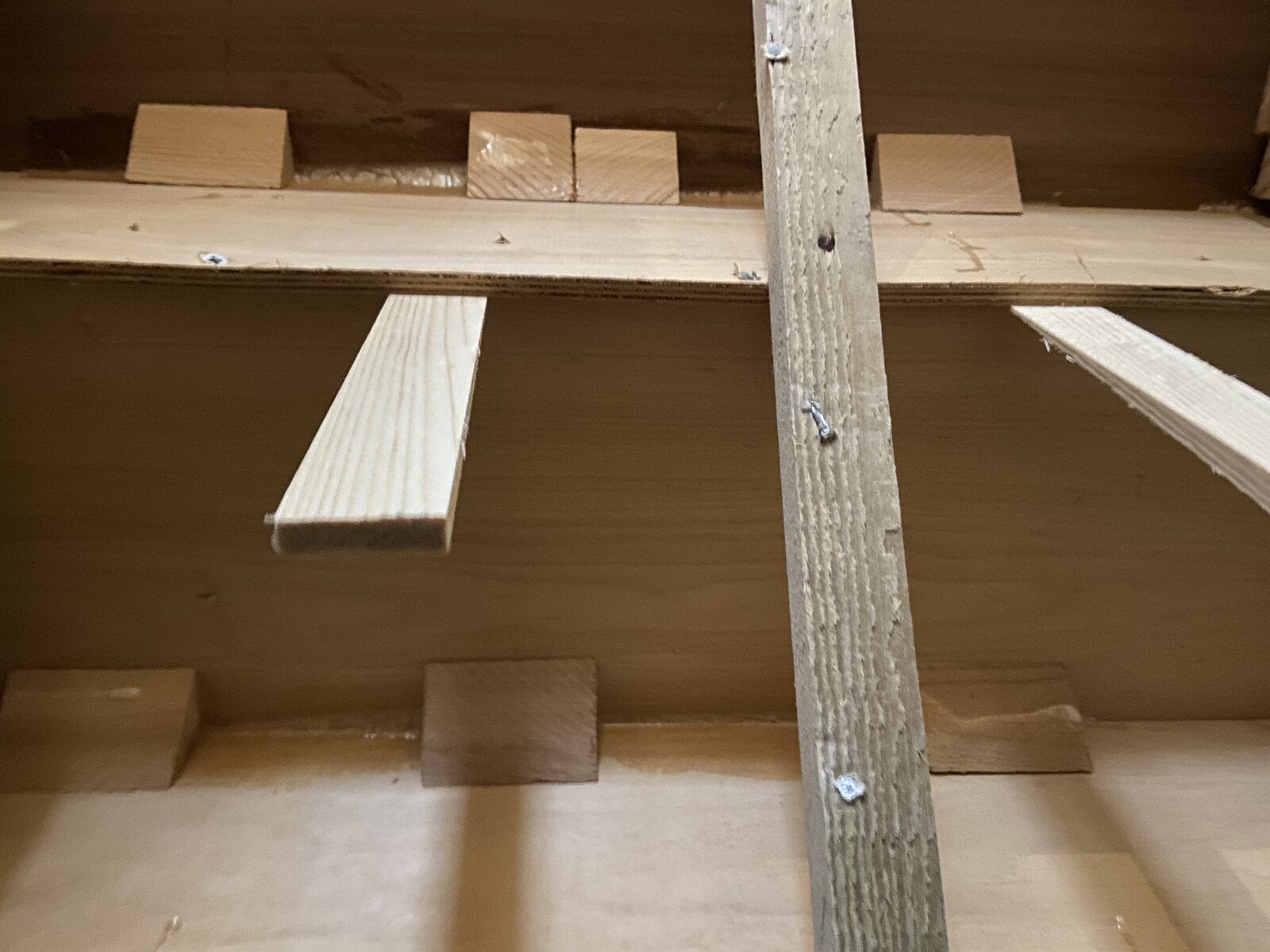

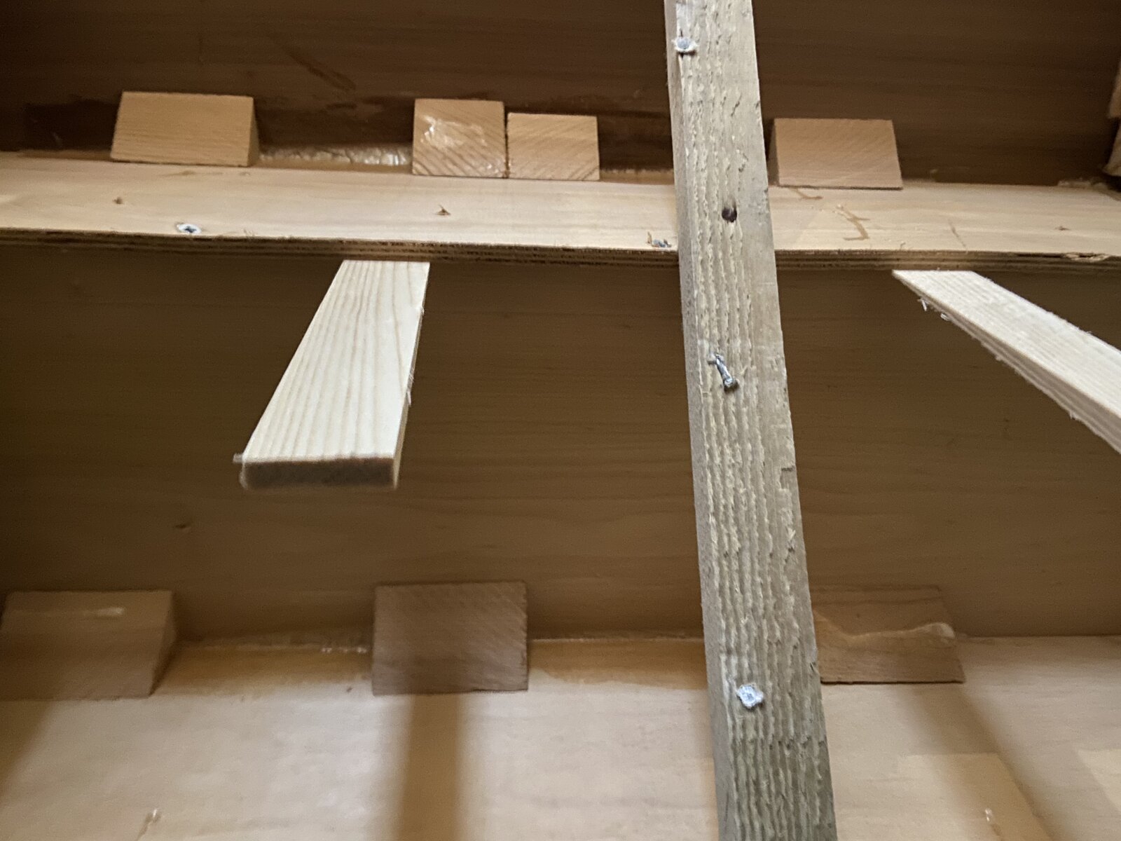

Hi
I’ve had a look at the stairs and looking for more advice.
from the underside the issue seems to be movement between the step and riser, someone has previously attempted to glue and screw but it’s failed, I’ve been able to tap a wedge between the two.
I’ve attached a photo, does anyone have any suggestions?
thanks
Would it be worth adding a supporting timber the width of the step on the underside?

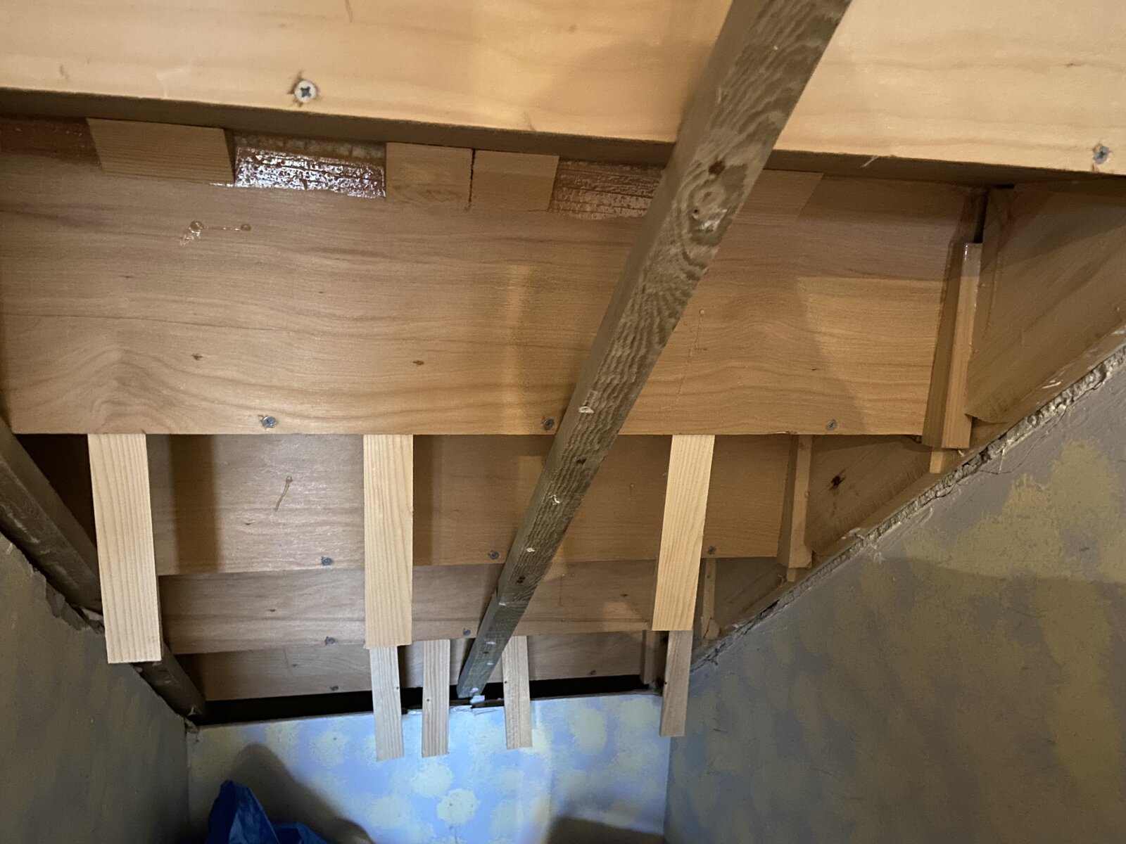

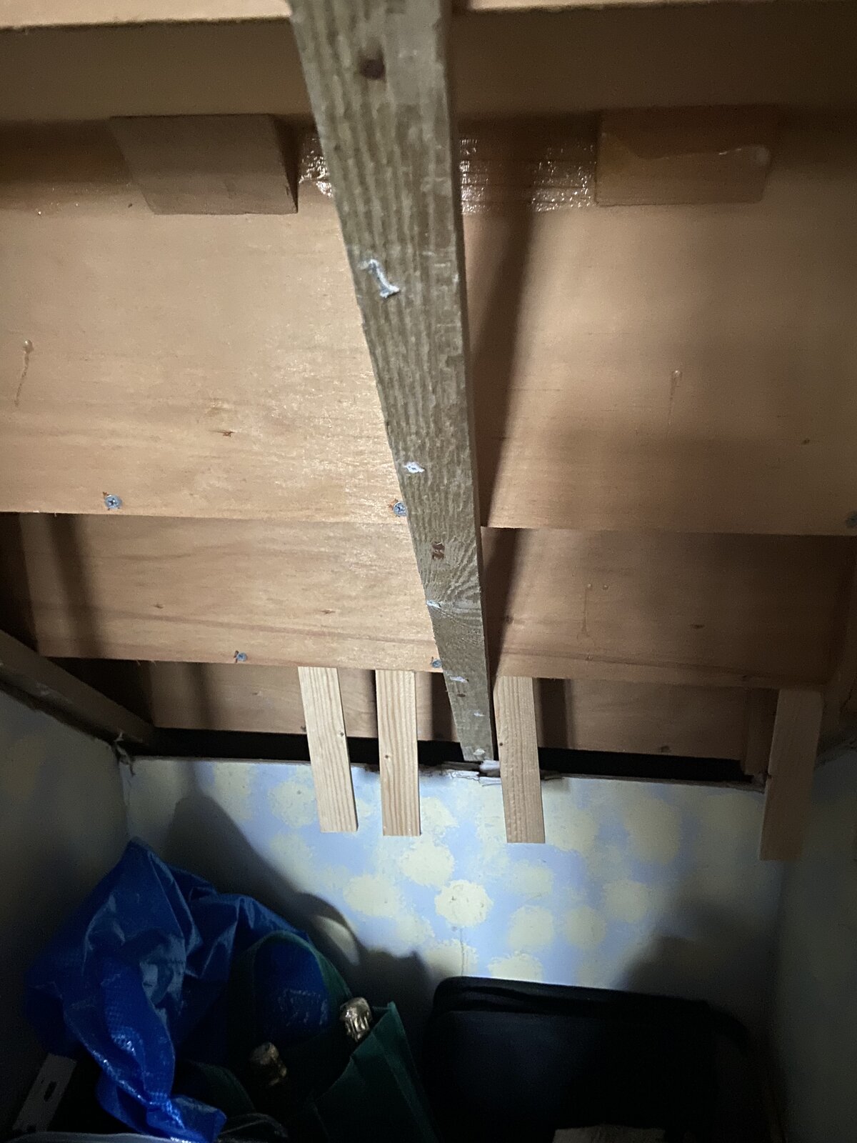

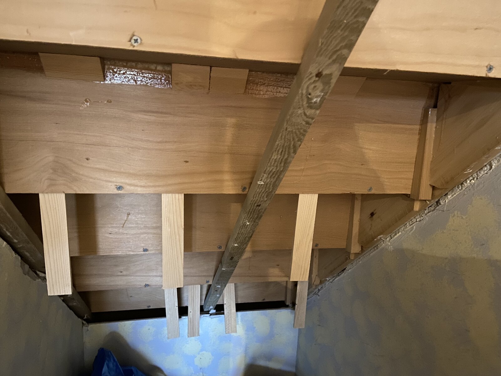

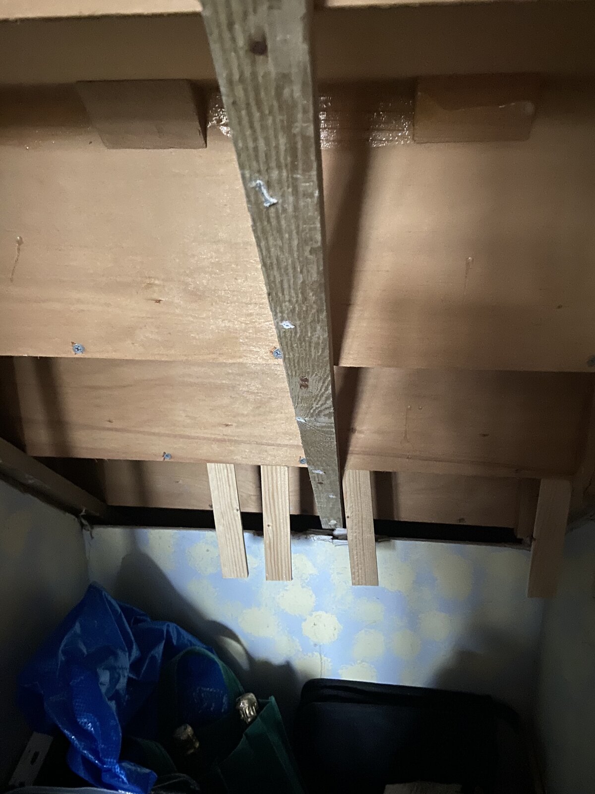

couple more photos
