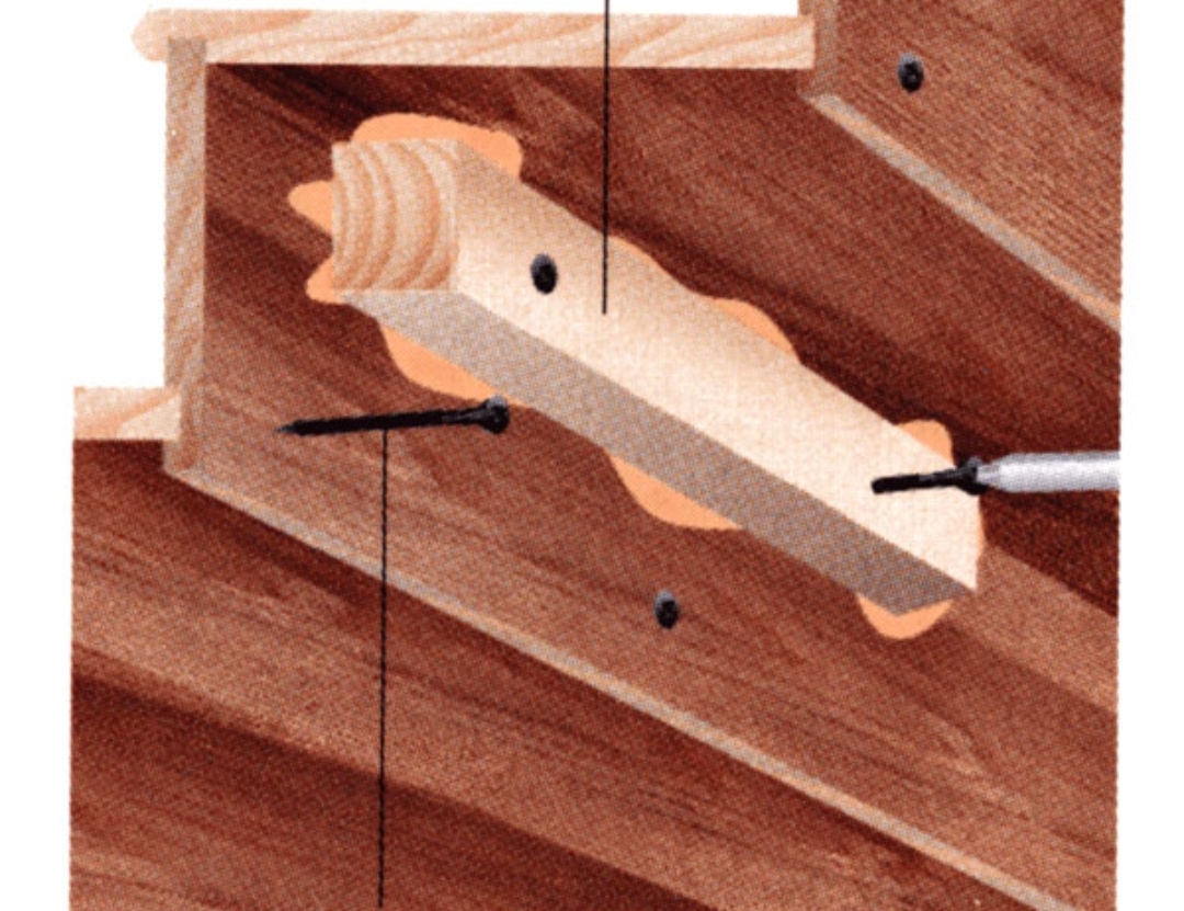

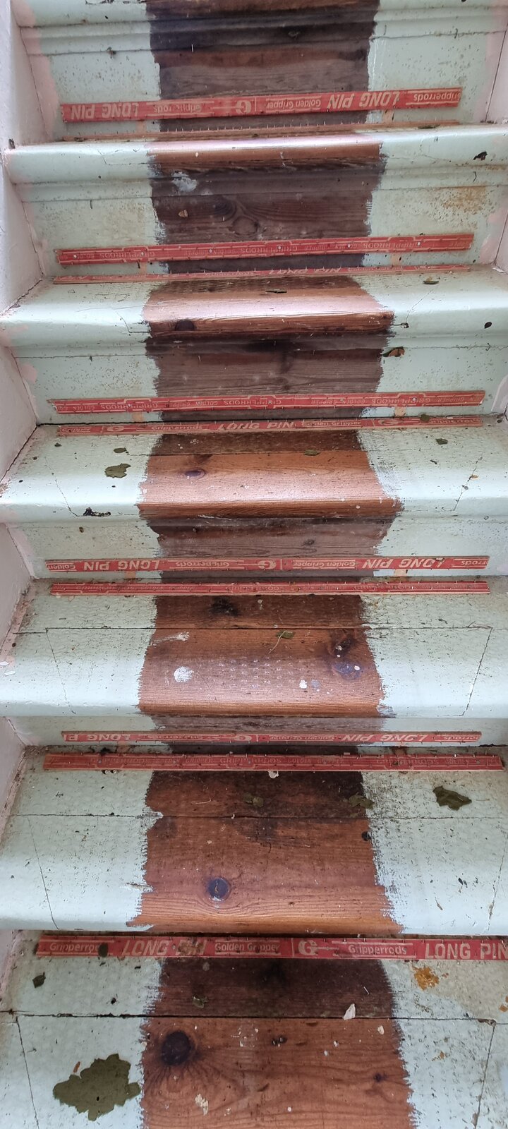

I have squeaky, old stairs. At least 100 years old and repaired / new treads added in a odd way.
Each tread is now made of 2 pieces of wood and moves/squeaks independently of each other.
Plan is to cut 18mm ply and glue and screw this to the underside using this https://www.screwfix.com/p/evo-stik-polyurethane-wood-adhesive-310ml/40778
Once done, then add 44x44mm batons glued /screwed through the ply and tread, and glued / screwed to the risers. This is to replace the missing glue blocks and wedges.
Like this but up into the tread as well as into the riser.
Finally glue and screw more batons to the ply and stringers to support the ply.
I'm hoping this will sort out the creaks.
Questions:
1. Is the EVO-STIK POLYURETHANE WOOD ADHESIVE a good choice of glue? Is there a better one?
2. For the screws going through the ply into the treads. Ply is 18mm, treads are 23mm. Total thickness 41mm. What length screw and what diameter would you suggest? 30mm or 35mm? What width? I will drill pilot holes.
3. For the screws going through the batons, ply and tread (23mm + 18mm + 44mm) =85mm. What length and width screw?
Cheers!
DON'T use any form of polyurethane glue - it will expand (foam-up) and push the plywood off the boards you are trying to stabilise. You are better off using a non-foaming glue like Everbuild D4. For the plywood - use 4.0 x 35mm screws and also put a couple of screws in near to the front to pull the plywood up to the tread before applying the glue block - just don't oversink them. For the 85mm thickness use 5.0 x 80mm screws, but make sure you rub glue the battens properly to the backs of the risers and undersides of the plywood before screwing in place. TBH I'd also put a few screws through the fronts of the risers as well,m something like 4.0 x 35mm
Surely your existing stairs have glue blocks beneath them, though? How do you intend to deal with those?
BTW, the backs of the treads may well not marry with the risers in the way your drawing shows - there are several methods of making that joint so the suggested repair (as in the drawing you posted) may not be appropriate. Also consider knocking the wedges in tight if they are loose and replace any that are missing (assuming that there are wedges under there!)

I see the ghost marks of where lived 2 per tread.
Not a single one remains on the entire flight, probably explaining the squeekyness.
