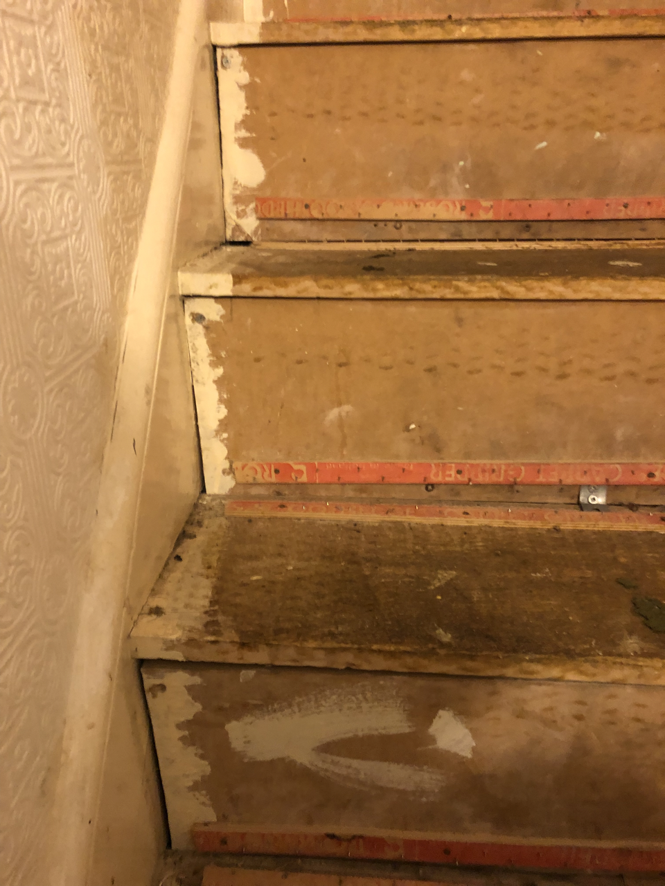

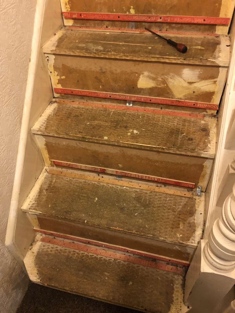

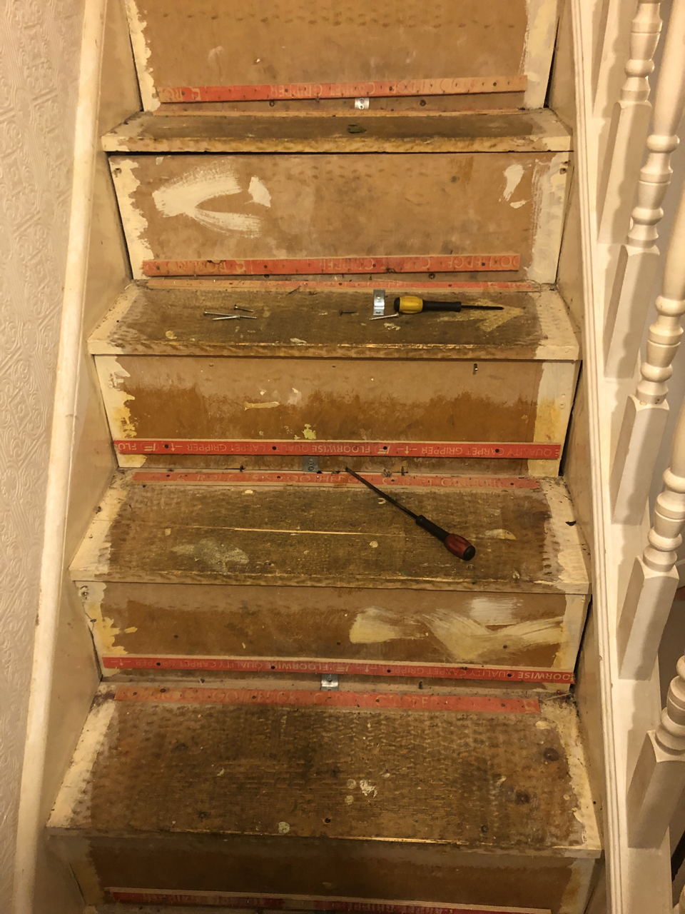

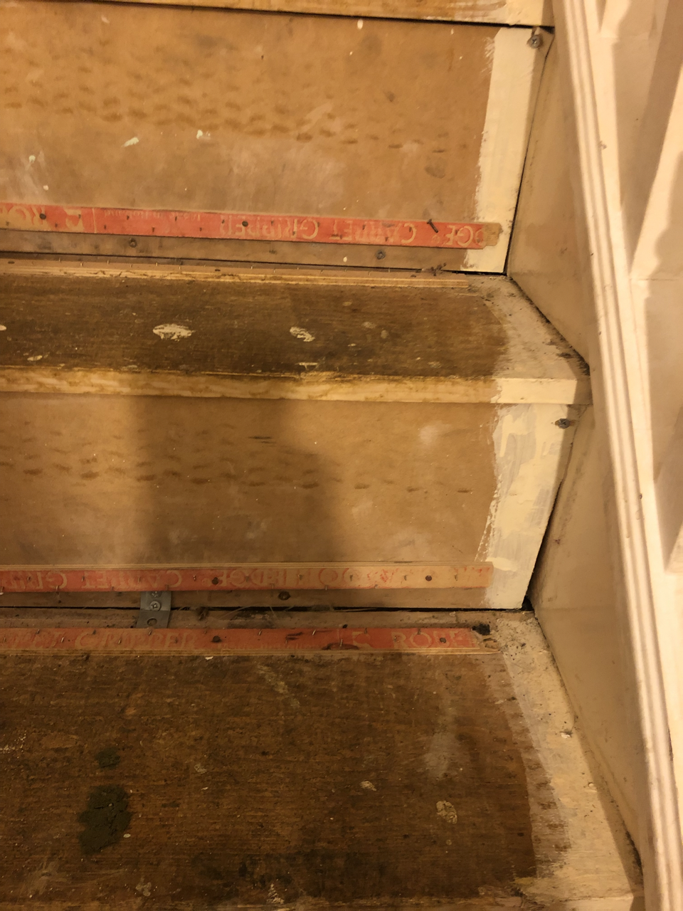

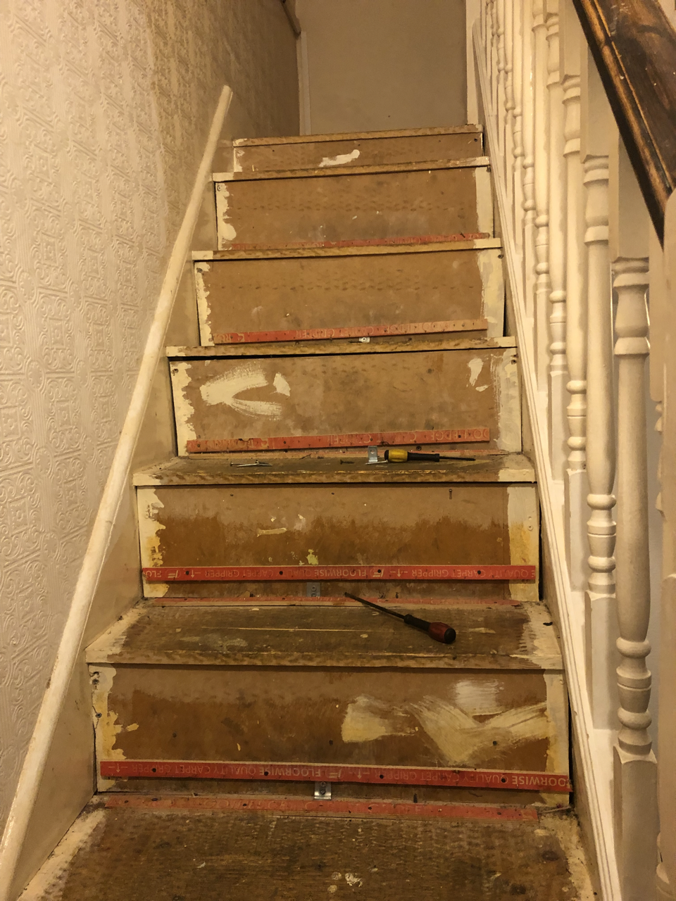

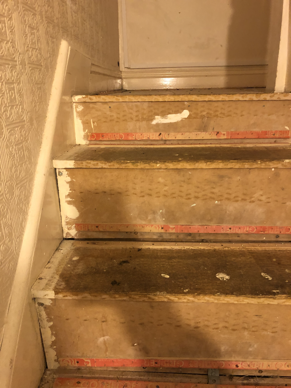

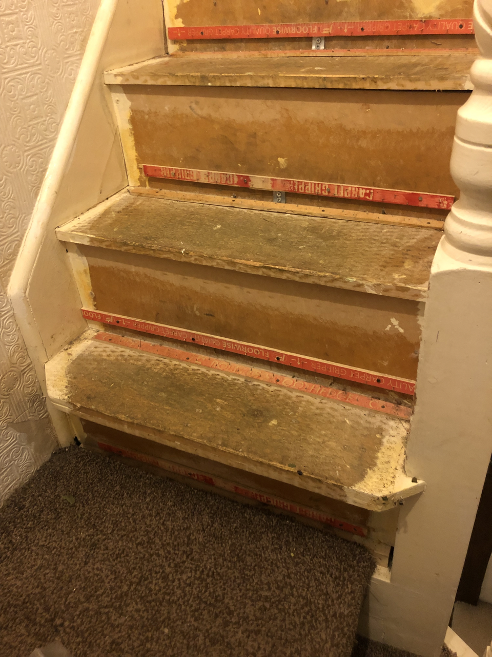

I got a house and the stairs from 1st floor to the loft are really squeaky and not very sturdy looking. There is no carpet on it yet and I wanted to fix them or make them stronger before getting the carpet

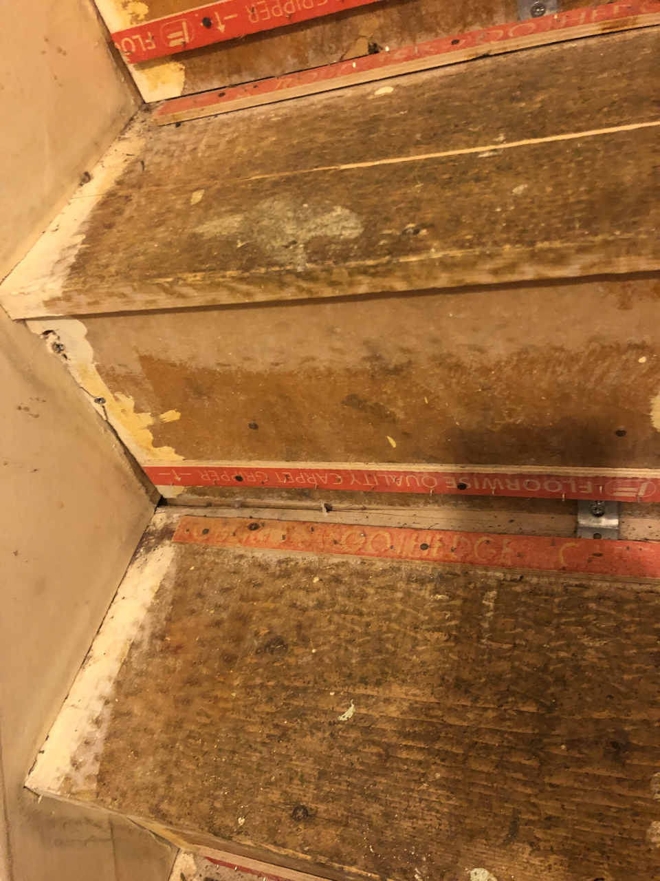

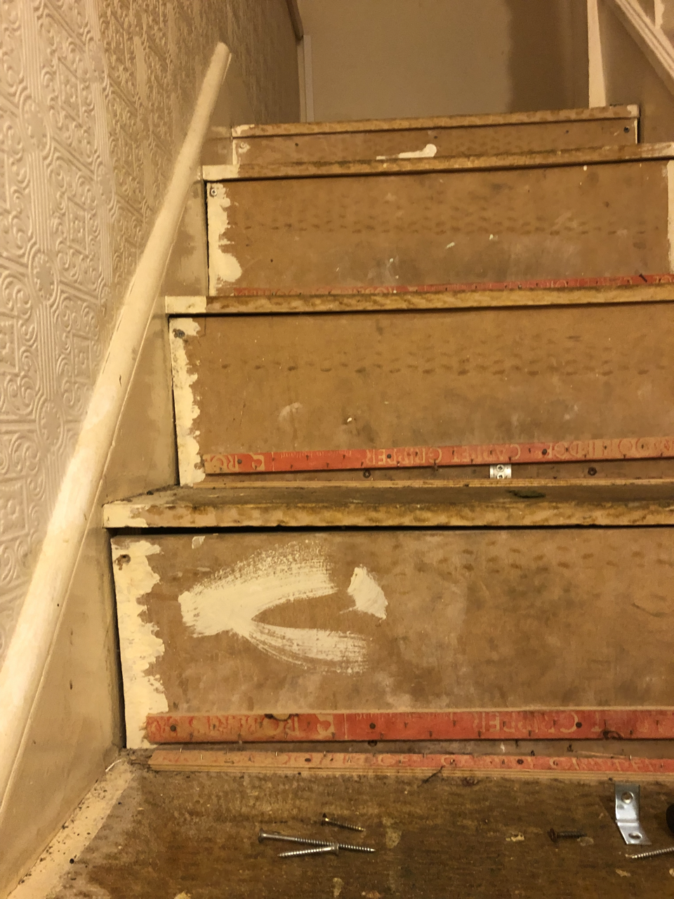

I try to open one of the vertical panels by removing the screws as I was removing I heard a wood piece drop a bit. I have attached photos and would love some ideas what to do and what are the cause of this problem. the bottom of the stairs is nice looking and I really want to see if I can fix them from the top.
One horizontal stair panel is broken as I can see the big line in the middle. Stairs are 25in wide if it helps to know
How much would it cost to get it done and can a normal person fix this himself with some time and online help? I don't even know what needs to be done to make a good stair

The risers (the verticals) haven't been Routed (slotted) into the stringers - could be the treads (the horizontals) have not been routed in either.
Is the back of the flight open so you can see from below how the treads are supported, and how the risers will have backing.
The stairs appear to be dropping slightly to the left but maybe its just the camera?
Gaps have opened up here and there.
The wood the stairs were built with is very poor quality.
24 inches wide (600mm) is narrow but allowed.
Its possible that the stairs might be re-built but it would be safer to replace them.
I notice what looks like a landing at the top.
Unfortunately, what you propose as DIY work would be doubtful with the knowledge you've revealed.

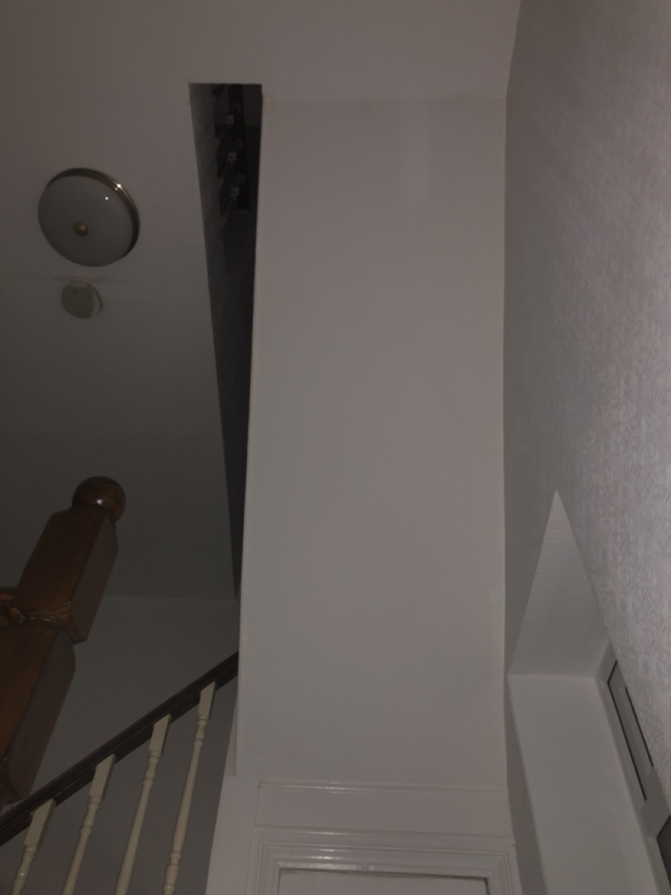

hey thanks for the information, I really wanted to try and fix them at low cost, the stairs are useable but just really squeaky, the bottom of the stairs are covered not sure if I can open this up without breaking it underneath, there is no panel per say to open, I have attached a photo. the stairs leads to the attic room which was converted before i got this place hence stairs were still without carpet

At first sight I thought that those stairs look have maybe been overclad; the risers appear to have a few nails in the front whilst the treads are square edged which is all rather odd. The gaps are not encouraging either, and the nails make it look as though the whole lot has been nailed together. I'm with tell80 - you need to remove the underdrawings to see what is beneath - and that is almost always the case if you want to do a thorough fix of squeaking stairs. At present I think it is 50/50 that you'll have to replace them

The underdrawing, is it easy to open and close, from the photo can you tell anything, Seem like its been closed off and painted
Not always easy to open. It is generally either plasterboard or sheet material (hardboard or plywood) although I have come across lath and plaster in the past as well. If it is a plasterboard or a sheet material it should be possible to cut out an inspection hole to see what is under there which can be repaired afterwards, however you need to expose the bottom of the stairs completely to fix the problem properly. TBH your stairs look a complete mess, and tell80 may well be right - it could just be a DIY nailed together bodge job, or it could be an older staircase which has been overcladed (the stringers etc might be indicative of this, although I am not hopeful).

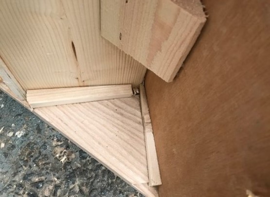

In any case, and this is a discussion I have had quite a few times in the past (about opening up the underdrawings, that is), most often squeaking is caused by loose wedges and/or missing glue blocks - which cannot be accessed from the top - with split treads being another cause. This is what should be on the underside of your stairs:
You might try drilling some holes in the treads and spraying in expanding foam from above - but if that doesn't work (and there's a good chance it won't) then a conventional repair might well be out of the question because everything will be covered in expanding foam. That's why I, personally, would never use that stuff for a "quick fix"
