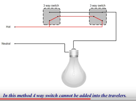

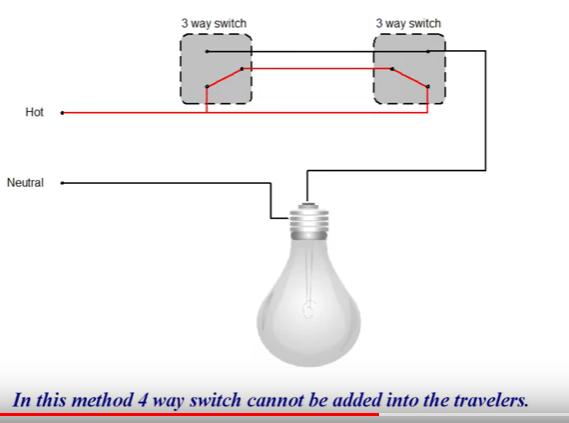

Google comes up with a fair bit but Chicago and California, both appear to be the same as our 'Conversion method' a YT describes 'California method' quite well but comes up with the point it cannot include an intermediate:
My initial thought was 'rubbish' but then I realised that pretty much all of the American descriptions show the line feed at one switch and the SL taken from the other, in which case an intermediate cannot be used. Also this sreen shot mentions 3 & 4 way switches as opposed to 2 way and intermediate. I'm really wondering what I'll be looking at now.
Why not? ...
The line feed is at both switches though.
The reason you cannot fit an intermediate is once operated you would need to operate both other switches to turn the light off

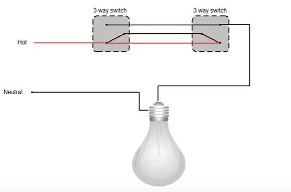

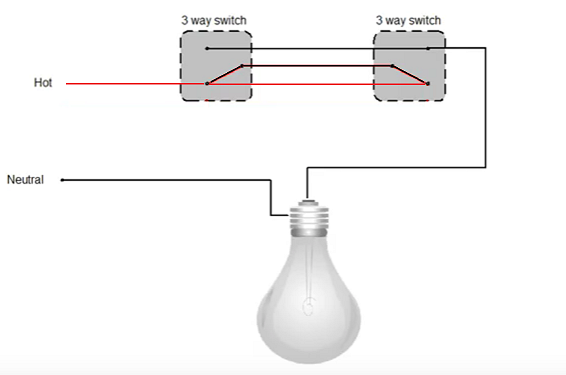

I'm struggling with the drawing with the two switches.
I have drawn it out and can't get the 2 way switches to work properly.
Which terminals are supposed to be the commons??

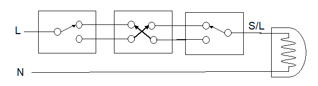

There certainly were (and in some cases still are) such potential EMF issues' in some of the 2-way and 3-way switching in my house. However, such issues can be avoided if one runs the N through all of the switches, using 3C+E cables between them.
In any event, SUNRAY seemed to be saying that if L was fed to one switch and S/L taken from the other, then it would be impossible (which I tool to mean 'literally impossible') to use an intermediate switch - and, as my diagram illustrated, that is not true.

Crazy way of doing it, think I have seen this once on a 70s 2 way conduit system, which I found confusing at first.
I suppose in some cases this way could be advantageous if you are trying to adapt some existing wiring, don't think I'll be bothering doing it this way if I can help it.
I'm struggling with the drawing with the two switches. I have drawn it out and can't get the 2 way switches to work properly. Which terminals are supposed to be the commons??
It also took me a bit of thinking but I eventually saw that it would work. As EFLI has said, the 'commons' of the switches are the ones nearest to the middle of the diagram.

Yes, I can't see any configuration being better for EMF, so I can't see any point wiring it like that.
As I've just written, so did I, initially! I certainly have not seen that done, but what I depicted in post #3 is the ('traditional'/'old-fashioned') way in which most of the 2-way and 3-way switching in my house has been done (other than bits I've added more recently).
