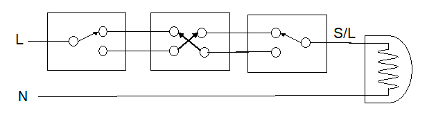

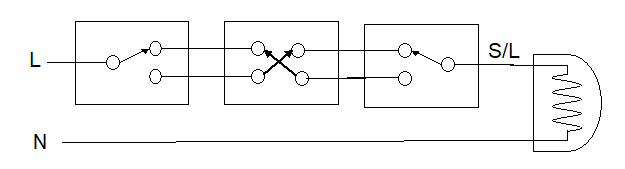

I agree it can't be done, putting a intermediate in the conventional strappers will not work as long as the sw-L is at the opposite end to the line feed.

JohnW2. I think the point is that the original wiring diagram cannot have an intermediate inserted, yet your diagram - which is significantly different, can and has.
In the original diagram, both switches have a permanent live.
Now supposing the second 2 way switch needed that permanent live to feed another light in another part of the house. If the wiring was altered to resemble something like your diagram, you would lose the permanent live that would be relied upon to serve another light somewhere else in the house.
The line feed is at both switches though.
Indeed it is but they seem to show it terminated at the opposite end to the SL termination.
The reason you cannot fit an intermediate is once operated you would need to operate both other switches to turn the light off
Indeed.
Is that not reffering to the amount of switch terminals
It seems that's the pattern, which I'd not come across before.

The 2 terminals closest together. The circuit is exactly like our 'Conversion method' except it's shown with L at one switch and SL at the other whereas our 'standard' is to have them both at the same switch.

.... pretty much all of the American descriptions show the line feed at one switch and the SL taken from the other, in which case an intermediate cannot be used.
It seems that I misunderstood his intended meaning, because I thought (and still would think) that it was a general (and incorrect) statement about situations in which there was "the line feed at one switch and the SL taken from the other", rather than anything to do with the "original wiring diagram".

In relation to the wiring method shown in the screen shot.
