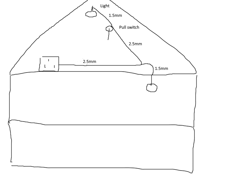

Hi all,
Been up in my loft to look at the electrical wiring for the first time since buying my property.
There is a single power socket for the TV aerial signal booster. This single socket has a 2.5mm cable going to a light switch for the loft light. Then from that light switch, there is a 1.5mm cable going to the ceiling light on the upstairs ceiling light.
Question: Is this a bit 'dodgy' cabling method by the previous owner??
Okay. Nothing wrong with that. Can you see whats feeding it?
Nothing wrong with that too. Assuming it's a LED light.
You mean it's feeding the upstairs light too?
Here's my quick & awesome drawing. ;)
All fed from the upstairs ceiling light
Sounds fine, even though some pedants don‘t like sockets on lighting circuits. If it’s a new-ish install the socket should be RCD protected but so should the lights.
If the cable is coming from a light fitting, then the socket would be limited to the circuit breaker protecting the lighting circuit, which would normally be 6A or 10A
Use the loft socket for low loads only is my advice
Yes, that's my thoughts too.
