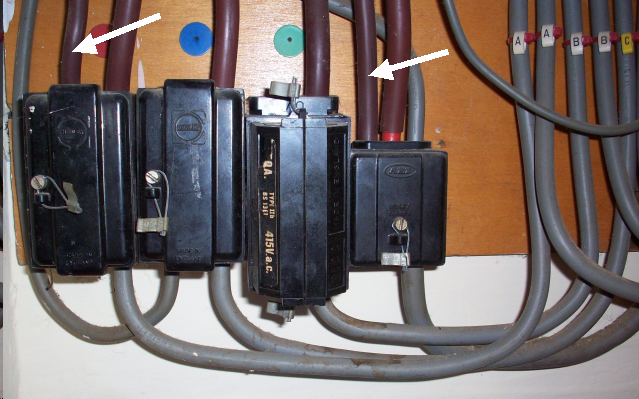

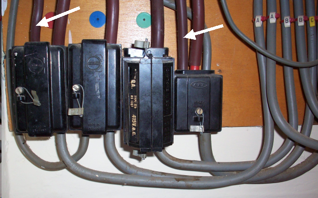

2 cut-out fuses

All OP needs to know at this stage is there is a 1ph supply and to establish the earthing arrangement.
Indeed. Although there is no PME sticker to be seen, the earth appears to be coming pfrom somewhere close to the outgoing neutral, so it seems quite likely that it is TN-C-S, doesn't it?

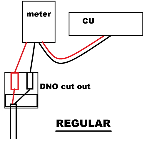

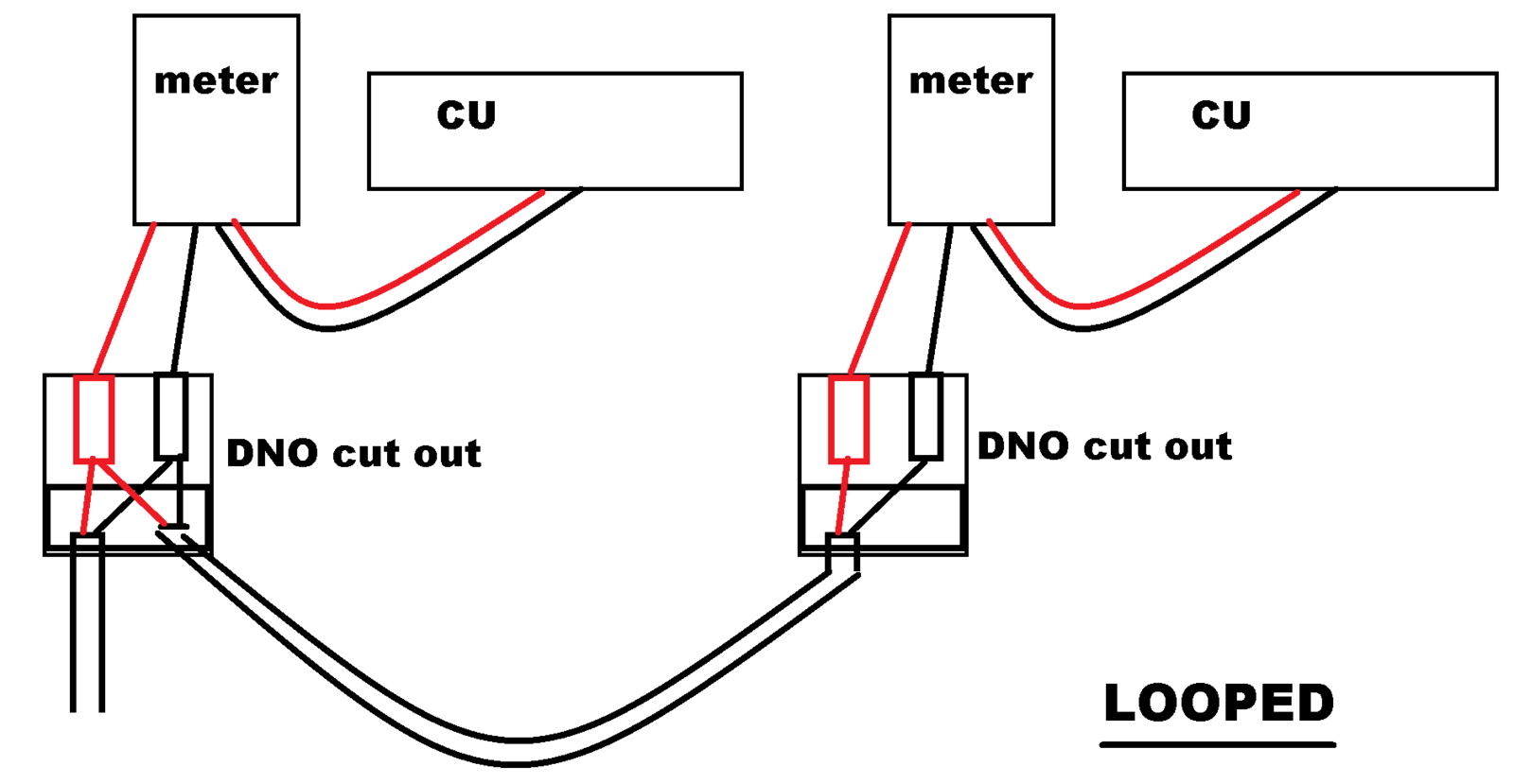

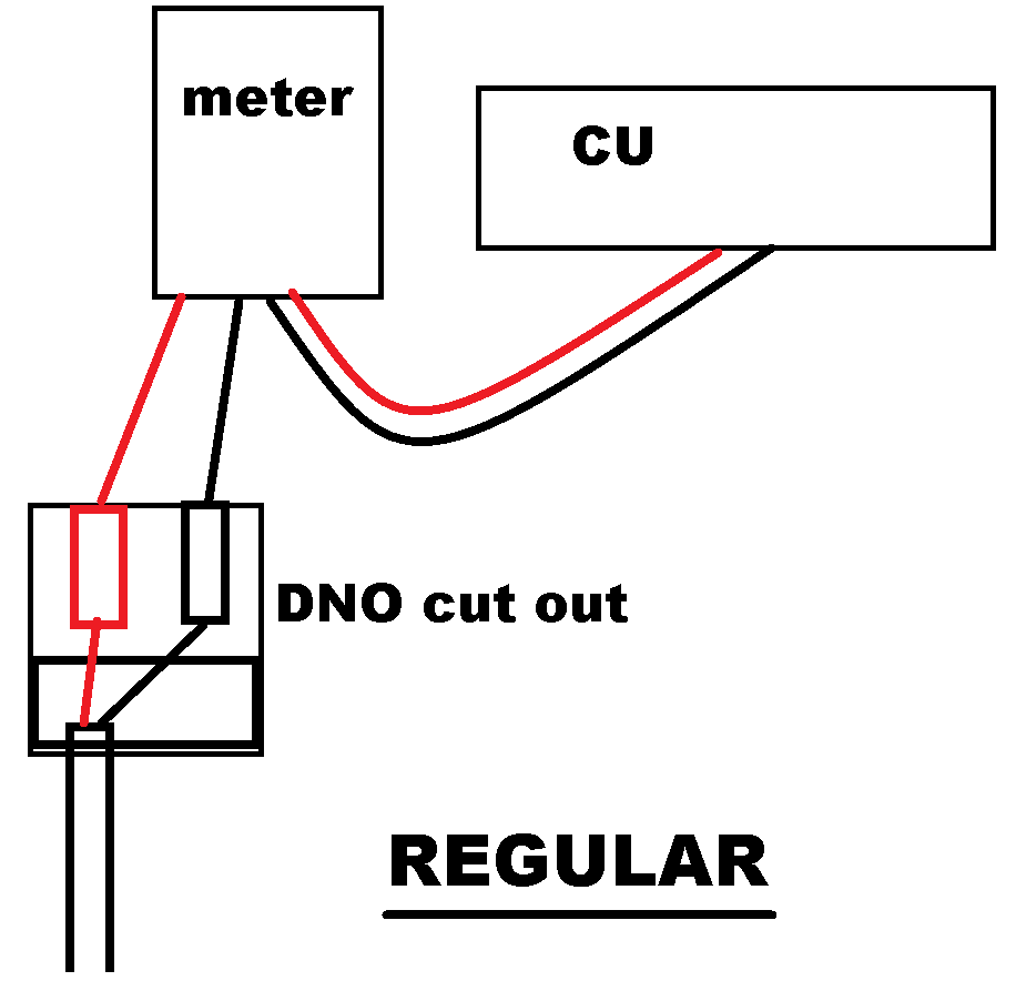

If the feed to next door is directly off the incoming feed with no intermediate fuse or means of isolation then absolutely looped supply. I assume the brown wires come directly from the overhead lines and then direcly to the neighbour.
If I'm honest I'm not keen on the term 'looped' but I can't think of a more appropriate term.

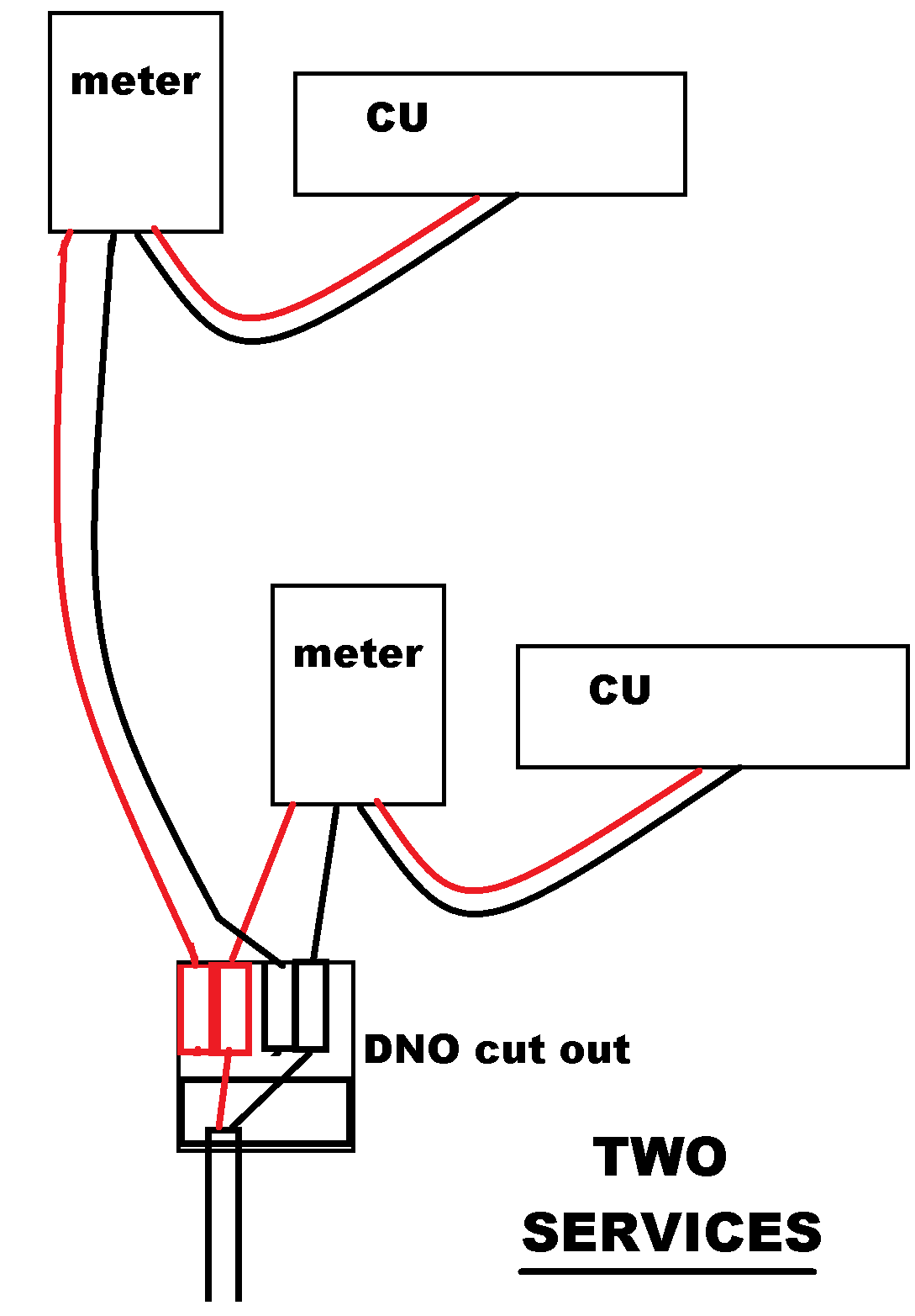

I think the first 3 sketches are fairly straightforward.

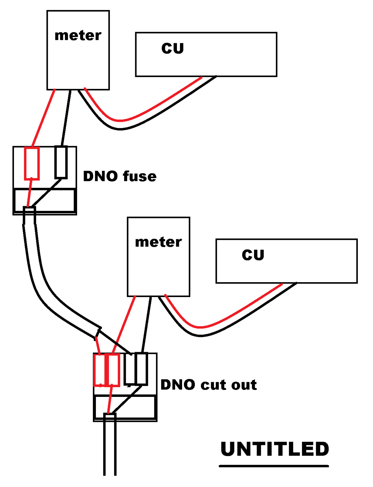

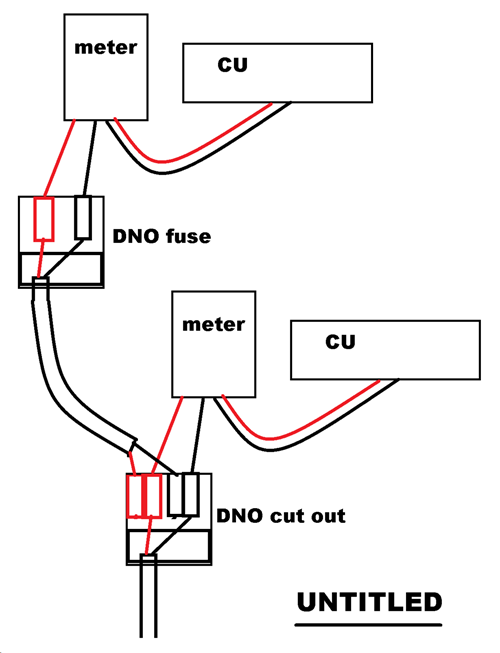

4th is so close to 3rd that I'd not use the term 'looped', however if 'looped' is the acceptable term for a service supplied this way then so be it.
Apologies for the large format, I tried to shrink it but it pixilated.
I and 2 are certainly very straightforward, representing the two common situations.
#3 is also straightforward but (at least in my experience) very uncommon - but, as I've been saying from early on (and as the OP now seems to agree), seems to be the most likely historical explanation for the OP's second fuse holder (the feed from it to 'somewhere else' having since disappeared).
As I've said before, your #3 ("Two Services") only really differs from #2 ("Looped") as regards whether the fuse for 'House 2' is in 'House 1' or 'House 2' - which is why I think many people would probably also call #3 "looped"..
I suppose we should remember that, although it doesn't look like a "4-pole" cutout, we're not absolutely certain that the two fuse holders are connected to the same phase.
I'm not totally sure what you were trying to illustrate here. If it is meant to represent the situation of my hypothetical scenario (with solid link in the neutral fuse holder), it's not very clear, since it is not apparent from your diagram that (unlike all the other 'red rectangles') the left hand of the two red rectangles in the "DNO cutout" is a solid link, rather than a fuse. I was not suggesting that such was something one would be likely to see in practice, but was illustrating how close it was to other arrangements.
In my experience 'Two Services' is extrememly common, in 70's it was very common to build terraces/semi's with a shed adjacent to the front door which contained the services, the gas, water and electric supplies often came up in one and then teed to the neighbour with the leccy coming from a second fuse in the head. Multi occupancy buildings [conversions] often have several whole installations in one space with only one head[RF Lighting has posted several pictures]. I assisted with a fusebox change very recently which has a 3ph supply and Henley blocks before the meters feeding 7 flats. I see no reason to call this 'looped'
Ultimately all the power comes from the same place so we could class everything as looped despite the fact that the vast majority is fed like a backbone.
Kind Regards, John
I don't believe it makes any difference if it's a link or fuse, the format would be identical.
