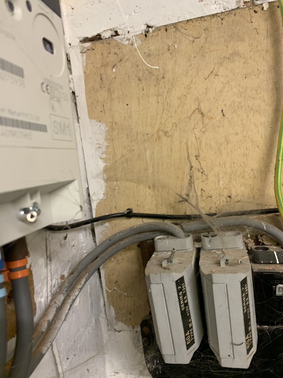

Hi all
I’m looking to do a rewire as part of a building regs plans I am submitting with other works and started to take a look at the income. It seems I have 2 fuses on the head, is this normal? If I’m correct this is a TN-C-S supply.
Plan is the fit a board with RCBO’s, I have planned approx 18 circuits but may look to see if I ca reduce this (not looking forward to the cost of it).
One fuse could go thru wall to next door?
That's certainly possible. A photo showing the top of the fuse holders might help since, from what we've seen so far, I'm not convinced that both are necessarily connected to anything.
If there are cables coming out of the tops of both fuse holders, then the OP will hopefully be able to see something about where they go. One presumably goes to his meter, so it's the other one that we would presumably be interested in.

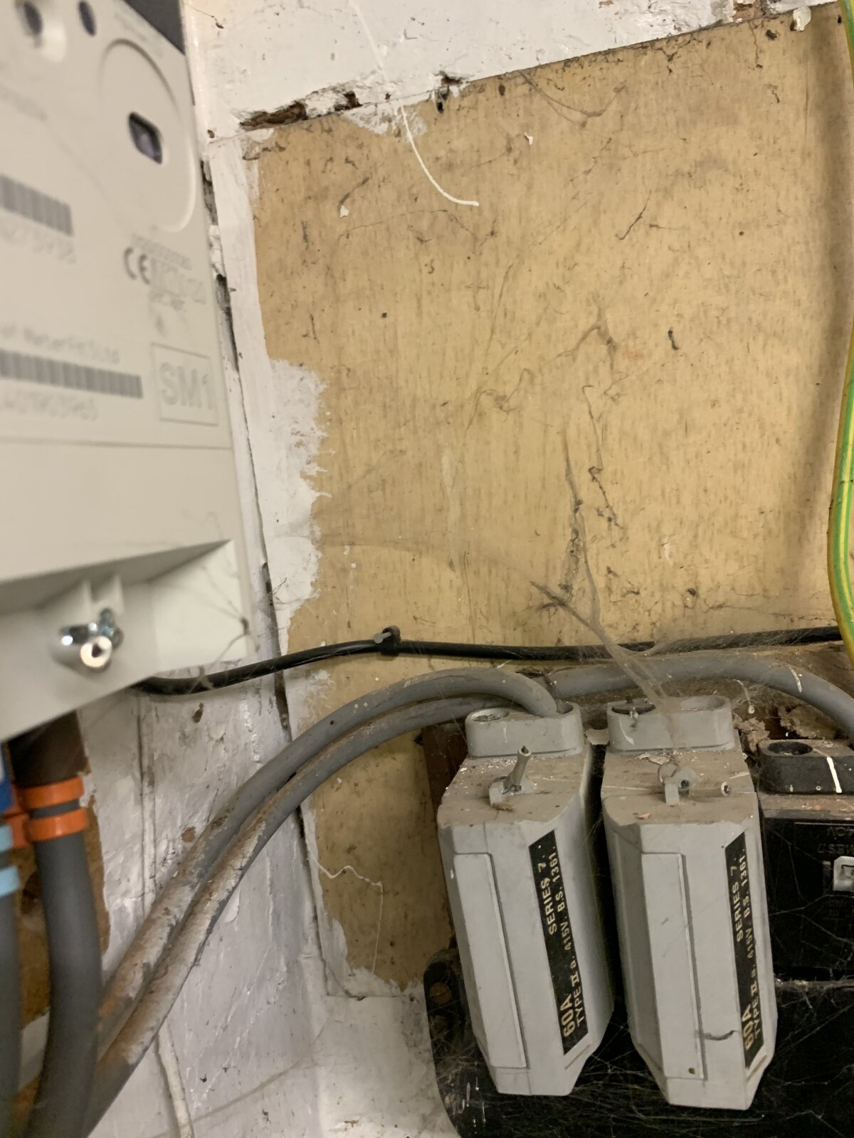

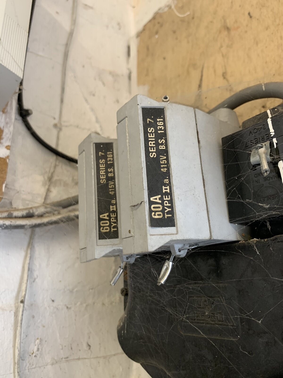

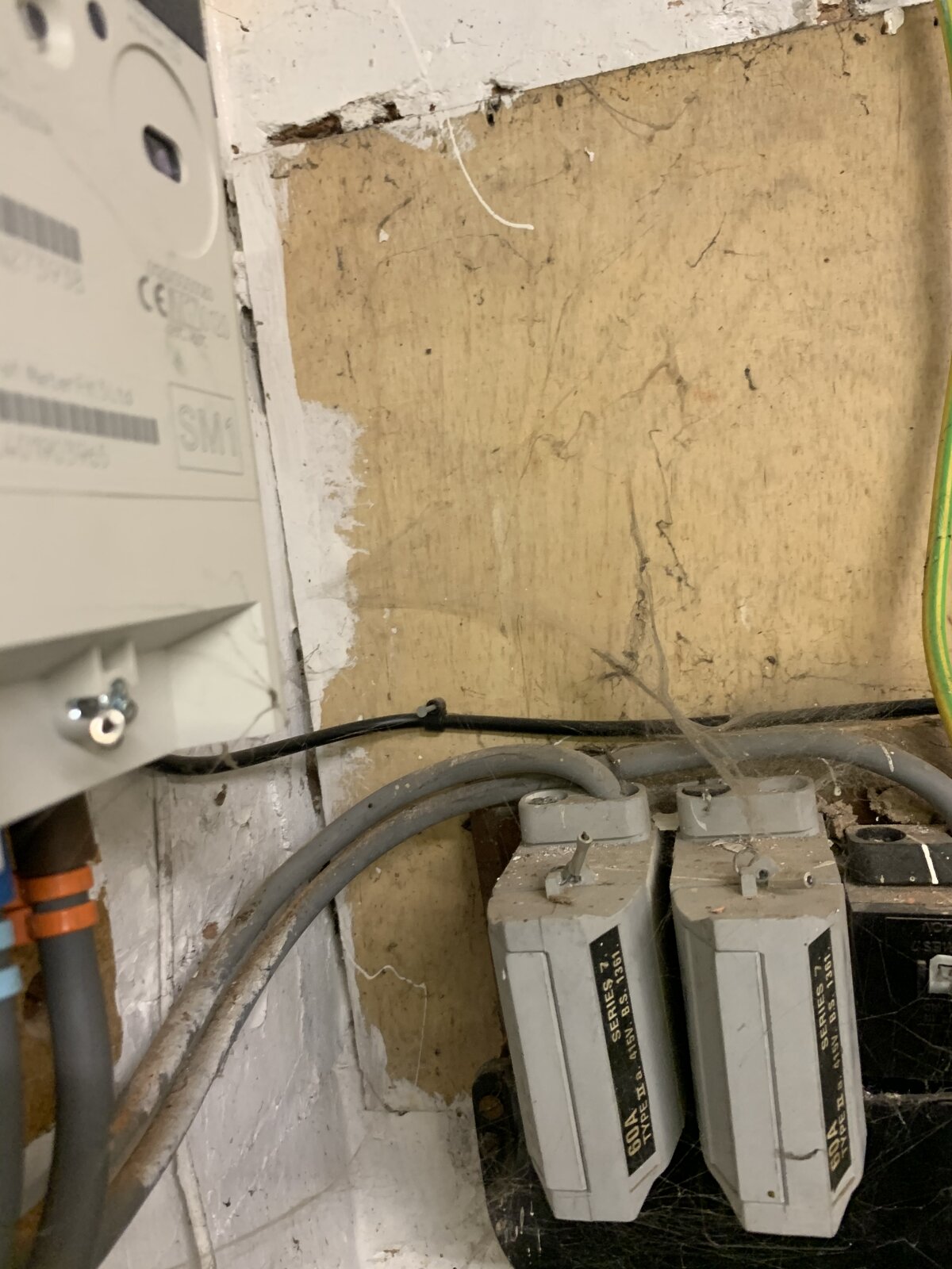

... A photo showing the top of the fuse holders might help since, from what we've seen so far, I'm not convinced that both are necessarily connected to anything.
defo not for next door, and there’s no cable coming out of it, pic attached.
As you (and your photo) have confirmed, my suspicion that both of those fuses are not being used was correct.
Whatever it was once used for (maybe next door, maybe something else within your house), the right-hand fuse is now not being used, so the fuse holder could presumably be removed (at a price). However, I'm not really sure what, if anything, that would achieve.
Kind Regards, John
Probably used to be a looped supply to next door. Or even, looking at the age of the cutout, an old dc supply, that has been converted to Ac, and at some point new fuse holders fitted
Or it could be that cut out was what the installer happened to have on the van, and so that's what got used.
That cutout was surely installed many decades ago and, in any event, the fuse holders are separate from the cutout (as well as looker much newer), so that there would have been no reason two install two if only one were required at the time?
Kind Regards, John
Kind Regards, John
Ah, I just assumed it was one unit with two fuses.
