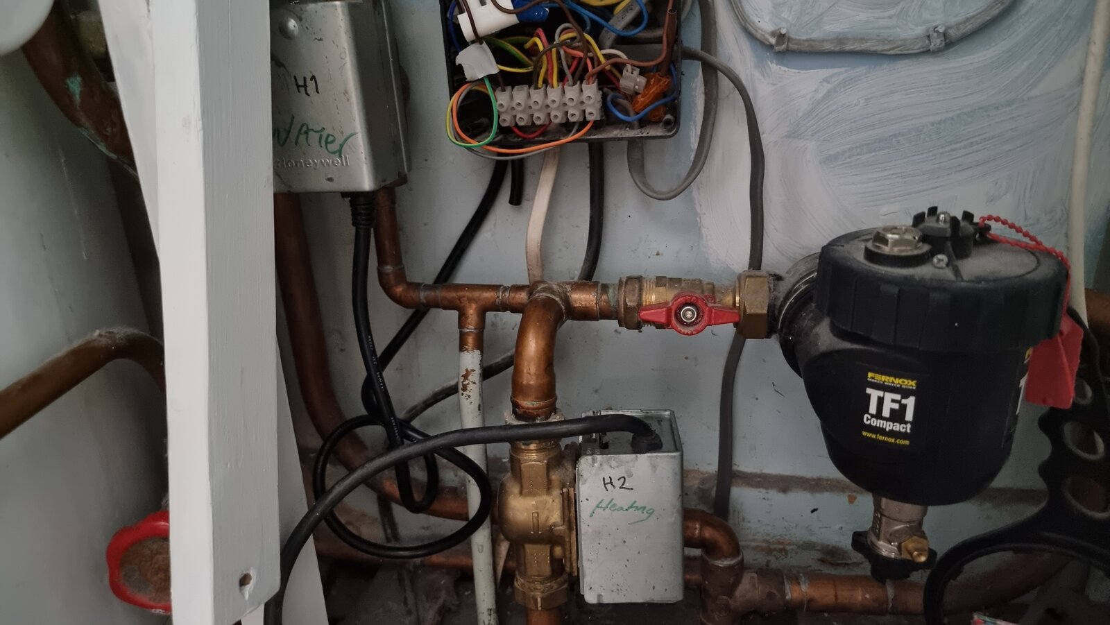

Attaching here a picture of the valves near the cylinder. I can see at least 2 tees here, does that help?
Not easy to tell from the photo, but if to the bottom right, the tee into the cylinder return pipe is from the upstairs rads, it looks dodgy. Needs a bit of detective work!

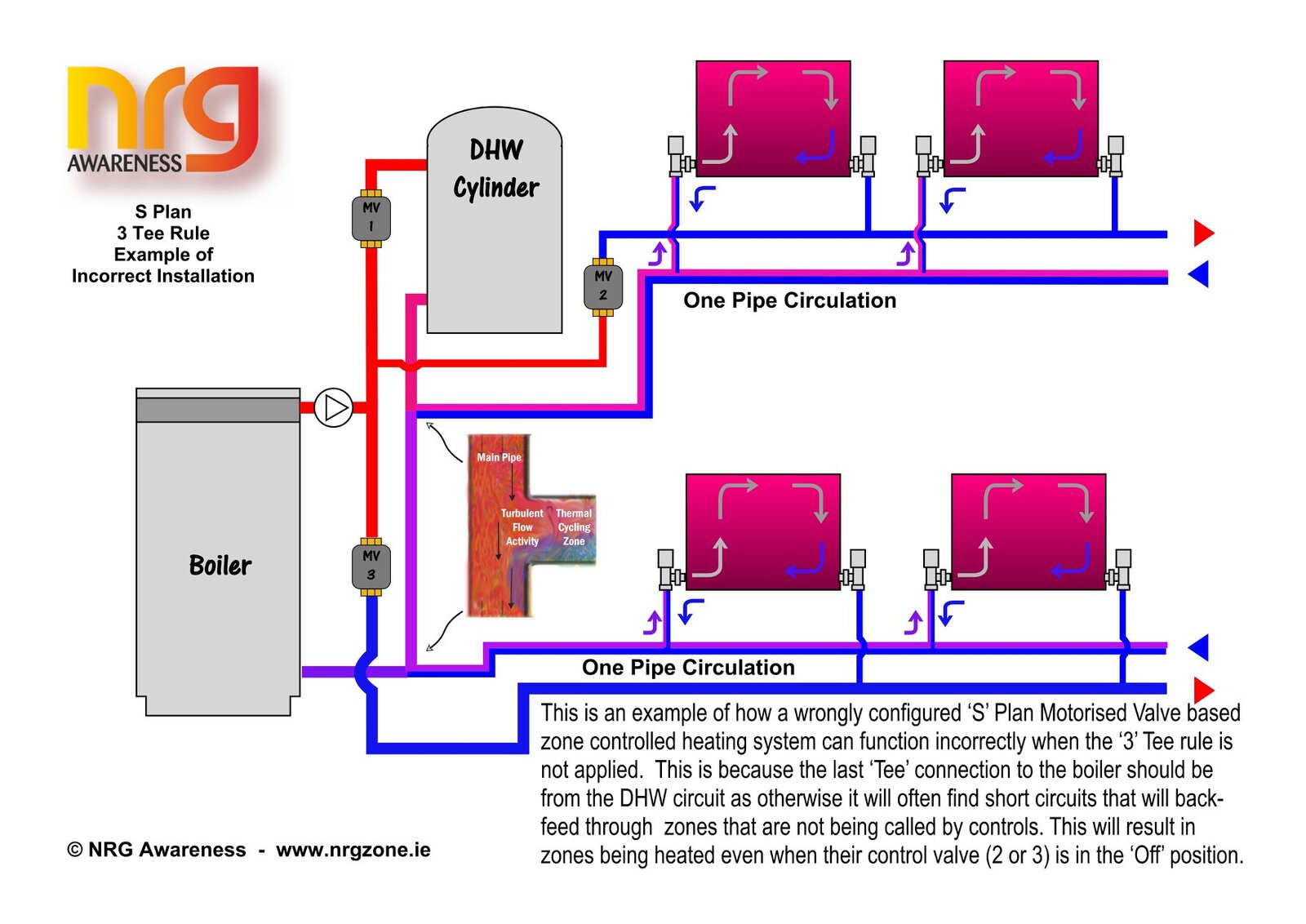

Did the passing valve test come up with anything?
This may explain your problem if only occuring with DHW on.
