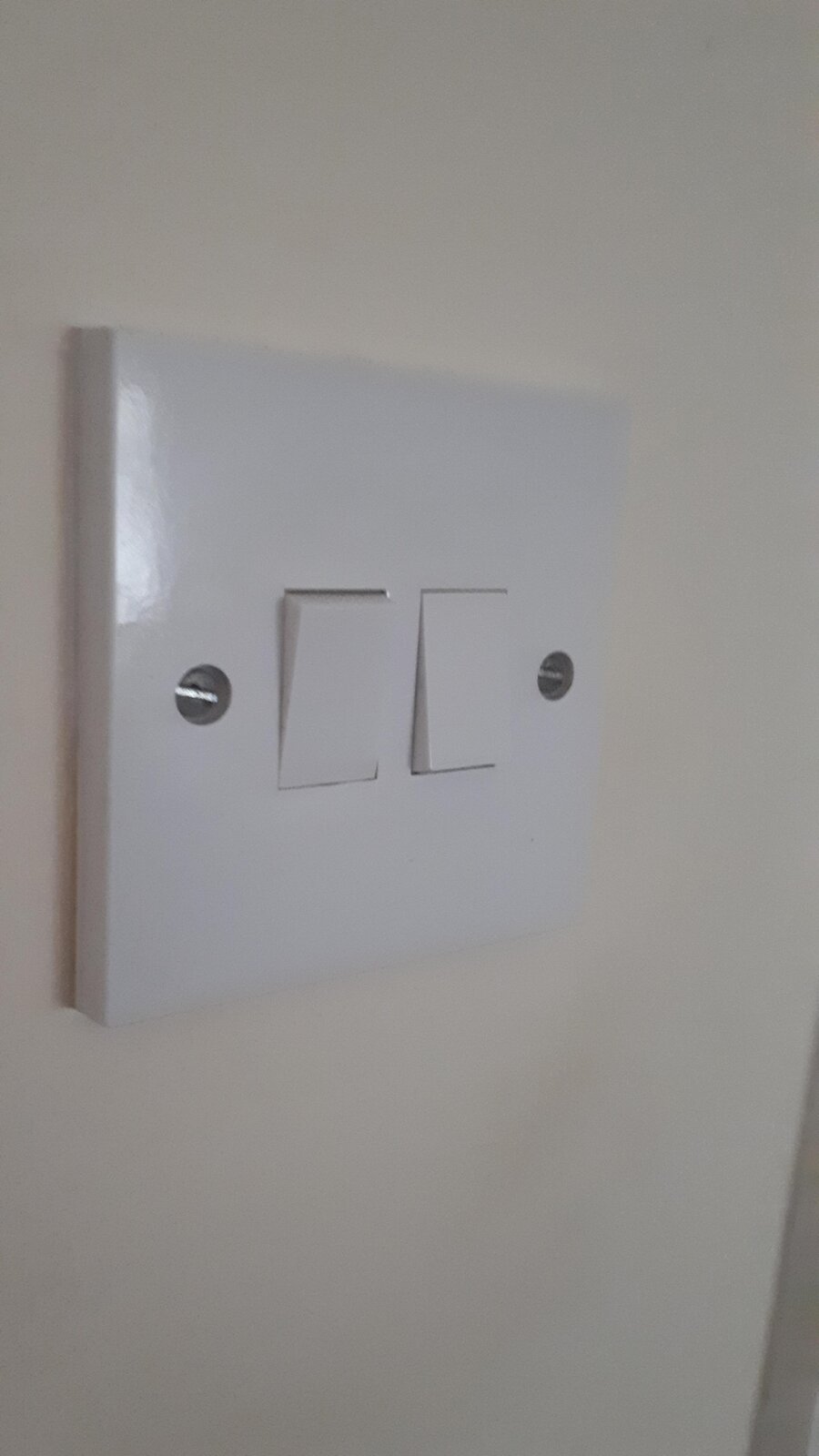

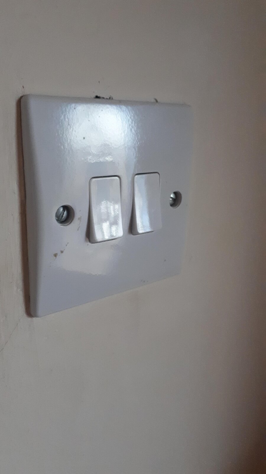

I have the usual hall and landing lights controlled by two 2 gang 2 way switches upstairs and downstairs. For some reason one switch has the individual controls in opposing directions, when the other switch has them in the same direction. Can I easily change one switch so they both point the same way as well?

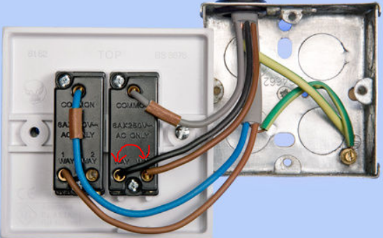

If you want to alter the situation, then swap these two wires at one of the switches.
Be aware that one of the two switches might be inverted and the colours might not match.
I'm referring to existing wiring rather than something yet to be fitted which is obviously more restrictive. Hopefully you can see the pictures I've attached. switch1 is downstairs, switch2 is upstairs. It doesn't matter which way they point as turning the light on upstairs then turning it off downstairs will change the orientation. My issue is the upstairs switches point in different directions, one up and one down, whereas downstairs they both point in the same direction. Obviously I could reverse the situation but what I want is for both switches to have both controls in the same direction like switch1. Does that make more sense?
I wondered if I could just take the wiring out for one switch, flick it the other way then rewire it the same rather than swapping wires around?

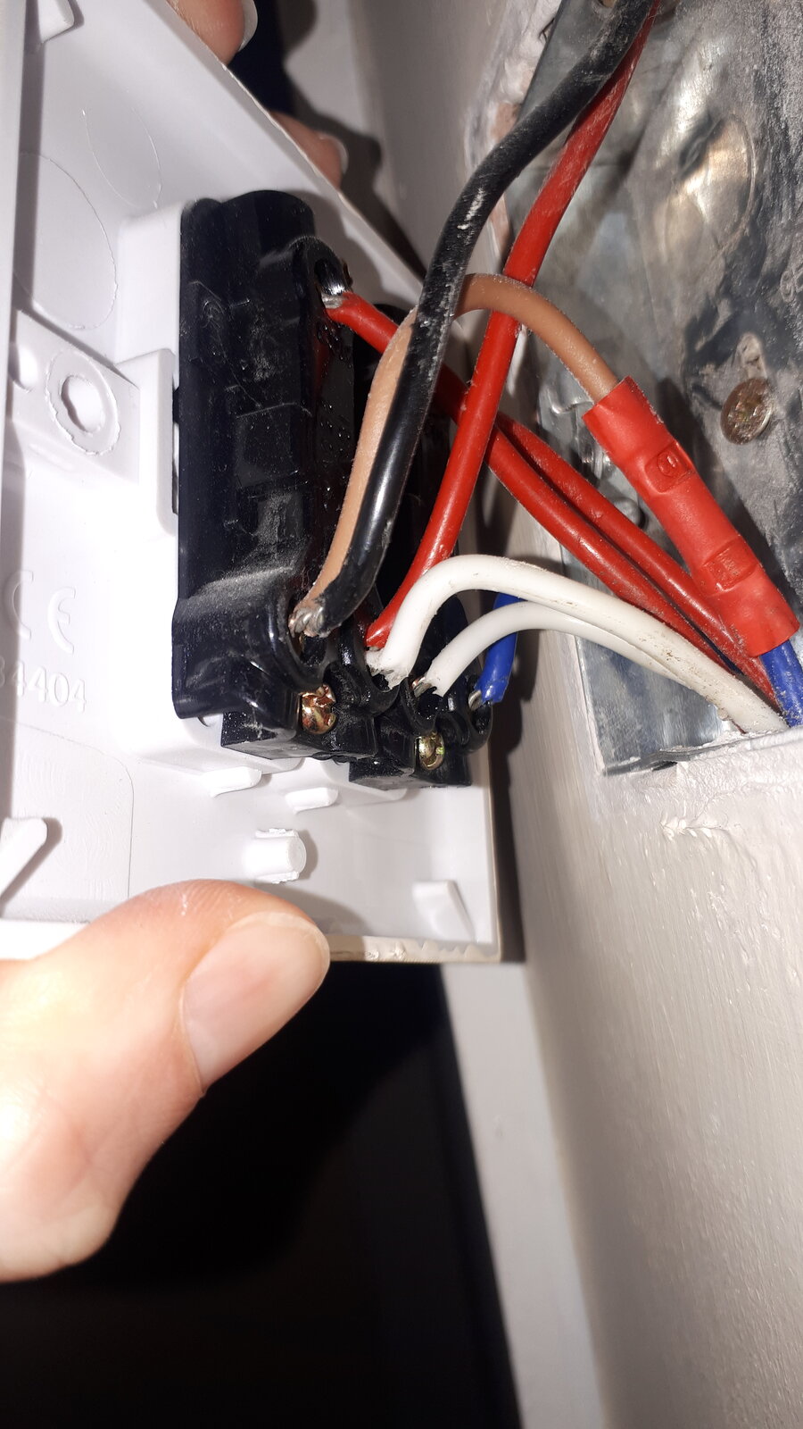

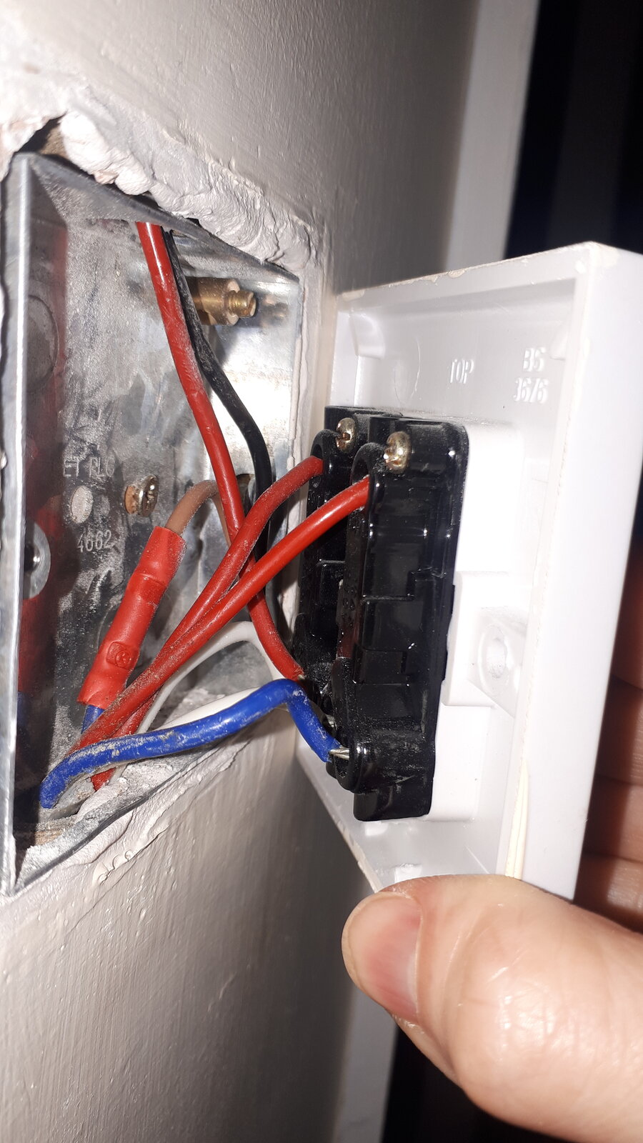

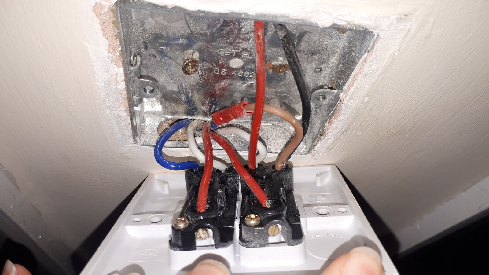

I'm sure you have more interesting things to think about but I've attached some pics. Lots of red wires!
Thanks again.

Ah lovely 3/0.029 in good old patriotic colours.
